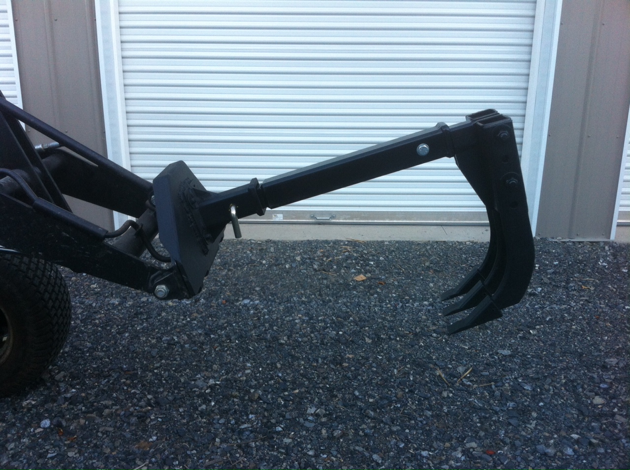

Made a claw for the PT425 today from parts.
Will try it out in the next few days.
Looks nice............:thumbsup:
/ Claw
Terracing some clay/stone slopes for gardens. Leveling out some trails.
Using the claw to break things up so I can then use the scoop to move it.
At least that is the plan. Claw cost me about 50 bucks but I had some parts sitting around.
Hope it works. I am sure I will have a big learning curve.
Wish me luck.

Very cool video. Luckily, I have a mini-hoe, but I am still learning how to use it.
I think I will like the claw because it was cheap and will be easy to repair when I break it.
I built it with a shear pin just for that reason.
Also want to use it to rip out some Multiflora-Rose that seems to come in more every year.

It looks like it would be nice for tearing out roots. Maybe a little too large for that, though?
I will also have a single hook one few days - that could be better for roots.
As is, it cuts hard packed ground and clay very well. Digs out the hills. Cuts the center hump out of the road. Rips out bushes and small trees - 3” or less.
It does not like bedrock. But takes out other stones so far. Biggest so far is basket ball size. Beyond that and the PT struggles.
