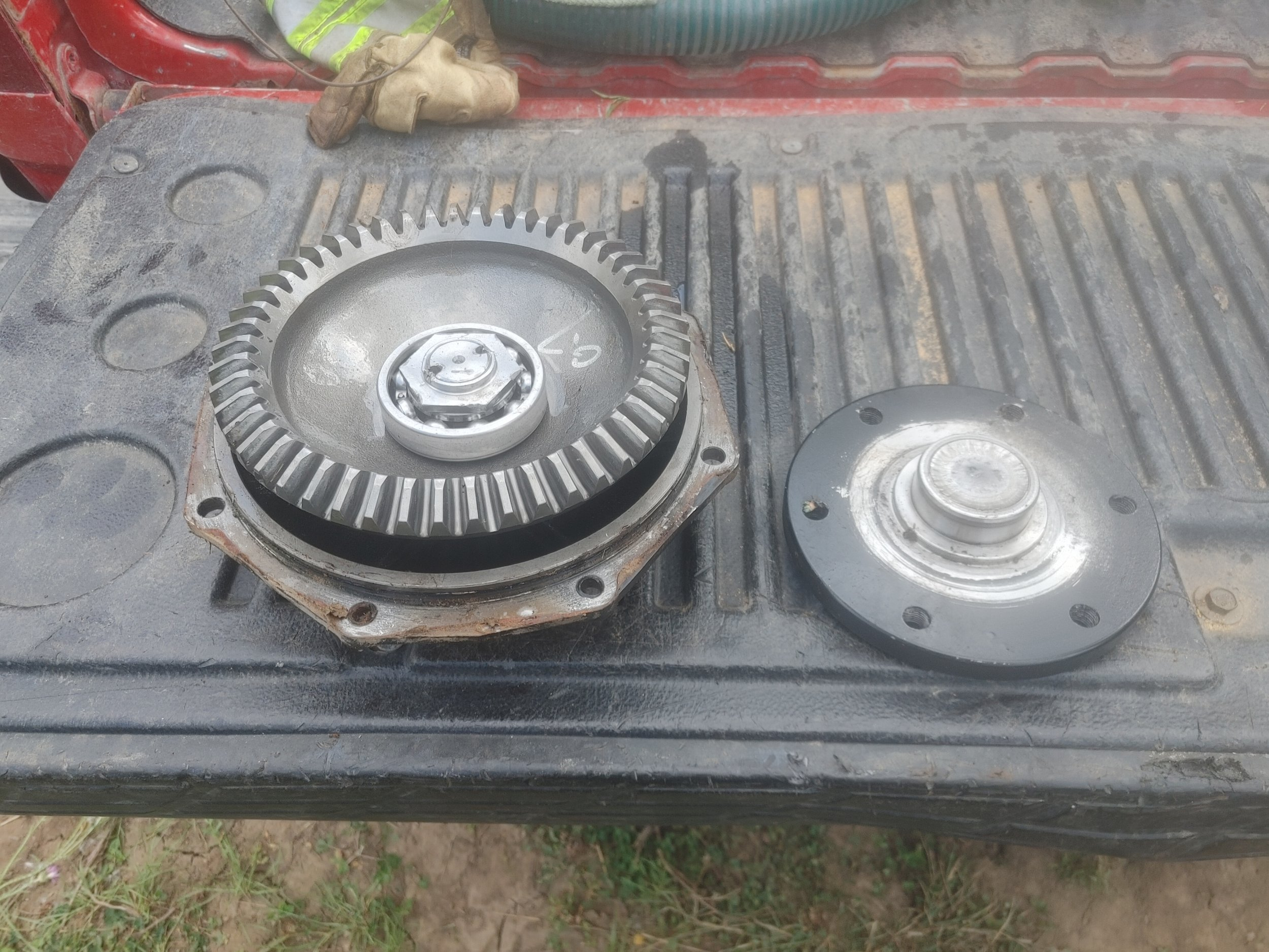

Some of this "seems" to be different problems.
1st, the TYM the Op bought has both front wheels locked together, at least that's what I thought I read.
That reeks of a 3rd member (center differential ) problem maybe side gears shimmed to tight, a damaged cross shaft , but in the center front axle diff.
The front wheel falling off, circlip individual that was severely harmed by losing the front wheel is definitely in the outer hub.
Sounds like the circlip popped out of the land , released the entire stub axle and wheel.
I went back and looked at the parts diagram that I linked for the TYM and was surprised how different that outer hub design is from Branson's.
Branson's outer hubs are mounted in double shear like larger tractors. More support stronger design PLUS,
Branson secures the outer stub axle with a large nut screwed on and staked to the stub axle. Which positively retains it.
TYM from the diagram a single snap ring / circlip. Either way the front wheels being locked together is in the center pumpkin 3rd member not the outer hub.
Not a fan of either design TYM chose. Hope they don't "improve" the Branson designs by eliminating them.
That said there was a thread on TBN of a Branson that a stub axle broke losing the wheel but was an isolated incident . But the pics posted showed the staked nut retention and double shear mounting of hub linked pic.
