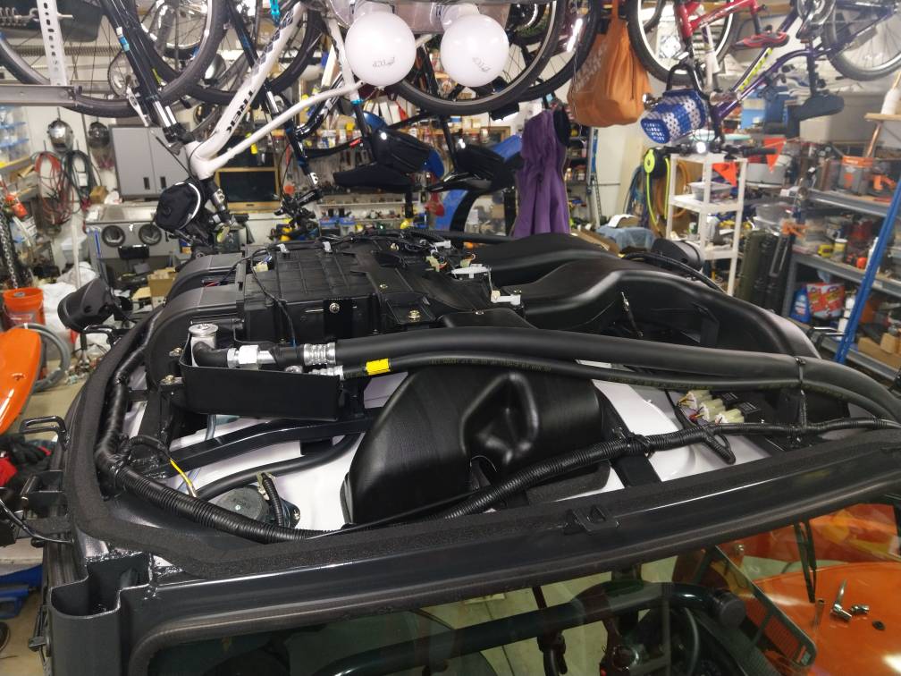

So it is actually 6 bolts from the top, 6 nuts from the bottom and you need to pull the grip end off the lever for fresh air/ cabin air selector. Im taking pictures and can post once done.

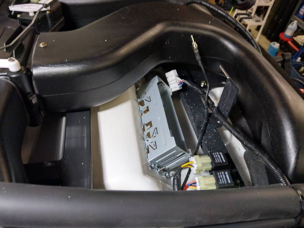

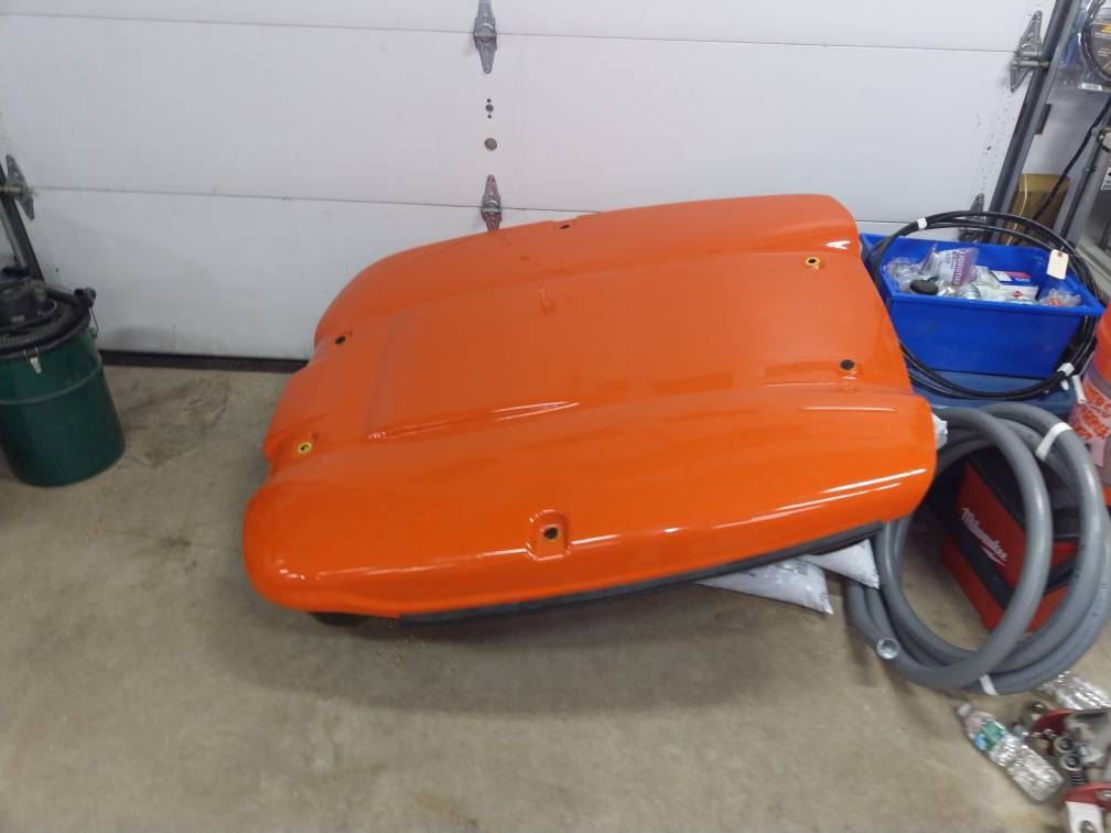

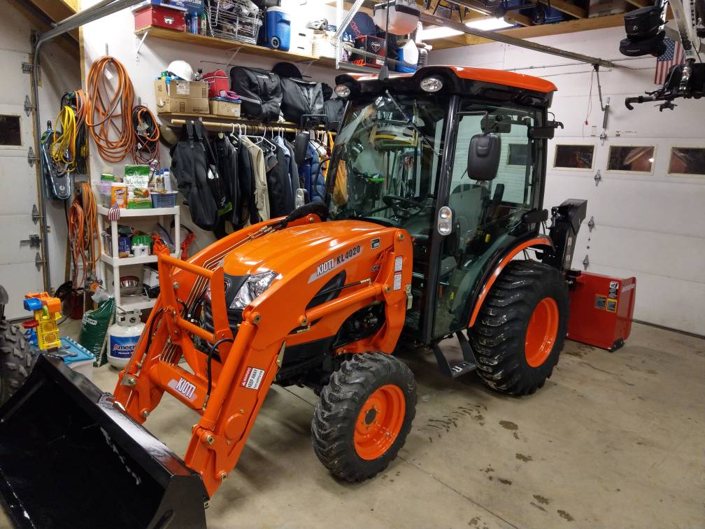

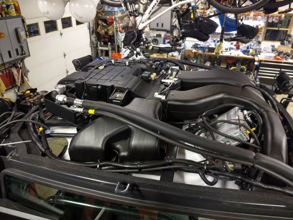

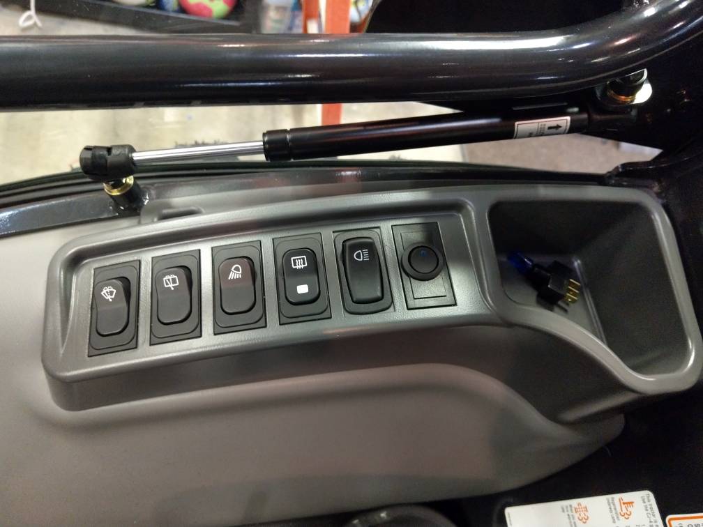

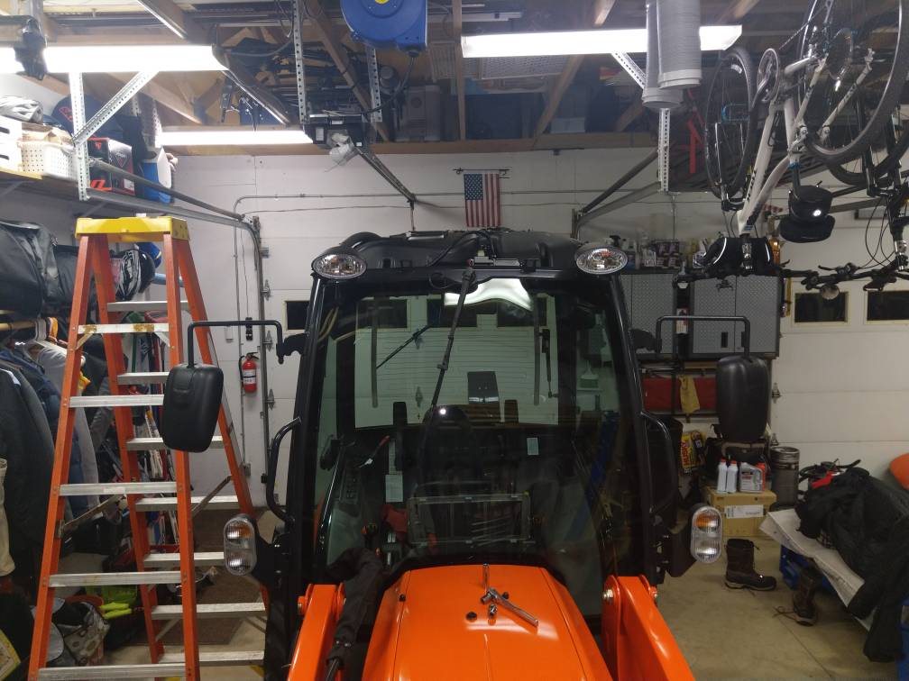

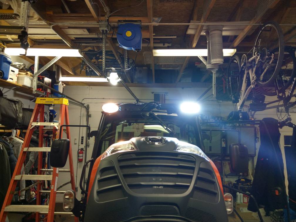

I was able to remove the roof, install the radio, swap rear work lights for new leds and install a new relay and wiring to separate the front and rear work lights on their own switches. I also installed a switch to enable the rear view camera that works with the newly installed head unit. Im taking pictures of every step and will post once completed. I still need to swap the front work lights and install the rear camera. Here are a couple pics from before the work. IMAG1255.jpgIMAG1253.jpg

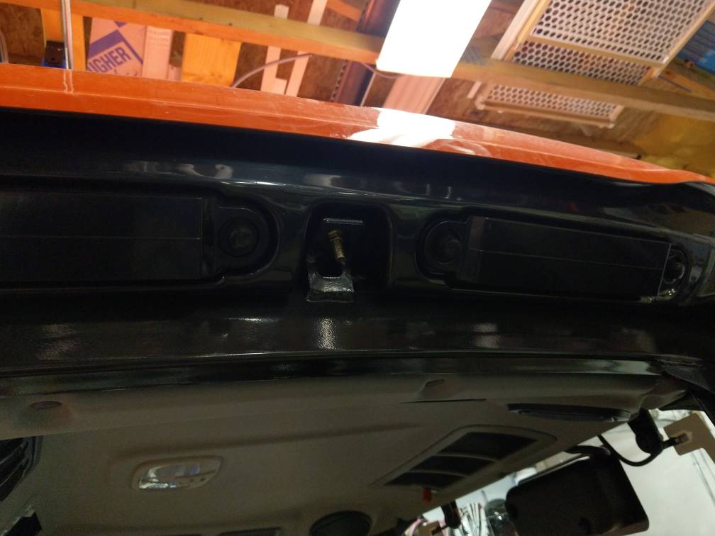

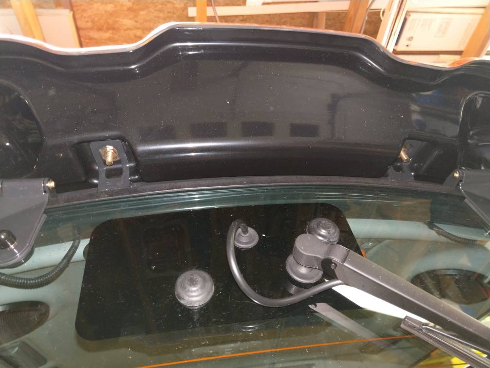

Here are a few pics showing the bolt locations. 6 bolts on top and 6 nuts from below. IMAG1276.jpgIMAG1275.jpgIMAG1277.jpgIMAG1278.jpgIMAG1285.jpgIMAG1280.jpg
/ Ck4010SE Roof Access #8
On my no the six on top don’t have to come off to remove the top, they hold the two piece shell together.
#9
You are correct. I took them out first. You only need to do the 6 lower nuts.

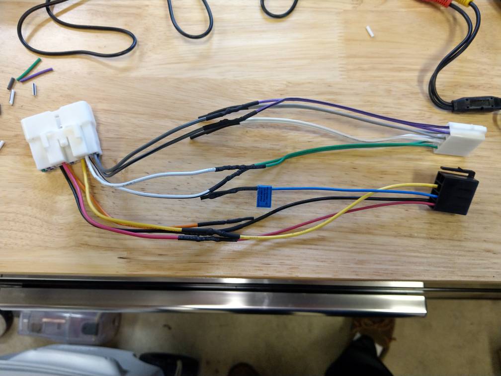

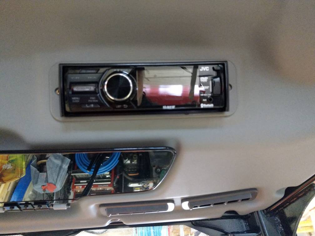

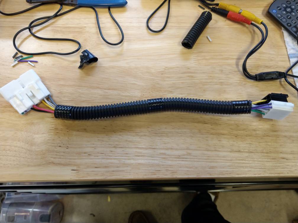

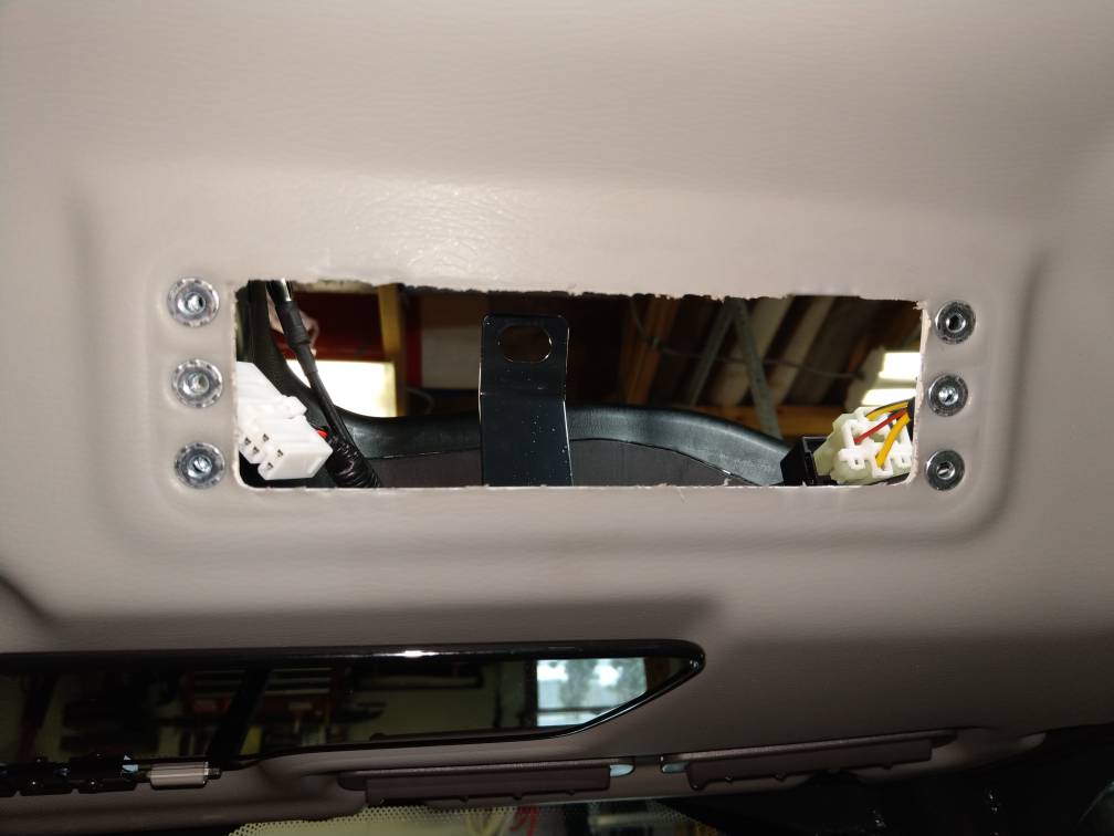

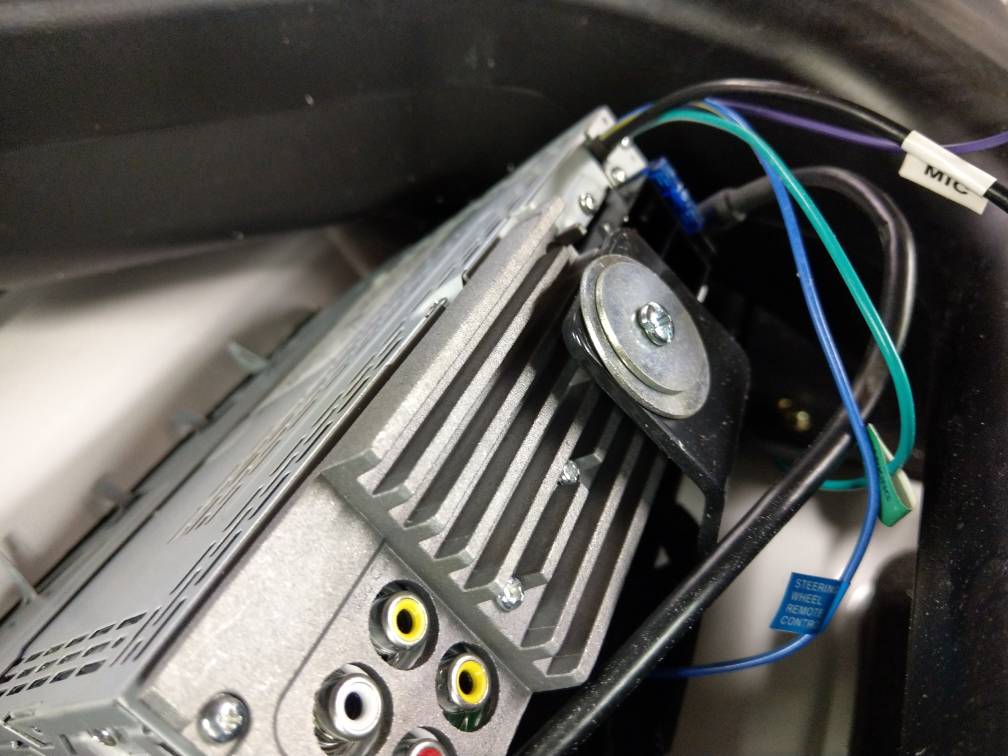

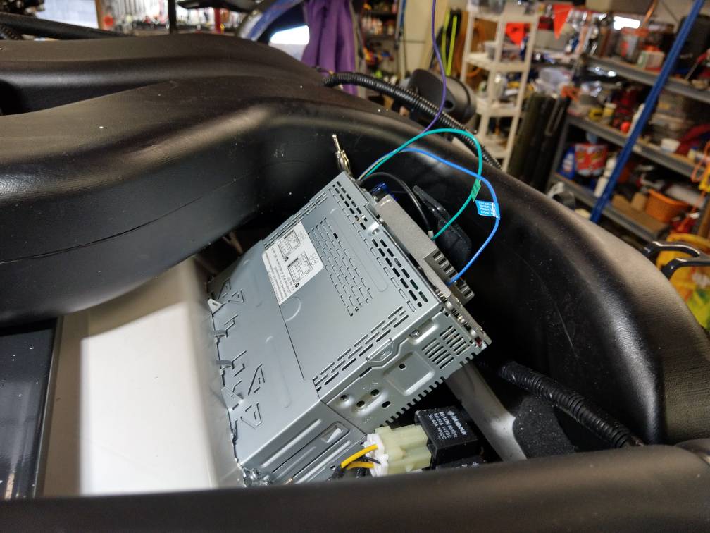

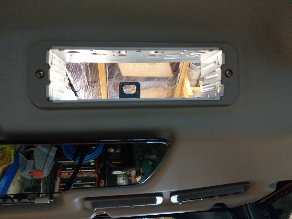

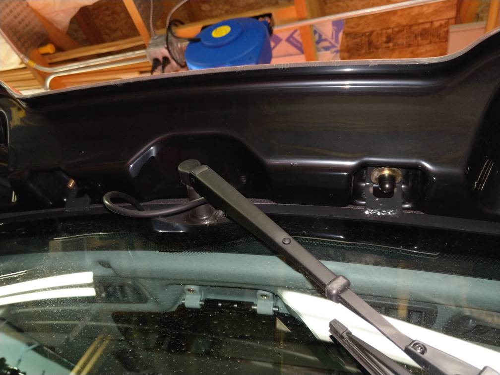

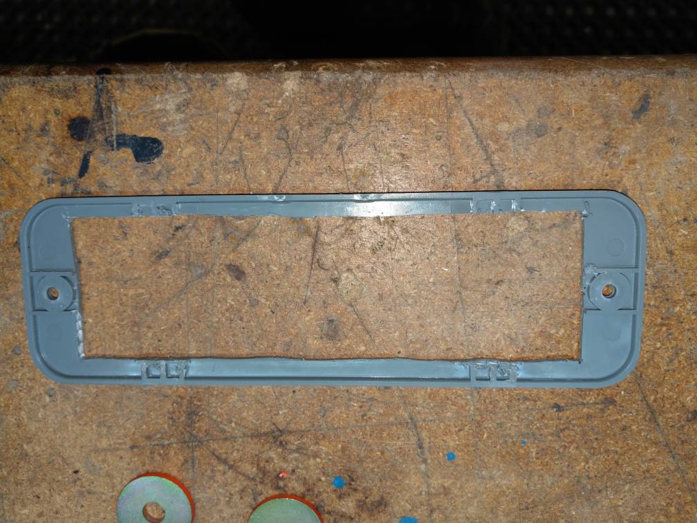

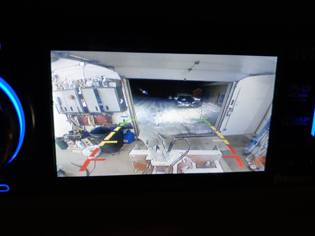

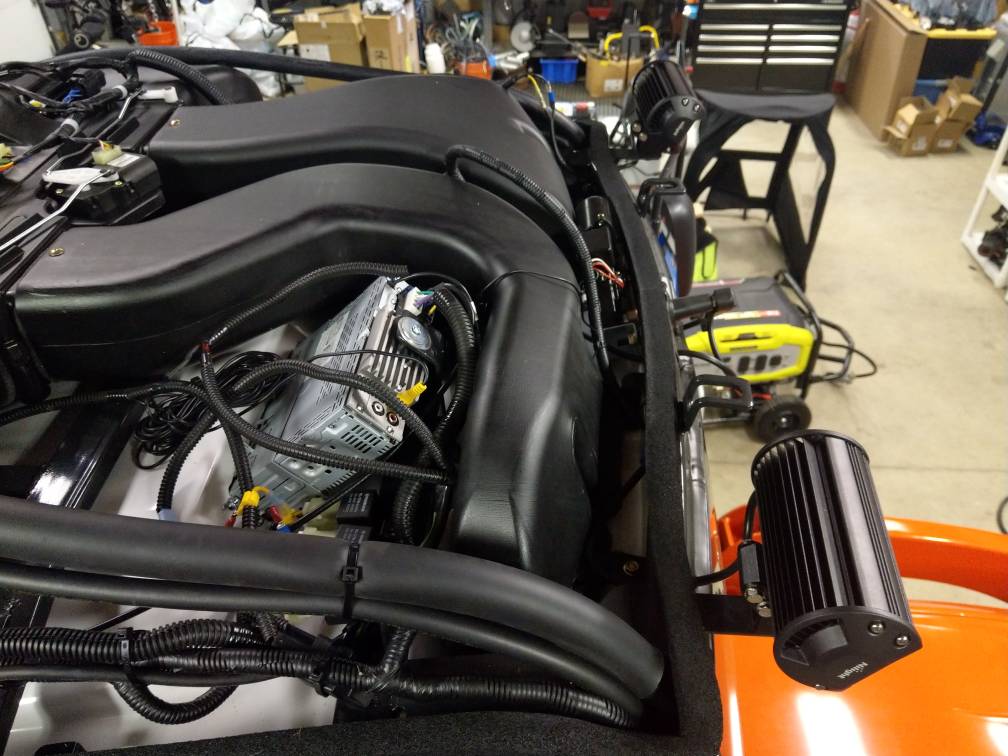

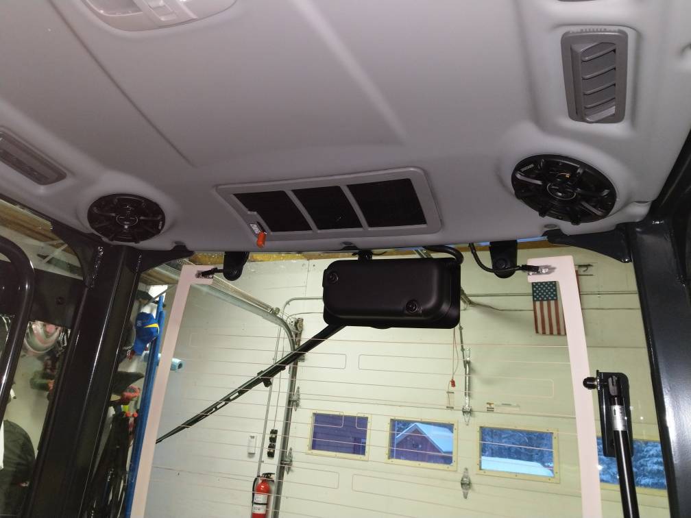

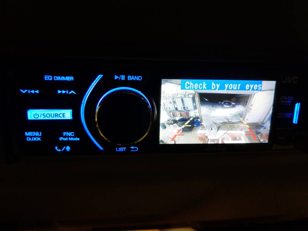

Finished wiring, seperated front and rear work lights by adding relay, new speakers, added rear view camera and a switch to turn it on and off IMAG1318.jpgIMAG1326.jpgIMAG1320.jpg .... IMAG1323.jpgIMAG1324.jpgIMAG1330.jpgIMAG1331.jpg

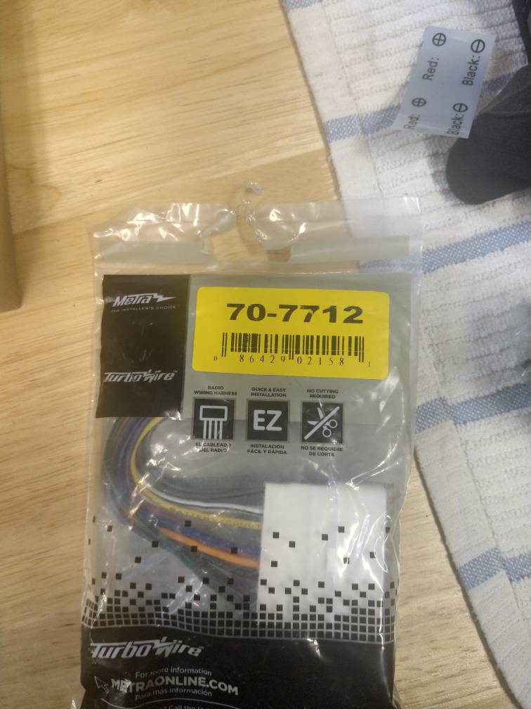

The tractor uses a Metra 70-7712 harness for the radio, is that correct?
EDIT: Lol clearly I need to look at *all* the pictures. :ashamed:
/ Ck4010SE Roof Access #14
Is ground for the radio provided in the harness or did you need to ground it separately?

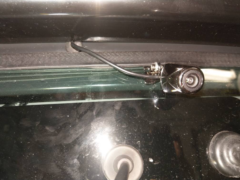

Looks good, nice workmanship. I'm thinking about adding a couple of cameras to mine, having problems deciding what to get I put one in my plow truck and it works good I'm just not pleased with the color rendition on it, I would like to have the quality my RAM has with the 8.4 system.
#17

Thanks. Was the harness color correct for you? I.E. yellow for battery, red for ignition, black for ground, etc. For some reason I have no constant power at the connector but there are no blown fuses from what I can tell.
Edit: Well I can see from your photo that you just matched up the colors, so I gotta figure out why I'm not getting battery power on the yellow wire.
Lack of constant power may be caused by a corroded pin in the harness under the tractor near the cab step. Water gets in the connection and won’t drain because of the orientation of the connector, causing galvanic corrosion of the constant power pin.
