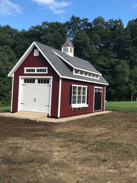

Currently planning out the lumber order for the garage i'm building, and I need to make my final decision on the door height. I know literature specs say 99.3 inches, but that's with rops up, and I believe ag tires. I'm trying to find the measurement with rops down and R4's.
Bonus if anyone has one with a backhoe on it....can you tell me if the backhoe is taller than the folded rops? Googling some pictures looks like it is, but it's hard to tell.
I left a message with the dealer, but he hasn't called back yet, and I need to get this lumber order out if I'm gonna have a chance of getting it before the 4th of July holiday.

We just got a CK3510se w/ R4 tires a few weeks ago. I want to say it's 76" with the ROPS folded. It fits in a 7' high garage door opening (which I want to say is more like 78" at the edge of the open garage door?), but with the back hoe in the stowed position it barely catches the edge of the overhead door. No big deal, you just have to reach up as you drive into in and pull the door up a bit (haven't tried adjusting the door yet). Might be a bit harder if you plan on backing in, though if not locked in place you can lower the back hoe a couple of inches. If you're using sliding or barn doors on the garage and have the full 7' height, no worries.
If backing out of the garage, make sure the entire bucket is clear of the door frame before turning. And if you have the hoe pivoted to the side when driving in, watch the clearance on that side, as it's wider than the wheel/tire. Ask me how I know...

Thanks guys, sounds like an 8 foot door will be no problem at all.

Haha, no, sorry, I was trying to decide between a 7ft or 8ft door, and since it sounds like a 7 makes for a tight fit, I decided to go with 8 to make it an easy fit. I realize now that I didn't say that in my original post.

Ok I am digging into the details a bit further on this. The height (99") on the ROPS model is spec'd with AG tires. Rear size 11.2-24, which my research shows means a 43.x" tall rear tire. However if I ever save enough pennies to go get my 3510, it will be on R4 industrial tires, which they spec as 15-19.5, which are ~40" tall. This means the height of the ROPS on R4s should be right around 97.5", in other words, just a tiny bit too dang tall for 8' doors with the ROPS left up.
Pretty sure I would forget to fold it down and smack my garage door trim off at least once or twice. Dangit, Kioti, just shorten the ROPS 3" already.

I agree the ROPS should be under 8ft for this category of tractor. I am looking at buying a new tractor. The wife said I have to have a shed to store the tractor before I can buy it. I had my shed built with an 8ft garage door. I am considering Kioti, Mahindra, and LS. The height of the ROPS is making me think twice about buying the Kioti.

It all depends which tires you choose. The 99 inches in the specs is for AG tires. R4's is more like 91 or 92 inches. I can just barely get in my door with the rops up, but my door is less than 8 feet of clearance due to the way the door is mounted. I usually fold mine, just so it isn't that close. The 3510se came with pretty convenient pins on the rops, I just replaced the cotter pins with lynch pins, and it takes 10 seconds to fold it down.

FWIW, my CK3510SE HST has the big Titan turf tires that Kioti offers. They are filled. With the ROPS up, the height is exactly 92-1/2". My garage doors are 8 footers, so with the door up, the height to the lip of the door is about 95". Like NYCheese, I can drive right in. I do believe, however, that the R4s sit a bit taller than the R3s, so you'll probably want to double-check that.
