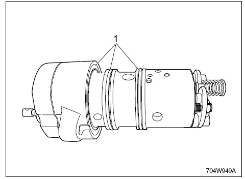

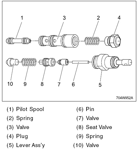

The knob and shaft that attaches to the MLS valve can turn fully clockwise until it stops. I can then turn it completely the other direction and it continues to turn until it comes loose from the MLS valve. I think that I forced this to happen but turning it with a wrench rather than hand tight. I believe I 'broke open' the metal bushing that had held it in. You can see this in the photo I posted earlier. For a better understanding of the situation see attachment CK30 MLS Valve 2, Item 4 in the list is the brass part that turns.
What is preventing the pressure from releasing?
Do I need to remove the valve and clean it?
OK, so you opened up the speed control valve all the way by turning it counter-clockwise. Then
you turned it some more, causing the speed control shaft bushing to unscrew from the valve
body?
In your photo, I can see you have a wrench on the bushing. Perhaps you messed up something
inside, like the pin became unseated? You may need to take a look.

The MLS valve serves 2 purposes, both based off the load it "senses" on the 3pt. Thus "load sensing". First purpose is control rate of drop based on the load and desired drop speed - turn the knob to faster or slower to control to operator's preference. The second adjustment is neutral "band width", amount of movement/drop allowed before self-correcting. This adjustment is the Allen screw with jam nut just below were the drop speed knob connects. Here is adjustment steps for CK25-35: 1 - put 800 lb. on 3pt. 2 - Set postion lever to mid-height. 3- start engine and run at about 1500 RPM (1/2 throttle). 4- Loosen jam nut and turn screw in clockwise until 3pt starts to bounce, turn back counter-clockwise until 3pt load stops bouncing then turn additional 1/4 turn, lock jam nut.
