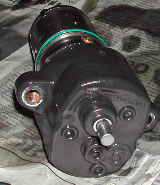

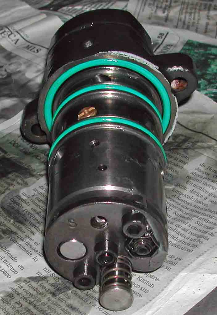

I took off the seat to check on the mechanism. The shaft is operating
properly. It is attached into a grey pump housing (I think it is a pump).
That is the 3-pt position control valve, not a pump. Made by Mita Oleodynamica
of Italy.
Your symptoms seem to point to a problem with it, so you may need to remove
it. Consult your service manual for repairs.
Before removing it, clean that area up well. Photos are of one I removed on
a CT230 (same unit).

Dave, thanks for the pix of the control valve. I have looked at this again and I believe part of the problem is the attachment of the shaft onto the control valve. There is a 'ring' that the brass screw threads into. In the blurry picture I posted, you can see a split in it. It has about 5 splits around the edges. I am not sure if this was crimped on in some way. Since I have been working on this, the speed control now can be tightened all the way in but when turning the other direction it completely comes loose and separates from the valve. I put the seat back on so I can't take a photo. My valve looks a little different then you photo.
Anyone understand how the shaft attaches and what actually turns in the valve to increase/decrease speed? Maybe the crimped part was a stop so you can not turn it too far out. I may have split it by turning too far with a wrench.
I guess the next step is to remove the valve. I do have service manual but it is of limited help on this part.
I don't care much about the speed control but I do need to raise and lower the three point. BTW, I have one lever for the three point not two as some models use.
Is there any pressure build up to be concerned about when removing the valve?
Is it possible that the valve just needs cleaning or is it likely a replacement?
Thanks again.
Ed

FWIW the valve is a POSITION CONTROL Valve, it is not so much for speed as it is for helping to control the position of the 3 point assembly, arms, etc. Therefore if it is 'locked' closed the 3PH will not move in a downward direction, hence your current stuck 'up' state.
If I'm understanding what your stating: the valve's knob & shaft will allow you to turn the shaft all the way clockwise until it will go no further, correct?
When you try to OPEN the valve by turning it COUNTER- clockwise it will not turn at all?
If that is indeed the case your PCV is not working.
Please verify the above questions.
