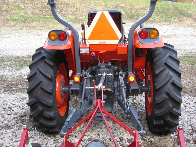

I've read here about widening the track of the CK30 with ag tires. Looking at mine I can't see how, maybe it is already as wide as possible.
How do you do this, just take the wheel off and reverse it?
Thanks,
Mike
   / CK30 Widening Track? #2
The ag tire wheels are 2 piece. The outside ring can be seperated from the inside dish.
If you look at the lugs that the dish hooks to you will see that it will make a difference which side the dish is mounted to them and also the dish and outside ring are offset from centerline differently.
The tractor in the pic is a CK series set as wide as possible.
BTI
I like that! Not sure if I would have figured it out!
In your experience how much less tippy does it make it? Any downside?
Thanks a lot for the 1,000 words.
Mike
   / CK30 Widening Track? #4
BAH! BTI, you forgot to put on the left side 3ph arm stabilizer.
I've had to weld my right side stabilizer together a few times.

   / CK30 Widening Track? #7
mrutkaus, no downside unless you have a gate that's not wide enough to get through.
island, I do know that the old L3000 and LK3054 wheels would interchange.
I would just measure them and see.
I'd bet they will, but would want to make sure before ordering something.
