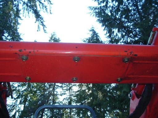

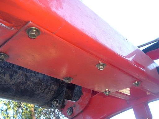

I was tightening the 6 12mm bolts holding the cover on the loader cross member and noticed that the two middle bolts were stripped and would not tighten. Picture attached.
5 of the bolts were loose and I could see how tightening them would strengthen the frame.
It is possible that the two center bolts being stripped is a coincidence, but that kind of stripping could also be caused by movement, so it might be a clue as to where some stress is.
Mike

/ CK30- Kioti loader failure #48
I like your picture---one of mine became a two piece bolt while tightening.
I think fastener quality control may be lacking or its really a grade .05 ???

So do you think the welder will remove the hyd hoses from inside that cavity? I'll end up taking the cover off to check for melted stuff.
/ CK30- Kioti loader failure #51
It looks to me the cover plate is just that and provides no structural support and the opening is flexing.
On out of warranty loaders I would get a another cover plate the same thickness or one size greater as the frame and add about 12 grade 8 bolts to what is already there.
/ CK30- Kioti loader failure #52
Just the fishing of that hose pack through it's route up the frame would be a chore---maybe a "flat rater" would skip a step, but your right- hoses would be char broiled...
/ CK30- Kioti loader failure #53
Seems like the hoses could be covered with a heat shield(the stuff for muffler/manifolds), and that would be easier than pulling everything out. Heck, even fiberglass insulation might work?
RD
