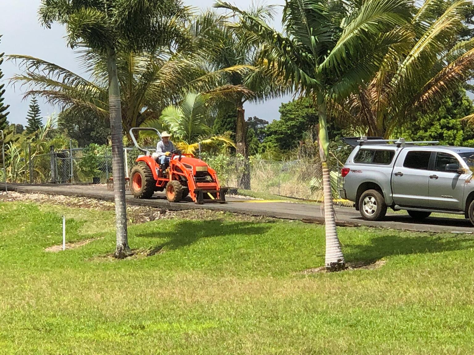

Was able to get it up to firmer ground using long straps and chain with truck on the driveway for solid traction. Ground just too soft from the pig rootings. Then was able to tow it on to drive and back home inside the fence.
Took bucket off and enough tension with strap to keep quik attach off the ground.

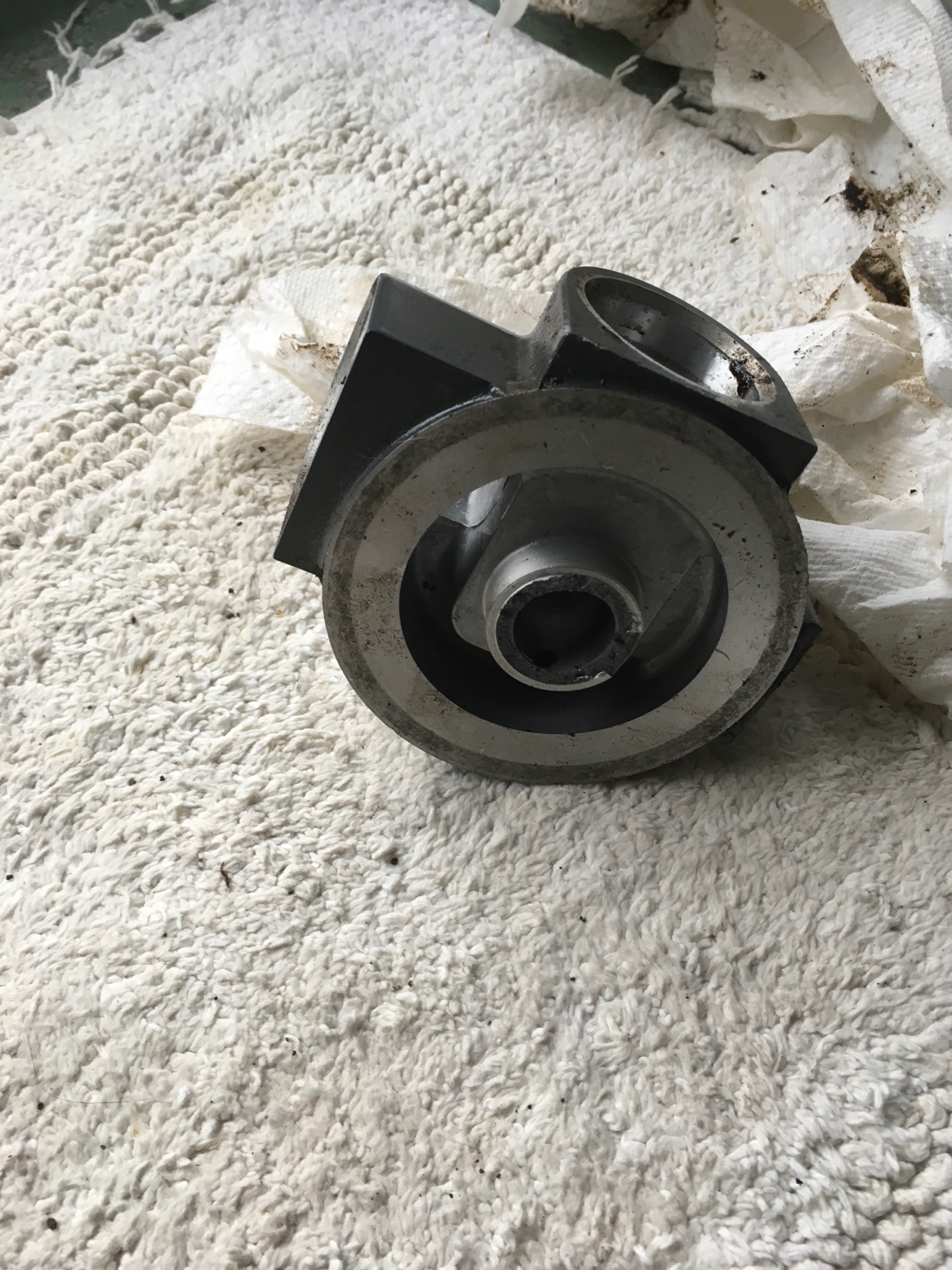

Got the broken filter housing off, getting new one back on could be a challenge.
Seems maybe I should have ordered O rings, but only 1 shown. Anyone know O Ring specs?
Banjo bolt had no washers at all.
Broken housing

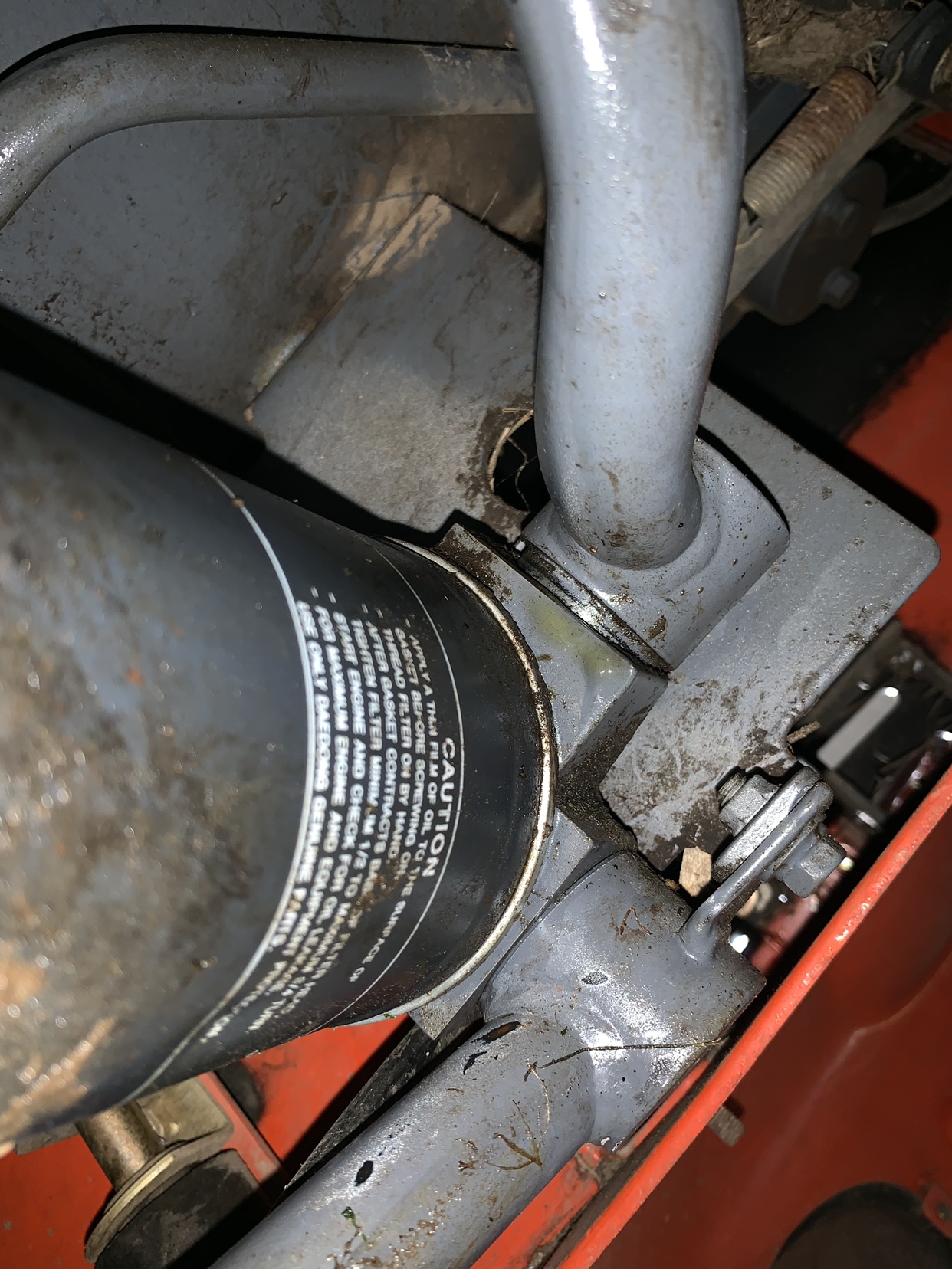

Did you need anything else beside the mount and a new filter?

You might want to get new O rings. I was careful and mine were OK.
You’ll also need to refill your hydro fluid.
