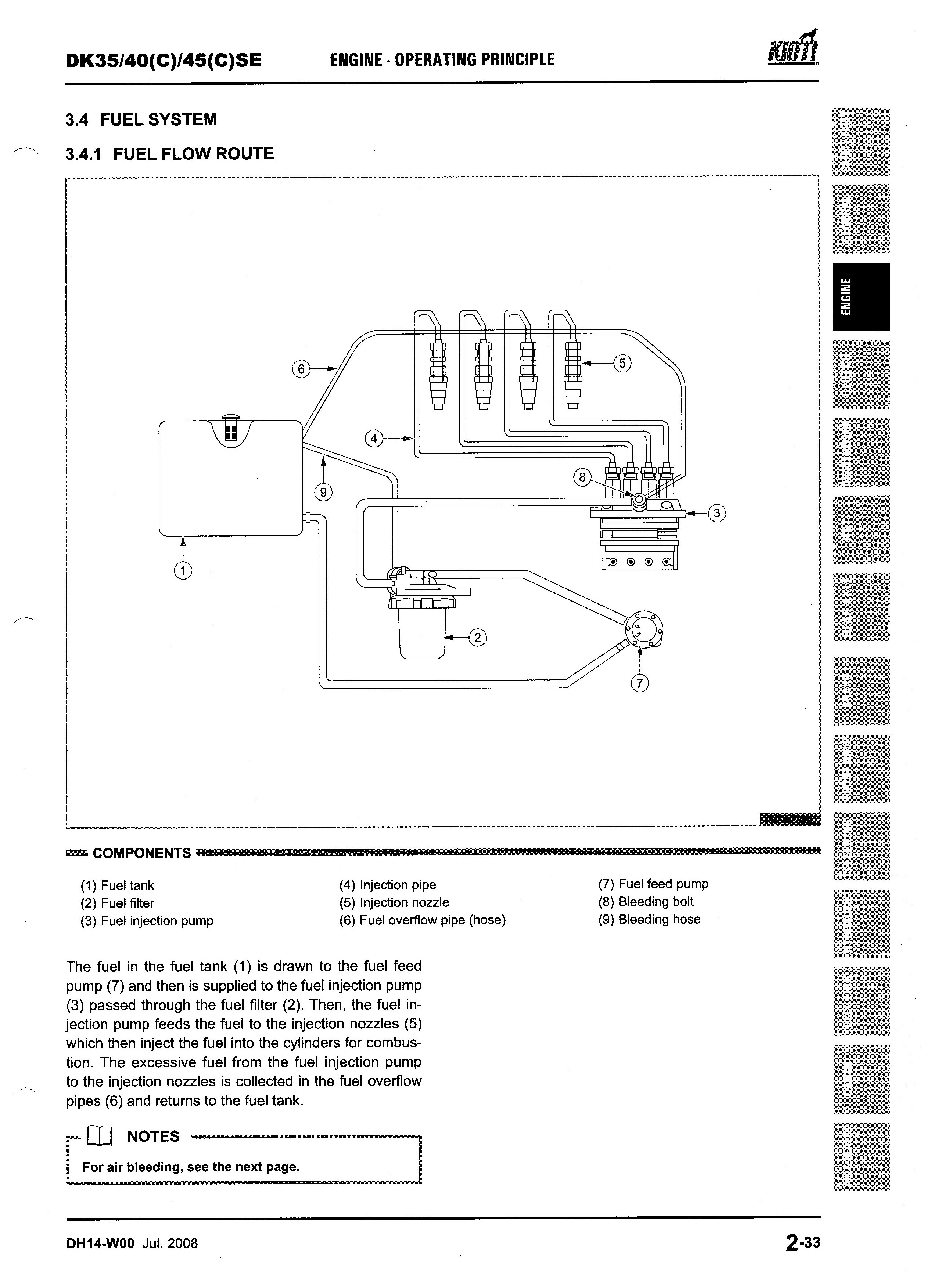

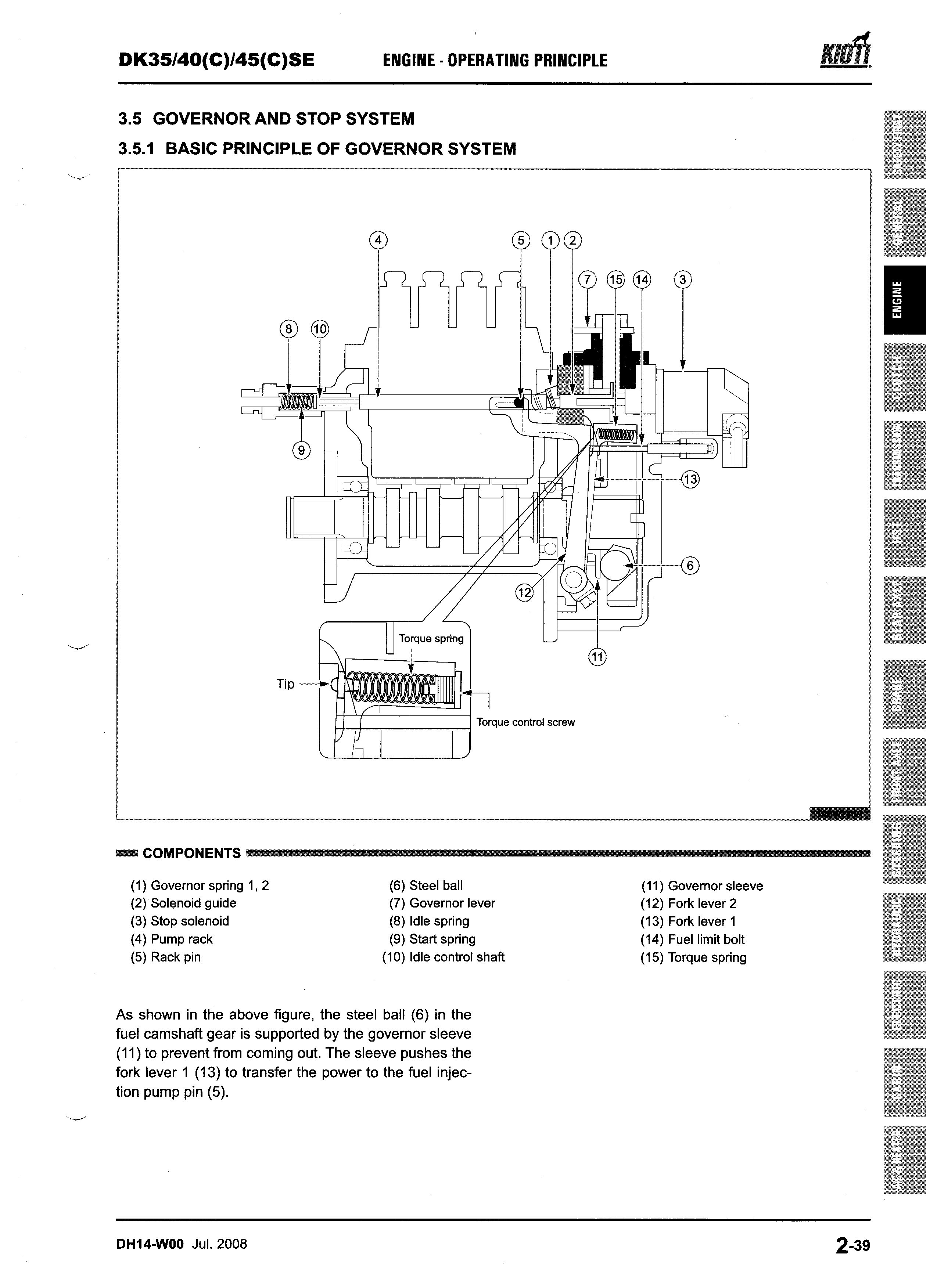

Here are the instructions for bleeding on the DK series injectors, but ive been told the CK are the same.
The line drawing on 1st picture shows the bleeding bolt . There are also step by step bleeding instructions
Hope this helps
in 3.5.2 (Page 4) theres a step by step list how the stop solenoid functions.
