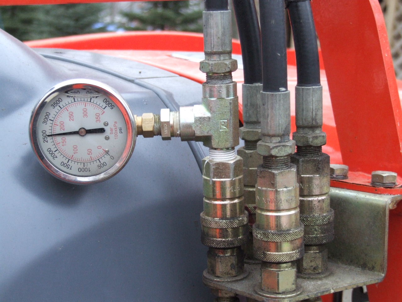

Here's a way of attaching a pressure gauge 'inline', demonstrated on a CK30.
I searched on ebay and found an inexpensive 5000 PSI pressure gauge (about $5.00 + shipping). Took the gauge to a local 'hydraulic hose supply' and asked for a 'T' fitting. They had the exact fitting without having to use any inline adapters, just one reducer for the gauge itself. Cautionary note: Do not use regular plumbling pipe, it's not designed for the high PSI's.
See attachment.

Very cool gauge add-on, TB. Did you use regular pipe thread compound on that connection?
Now that pressure is confirmed, it looks like a 2500 psi cylinder might be damaged by my CK. I guess that means a 3000 psi cylinder.

I'm not sure of the exact compund I used. It's been a little while since I added the pressure gauges. Care must be taken if using teflon tape for fear of shearing off a small piece of the tape and then causing problems if it gets jamned in the system. A pipe compound is a more popular choice.
Quick disconnects could be plumbed in the setup for ease of use.
