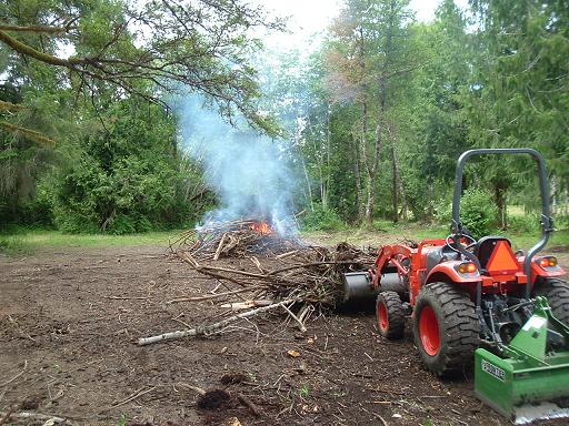

I would love to have the grapple, but not in our budget. The area I clearing has all scub pines, and thick brush. I did not have an open area to push any of the waste into, so I just made a hole and went for it. Now I'm going to call our county on Monday to find out when our burn ban starts in Sussex Co. VA. Making some headway.

I too suffer from not having a grapple. Though relatively cheap, they seem to be a technical hurdle for me with the hydraulic controls and such. I made due without the grapple for several acres of clearing. One thing I did learn is that there is a point where the tractor is not the right tool for the job and to move on in those cases to the next area or step of clearing. Stump removal is a fine example of a time where it is best to just leave it alone.
I've done lots of burning myself and hired lots of burning done. In my case a logging company was hired for the burn and they brought an excavator on site to do the work which bills at 100$ per hour. They have insurance for runaway fires, they have a burn permit, they have the ability to grab a stnading tree which has caught on fire and pull it down and into the fire which happened about 9 times at my last fire. Without that excavator I may have had a forest fire.
Burning slash with a tractor is fun and quite rewarding but it takes a lot of time and includes a lot of risk. I found that if I piled the slash near the burn site over the course of the summer that the hired burner could be very efficient at burning the slash. While the excavator is letting the fire burn down he can be walking around and popping stumps to be thrown on the fire.
In all cases, you first make a clearing and then push the slash into the clearing in a nice organized heap.
I've made several long threads about my clearing adventures which were accomplished with pretty much the same equipment that you have. I added and recommend that you add one piece of equipment, a toothbar. Mine was from Markham and was cheap. Very useful.
I attached a couple of pictures for you. The excavator is very large requiring a wide load low boy. No tractor could stack the brush on the fire like that machine 20-30 feet tall. My burn permit was for a pile less than 50 feet in any direction.
