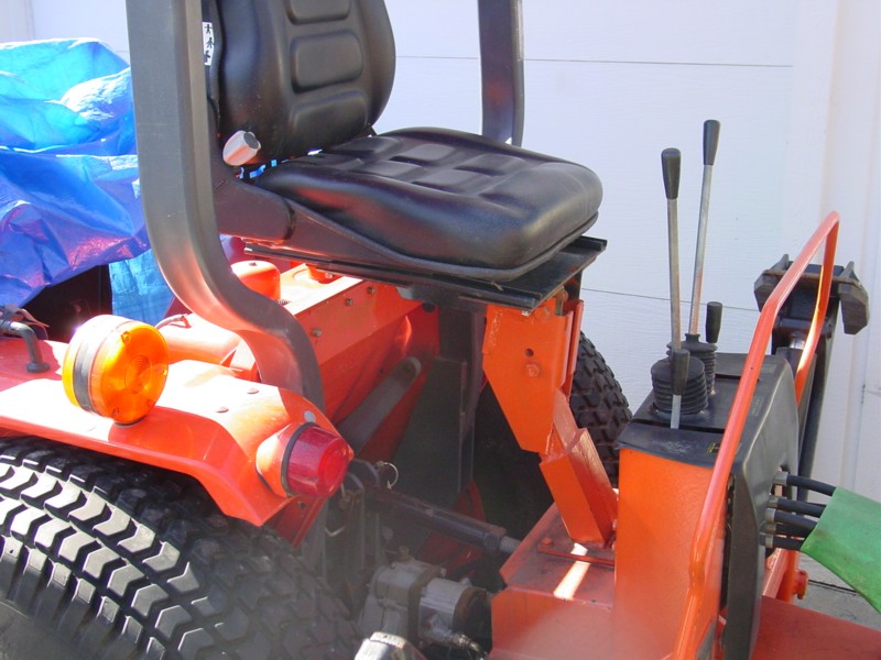

The seat is one of the reasons, I am sure, that the add-on hoe subframes
are made the way they are. All 4 of the custom subframes I built reqd
modifying the hoe seat mount. I also went to a smaller seat for the hoe.
Usually the seat on the hoe was folded up when the tractor seat was
down, and conversely. Flipping the seats as I switched from tractor to
hoe was easy.

I'll have to post a pic when I get a chance, but looking at my BH70X on my CK20, if you could relocate the fuel tank, you could shorten the subframe maybe 6" before the seats interfere with each other, so you wouldn't gain much. The pic earlier in the thread looks like a BH6000 on a CK20, which IMO is kind of goofy. The BH6000 belongs on a SCUT. The seat on the BH70X is higher.

As I mentioned, the hoe seat can be folded up when the tractor seat is
down, and conversely. On my 955, the two seats when down occupy the
same location. This customization is easier than fabbing the subframe
or modifying the fuel tank.
