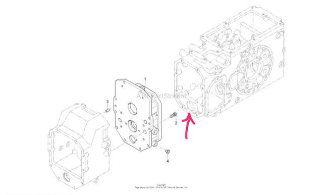

I have a small persistent hydro fluid leak where the mid-section piece is joined to the back transmission case. See diag.
I had the tractor split and repaired last year with a bunch of new internal o-rings, new case bolts and re-goop gasteted. The leak stopped for a few months but now is baaaack. I notice that it drips a lot less (less than a teaspoon every month or two) if I don't relieve hydraulic pressure on the bucket when I shut it off so I'm probably not going to have the tractor split again any time soon.
Any ideas what could cause this? I assume it's always got hydro fluid in this section so is it most likely just a bad gasket application? Could a leaky hydro pump seal cause this?

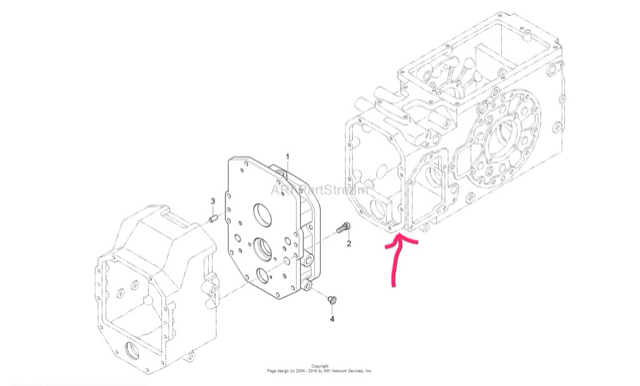

.... actually, the gasket weeping is more like along the bottom. ImageUploadedByTractorByNet1477438748.254620.jpg
/ CK/HST - Transmission Leak #2
'less than a teaspoon every month or two' ......................... If that is all it's leaking, I would not worry about it, just keep the system full.

There is a bobcat service bulletin for leaks in this area that results from the bolts stretching under torque conditions. Talk to a bobcat dealer or see if you can locate "knowledge article #000002611". I have heard of people retorquing their bolts multiple times and the keep loosening back up again until they are switched with the new hardware. Apparently it includes replacement bolt and washer part numbers as well as a procedure for replacement. I haven't seen it but would be interested to if you locate it. There has been good discussion on this in the bobcat tractors forum if you are able to dredge it up as well.
Justin
/ CK/HST - Transmission Leak #11
The "seal" for this is just a silicone. We typically split the unit, clean everything very well then reapply sealer and let it dry to a "heavy skin" then reassemble.
Doing this job "on the clock" is a real pain because the shafts do not like to line up LOL so extra time and care must be taken.
It is quite easy to mess it up reassembling because of this fact.
You also have to make sure ALL oil is out of the bottom of the 2 halves so that oil doesn't start to run forward while reassembling and ruin your seal.
I'm guessing the reason it leaks more when the bucket is up is because it causes the case to open up a very slight amount at the top.
If your seal is already leaking this slight amount would be enough to cause it to leak more when the bucket is up.
