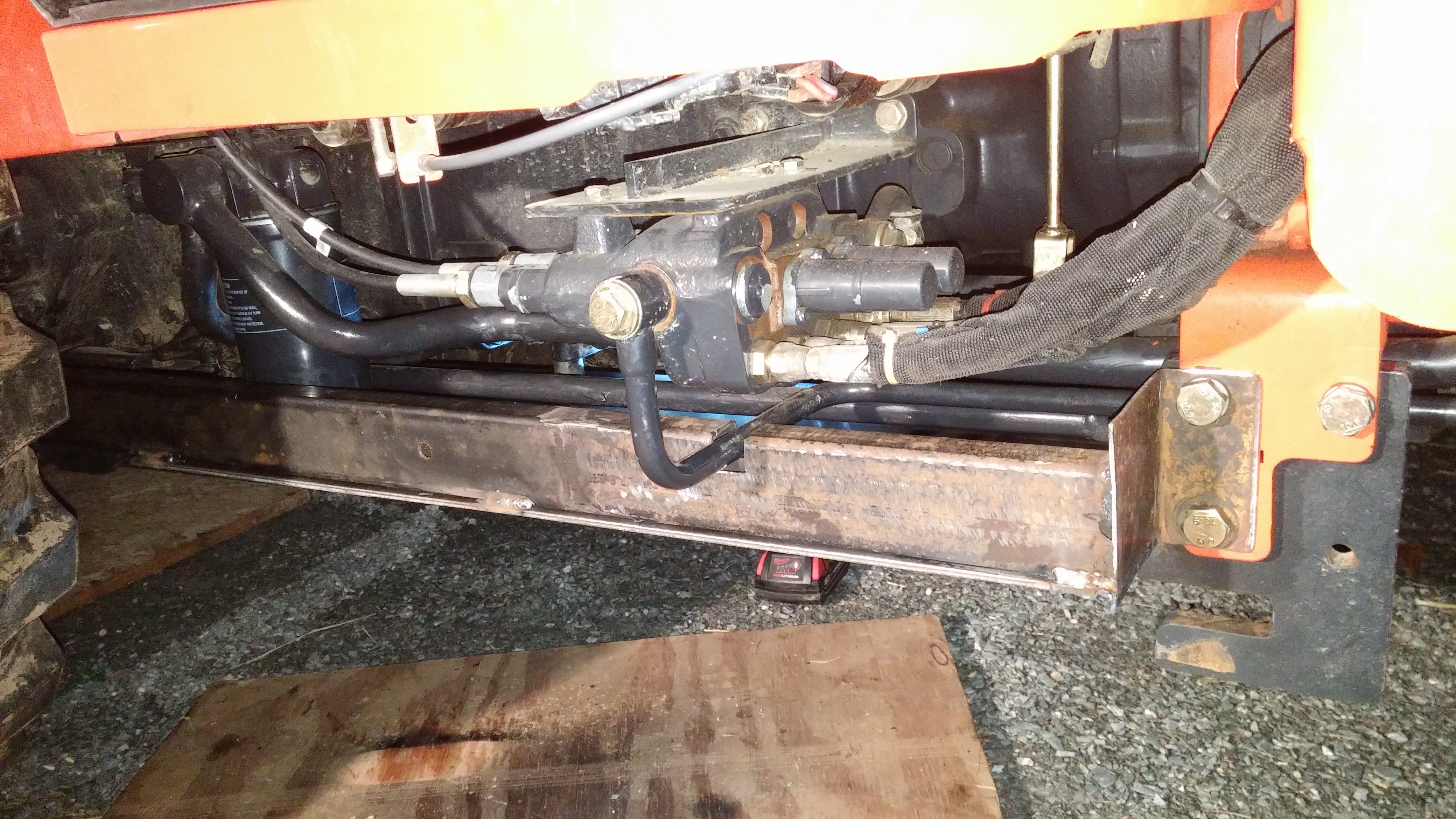

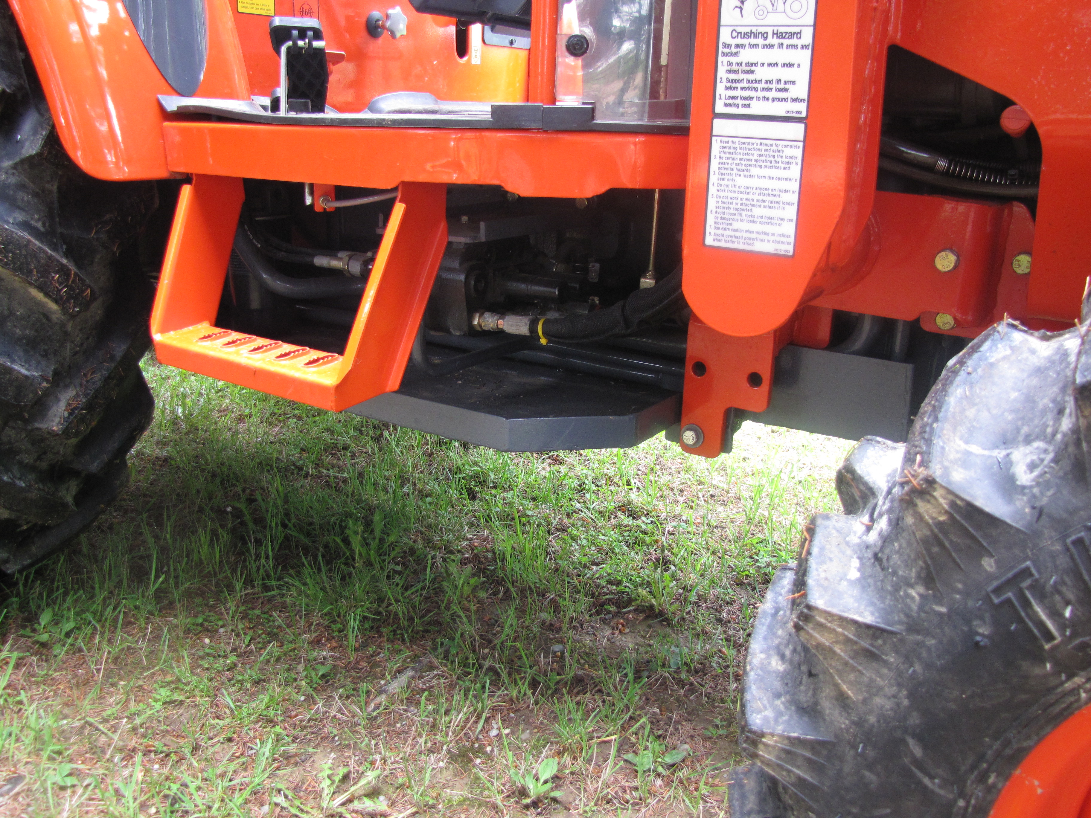

Hi Everyone
Just replaced my 80's kubota L275 with a 2015 Kioti CK35 what a difference! easier starting much faster loader and great backhoe.

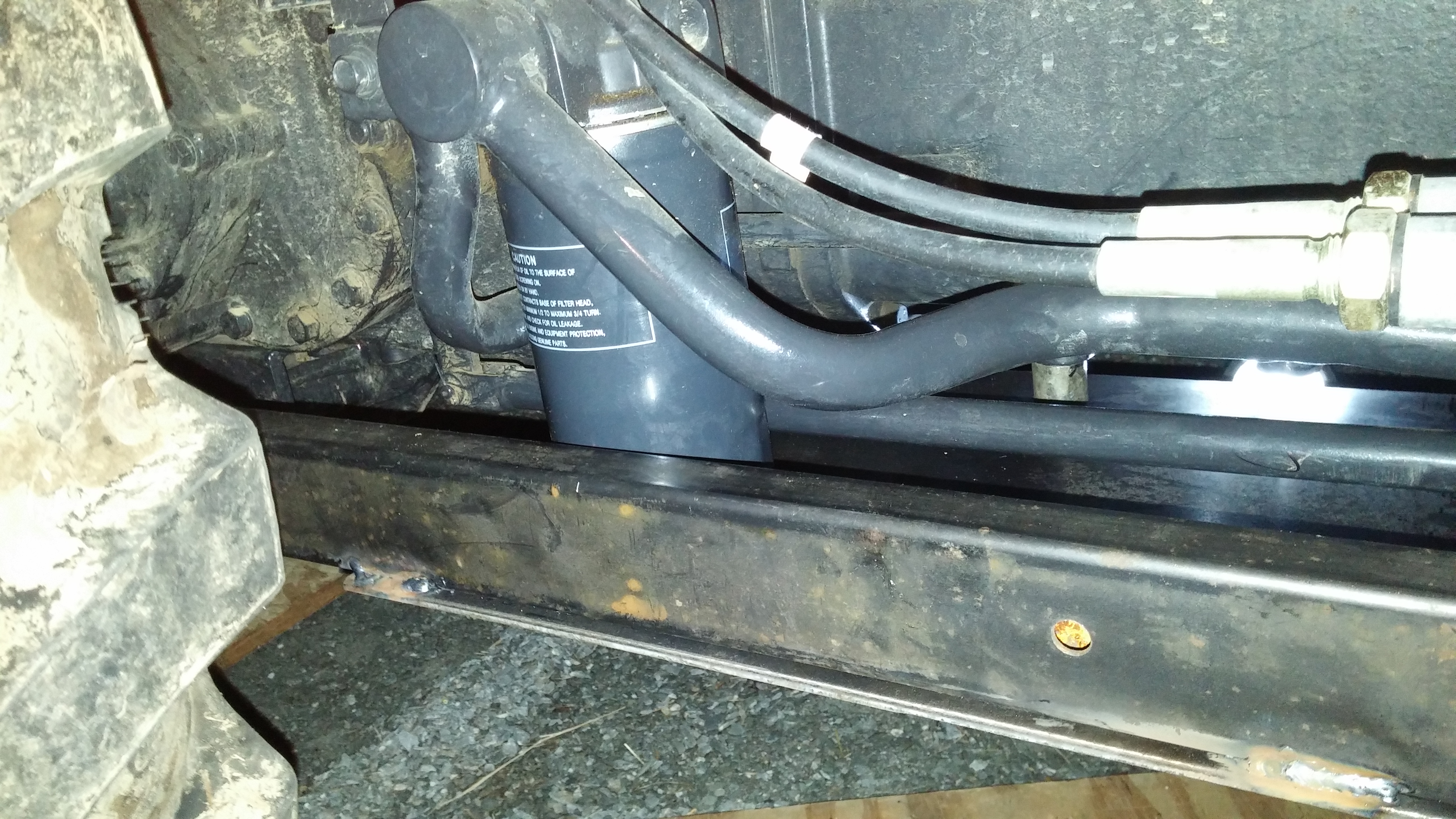

One thing i noticed is that the hydraulic filter hangs down quite low and i will be using it in the woods for some fire wood logging and worried about ripping it off. I already dented the end of it with the backhoe frame.
Has anyone made up a shield for theirs? Any ideas would be great.

That filter on the CK looks like it is in a tough spot to add a shield. Maybe some 4 inch angle iron placed in front and back of it to shield it.

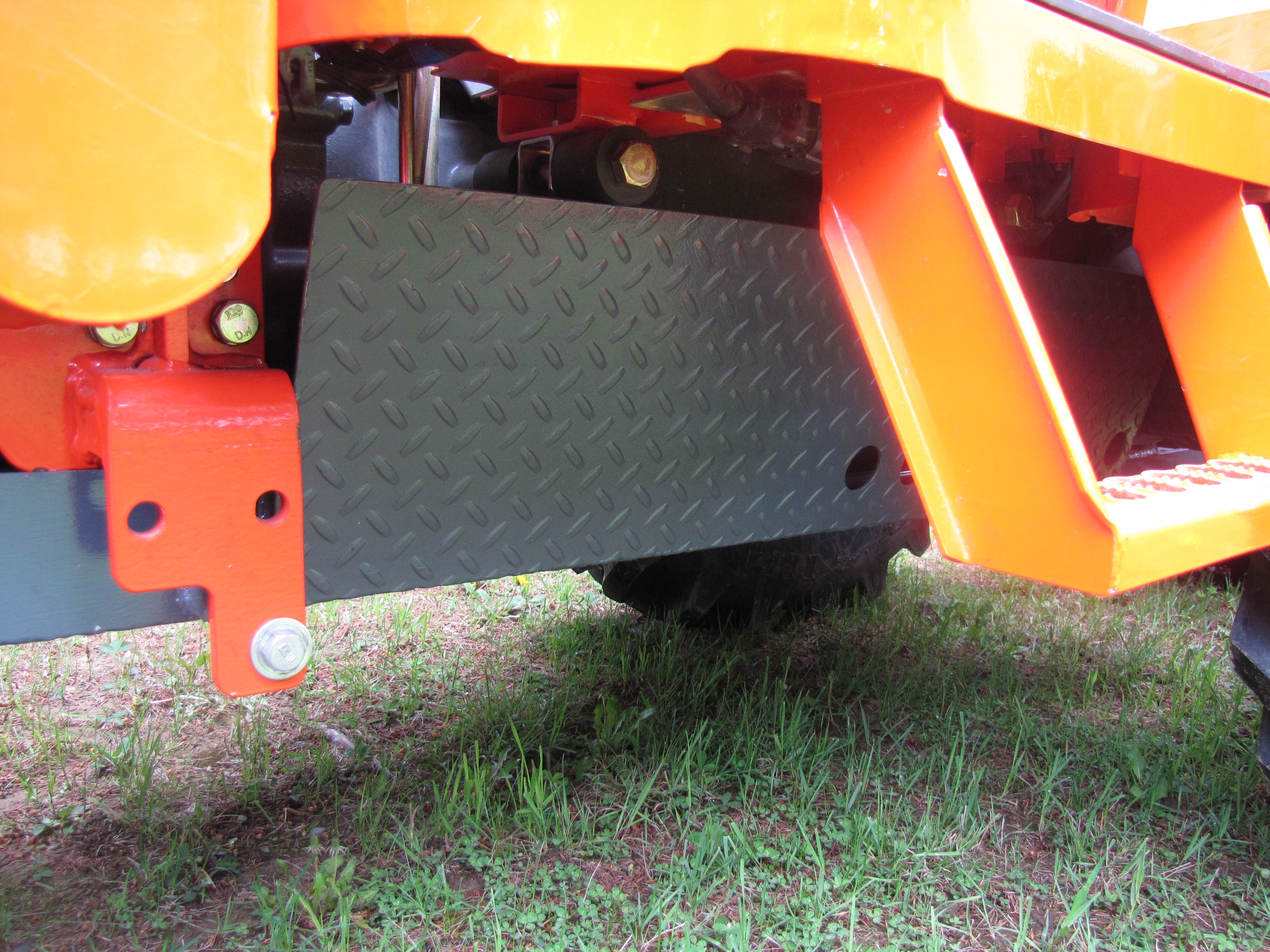

A year back or so, someone put a belly plate on theirs. I think they fabricated it out of diamond plate and went with some longer bolts at existing points to mount.

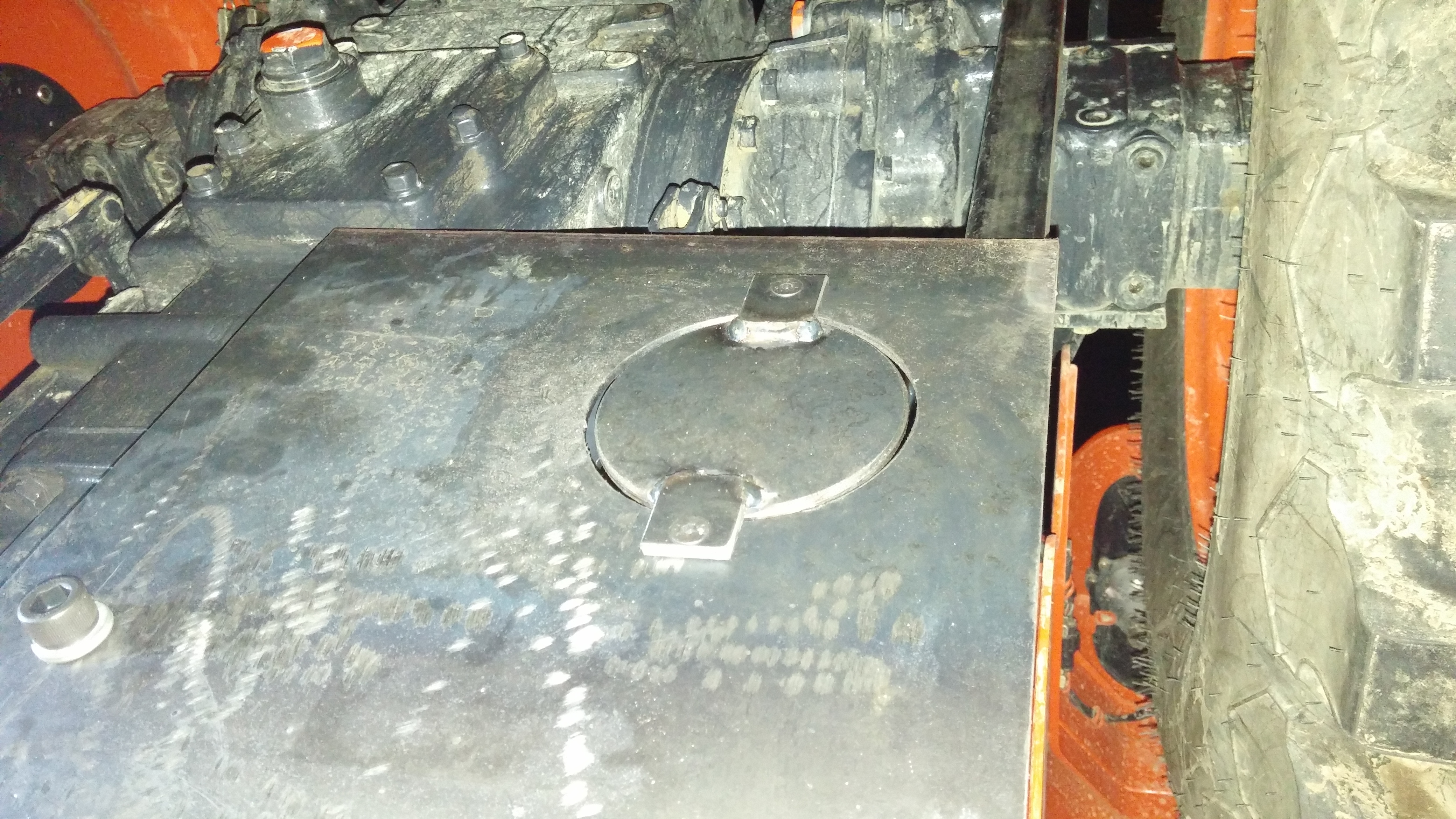

I have mine mostly done both the frame and base plate are finished just need to make up the sides then paint it up pretty. I went with the filter trap door that I had seen on some other ones. Had a challenge keeping it up tight to miss the backhoe frame.

It would be hard to move with all of the hard lines holding it. One of the lines comes out of the base of the transmission.

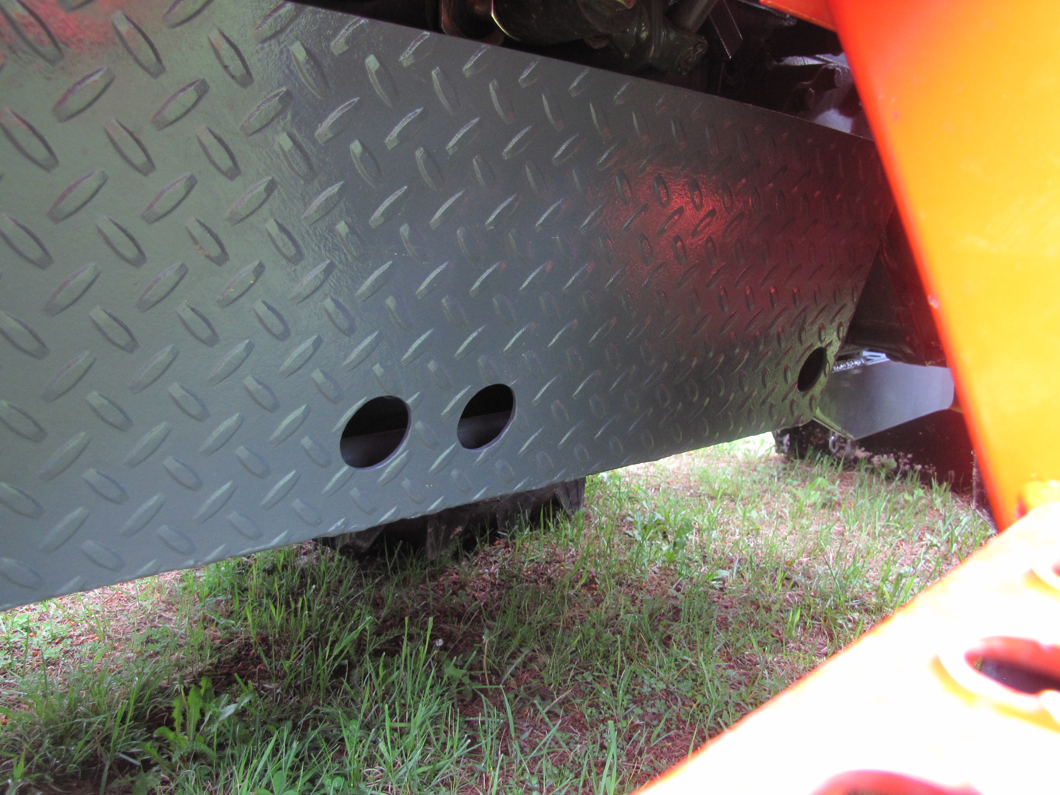

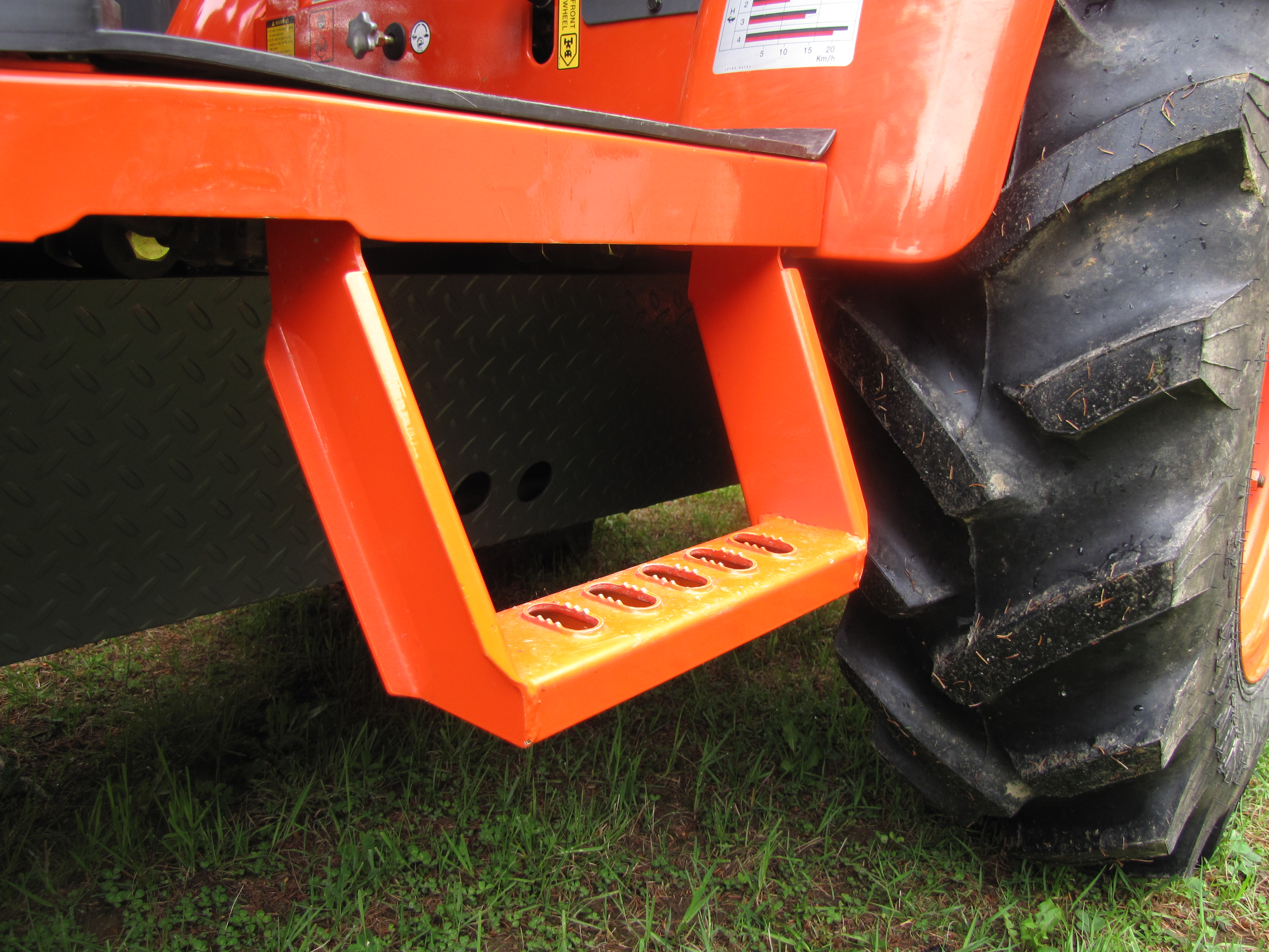

Finally got the finished product all painted up and installed. Found a color that matched pretty well it was RAL 7021 Black Gray. I used a epoxy paint so hopefully it will hold up well. I was able to bolt into 3 different locations one just below the rops bolts on the rear, 2 bolts into the transmission and into the backhoe brackets. Should be able to lift the tractor with it now!

Nice job, jabelding! Looks really good :thumbsup:
/ CK 35 hydraulic filter protection #14
Awesome Work !! Very Beefy for sure.
