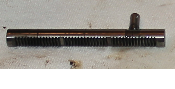

The "bad" ones haven't been made since 2007, or so, so you should get the latest version. This photo (from neches write up) shows the lines on the bottom of the rack:
When correctly aligned, marks (dots. I think) on the bottom of the gears align with these lines, with the rack centered, as I recall. Sorry, no photo. Recommend you study neches writeup carefully before you begin. Also, use your cell phone to take photos as you go, especially if you have to leave for a time with the job part done.
In case your new gears don't have these marks, use the adjacent cylinder as a guide (another reason to do one cylinder at a time). Even with the gear correctly aligned with the rack, it's possible for the plunger to be rotated 180 degrees, which won't work. So note the orientation of the slot in the plungers.

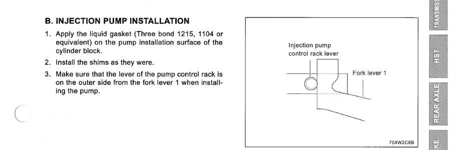

Well good and bad. The control sleeves finally came in this week so today I went out to work on it. Thought I might be able to start it again and idle it into the garage but no luck, so I had to work on it in the shed which was a pain as I had very limited room. Got everything apart and when I started taking the pump part I got the first one out and everything looked good but I put a new sleeve on that one then onto the 2nd one and sure enough there were 4 splines broken off, so I put on a new sleeve then moved to the last one and it was fine but I still put a new one on that too. Got it all back into the tractor and buttoned everything up and it started, but..... it is idling at 1200 rpm. I can't get it to idle any lower. So I started looking at everything again and going back over the manual and on page 2-47 under pump installation it reads
3. Make sure that the lever of the pump control rack is on the outer side from the fork lever 1 when installing the pump.
So I had to think if I did that and couldn't remember. So I pulled the oil fill flange cover off and as I was looking at it the lever is like right behind the fork lever. I tried with my finger to move the rack lever to the left(rear of tractor) but it wouldn't go, it would move very smoothly to the right (front of tractor). Prior to actually installing back in the tractor, it would move left and right very very smoothly. Is the rack lever supposed to be all the way to the left when reinstalling it, I kind of had it centered in the pump when I put in back into the tractor. I took a pick but it is hard to get straight on as I had to work around the FEL arms.newly installed pump.JPGHere is the broken sleevecyl 2 control sleeve.jpg
So basically I'm wondering if removing the pump again and moving the lever of the control rack is all the way to the left, if that will solve my problem. I did try loosening and tightening the idle adjust bolt, but it didn't have any affect. I actually made a mark on it and where it screws in so when I reassembled it, it would be back at the original spot. The only good thing is, if I have to do it again, I can at least remove the FEL now that it runs.

With the Stop Solenoid installed and un-powered, the rack should be forced full aft (by the strong SS spring) so you won't be able to push it farther aft but it should move forward with enough force. But with the SS powered (or removed) the weak preload spring behind (left of) the IP should push the rack full forward to rest against the other arm (not visible in photo) of the governor. Is it possible one (or more) of the gears is a tooth off where it engages the rack, which would deliver too much fuel to that cylinder? Did your new gears have an index mark to align with the marks on the rack? I'm just guessing here but it seems like you should be very close to correct or the engine would not have a stable idle, even if a bit fast. How is it at higher throttle settings? Stable?

The new gear either has a dot or a chamfered tooth..
they are hard to see when they're down inside the pump bore..
A flash lite is A MUST..
I've gone so far as to mark the chamfered tooth w/ "white out".. so its easier to see..
I hope that helps.. TPG

I just re-read your post about assembling it as a whole assembly..
U put the gear in, aligning the dot or chamfered tooth w/ the line on the rack..
Then u put in the spring seat, followed by the spring..
Then u put in the plunger, making sure its going the correct way, WITH the spring seat attached to the plunger.
Then the shim & tappet.. then the tappet keeper pin, then the pin keeper "band"..
Its assembled piece by piece..{except the plunger & spring seat}.. NOT as an assembly..

I took it all apart today and sure enough they were off slightly, each one about 2 teeth, I was putting the control sleeve in how the old one came out but keeping everything together but I would have to wiggle it a little to get the control sleeve to fit the rail and that is how the control sleeve teeth moved from the mark on the rail, and this time I did as you just described and I was able to find the index mark on the control sleeve. Put it all back together and when it started it idles just like before and no stumble or excessive smoke. It works great for now. Thank you everyone for all your help and comments.

Minor technique variation when I did mine. I started with the plunger inserted in the cylinder and then slid the gear (control sleeve) over the plunger shaft and aligned the dot (they were dots in my case) with the line on the rack. Like TPGSC said, you really need a good flashlight to see these gear marks (love those new mini LCD jobs). Then I put the spring and keeper on the plunger shaft by withdrawing the plunger just enough to slip the "keyhole" over the end of the shaft. The flats on the shaft were always in the control sleeve which was still engaged in the rack. I don't recall if it is possible to see the gear dots with the spring in place.
