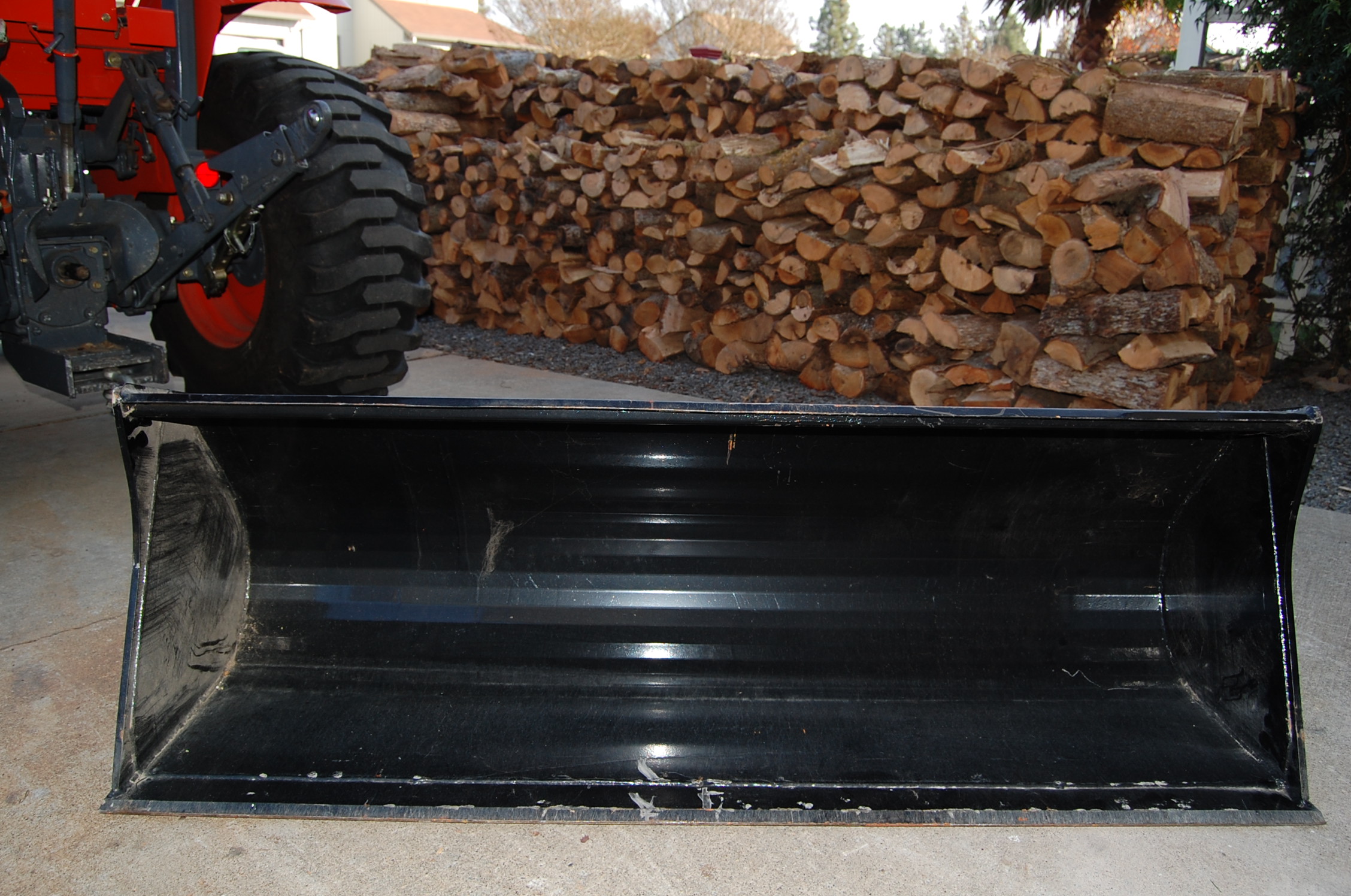

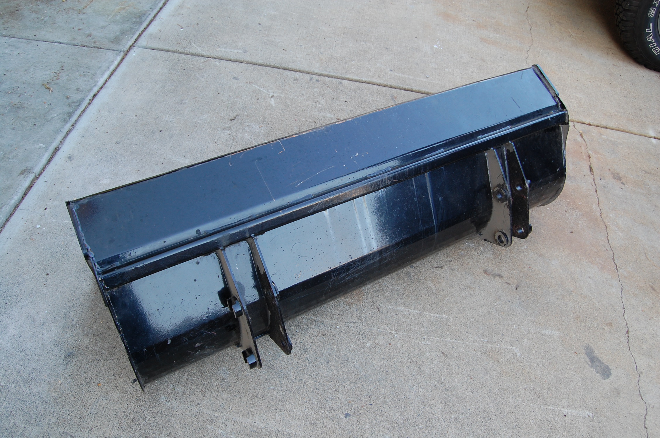

FOR SALE: "New" 54" bucket for KL120 loader, any takers??
