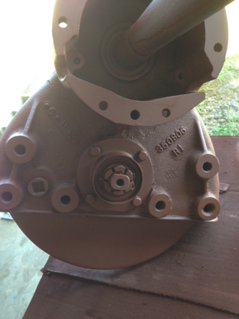

Circle Cub (4 digit) Restoration
   / Circle Cub (4 digit) Restoration #1
Shaneard
Veteran Member
Nov 18, 2016
1,345
Southern Virginia
Ford 4630, Two IH 140's, John Deere A

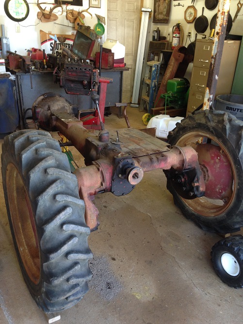

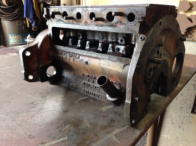

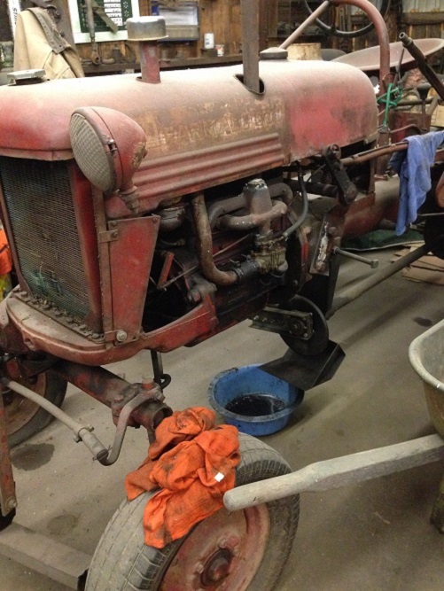

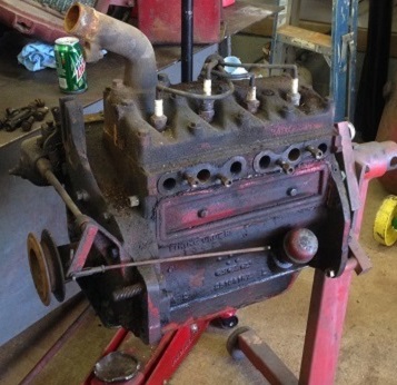

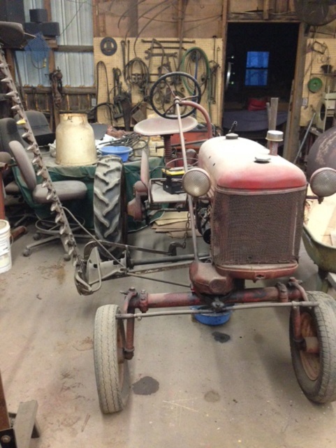

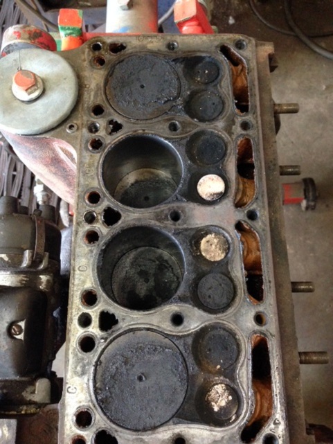

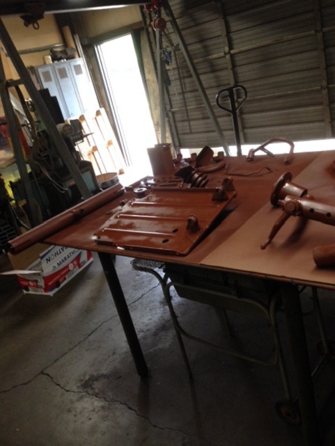

I got this tractor from my brother for the trade of a shotgun. He got it from a friend of ours who's dad passed and he and his brothers didn't want it. I just need to paint it red and it's done.

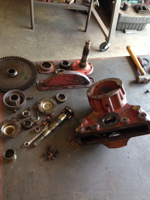

#2

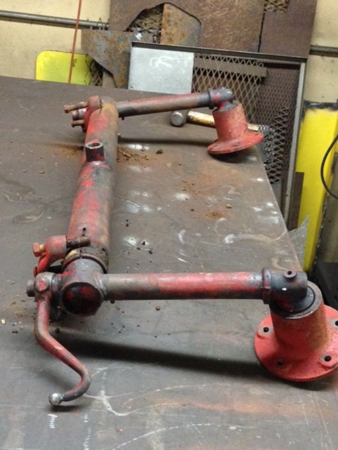

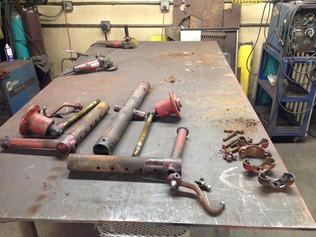

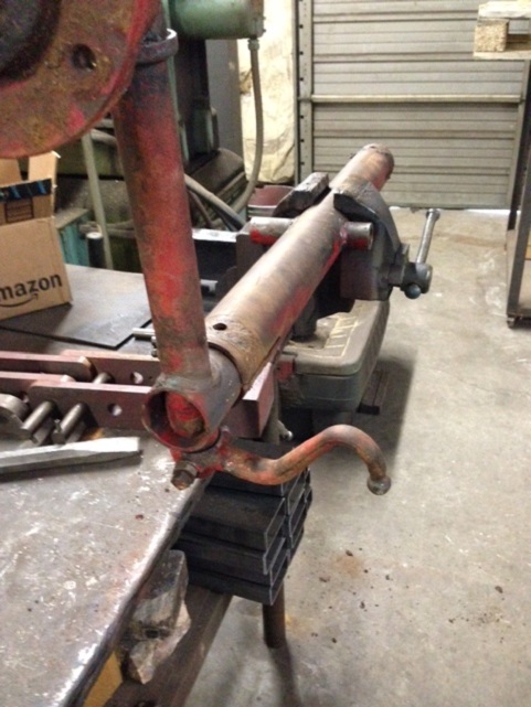

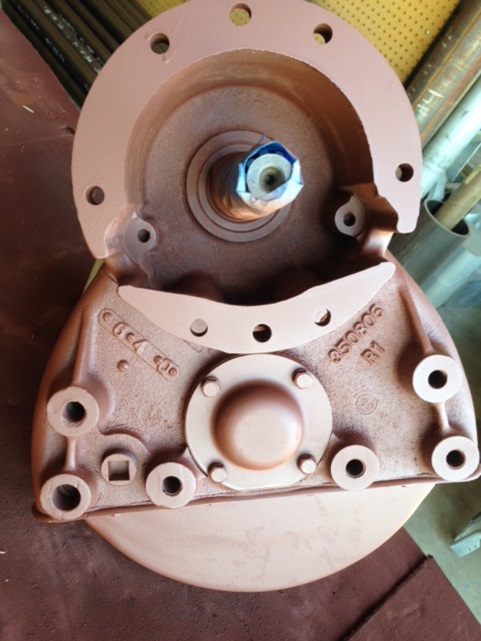

Front axle.

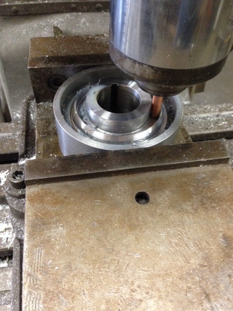

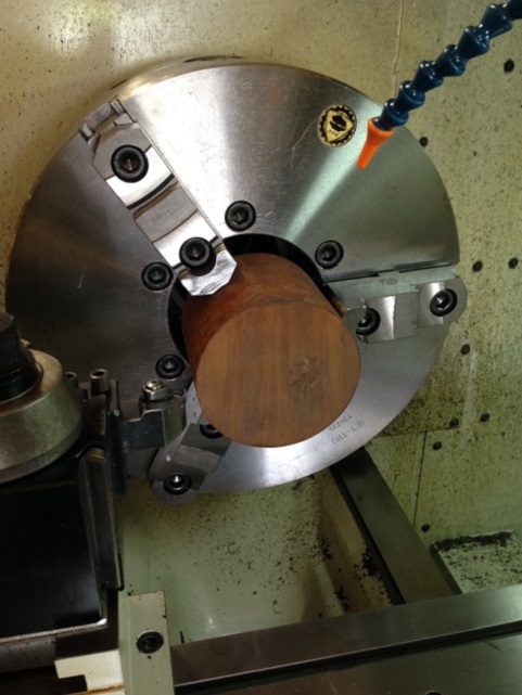

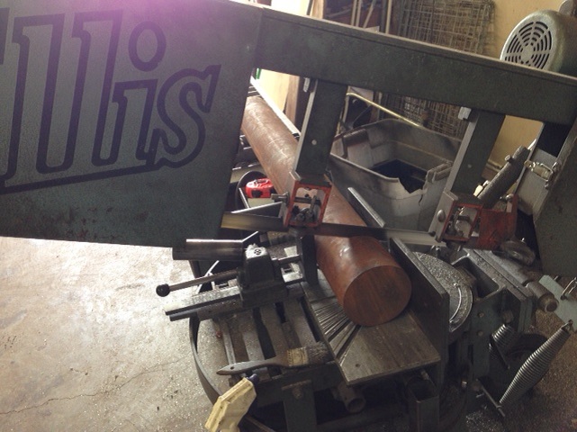

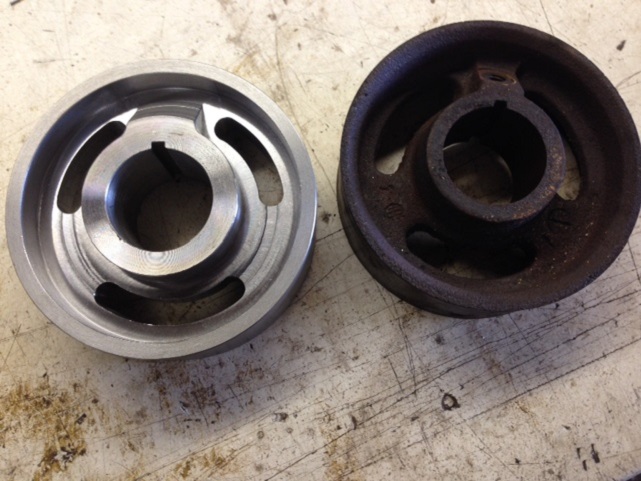

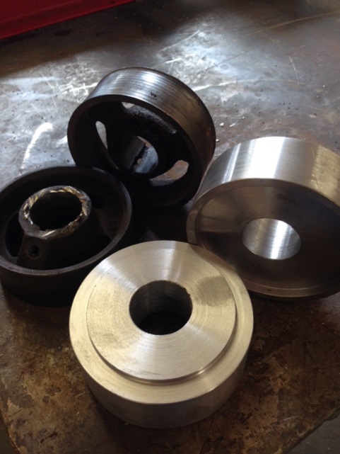

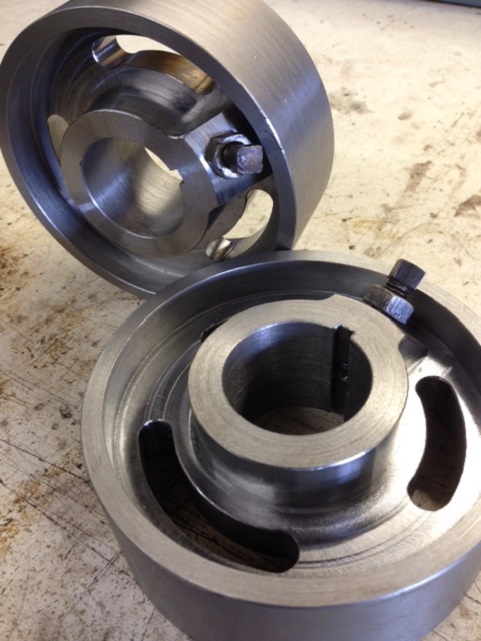

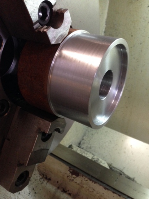

Decided to make my own brake drums instead of buying them.

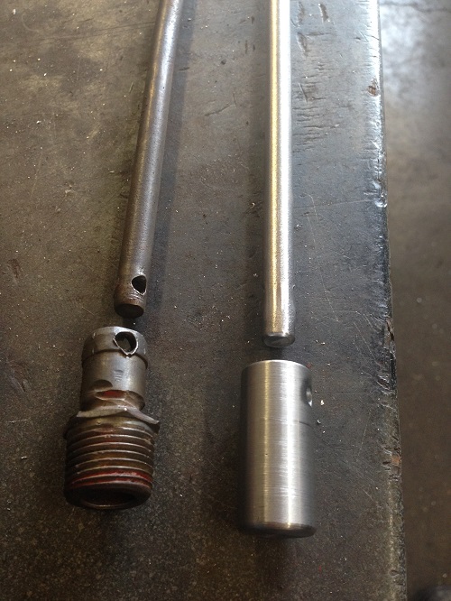

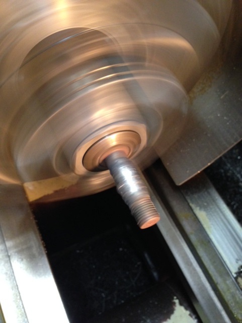

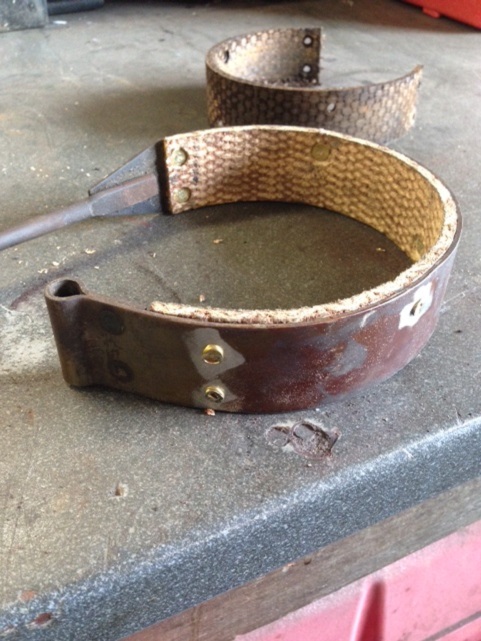

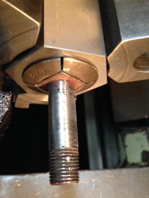

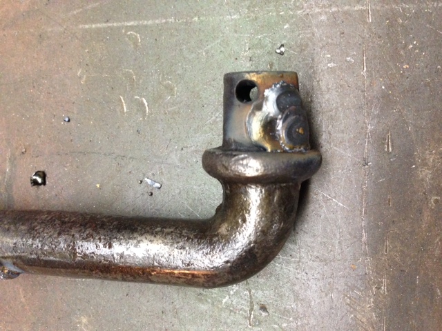

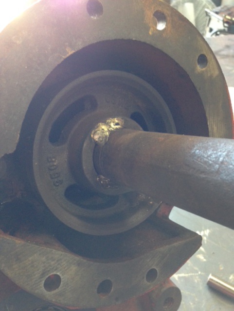

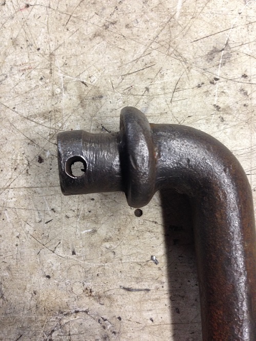

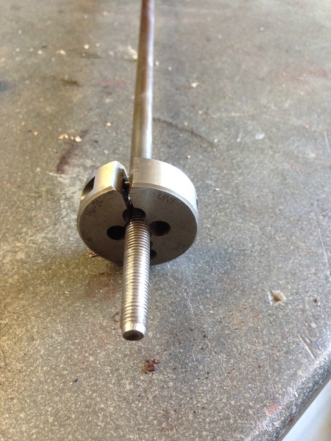

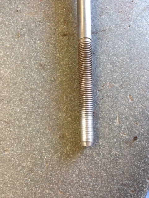

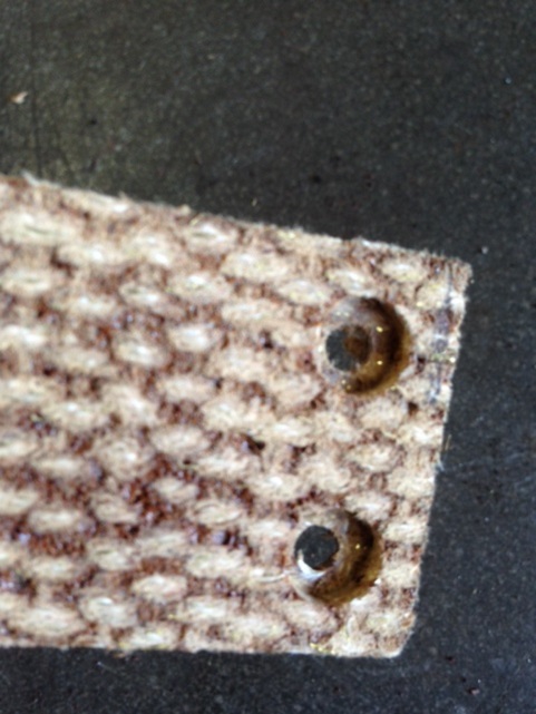

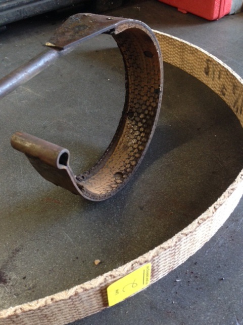

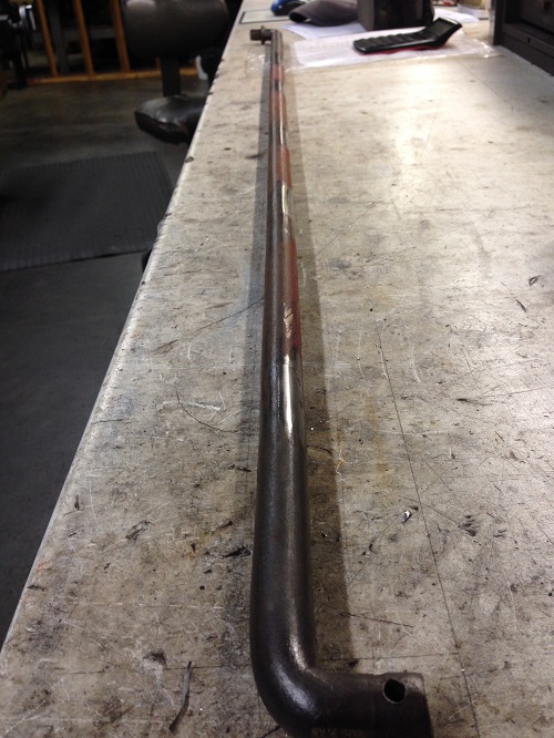

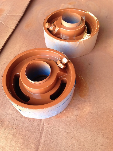

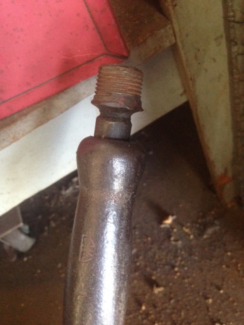

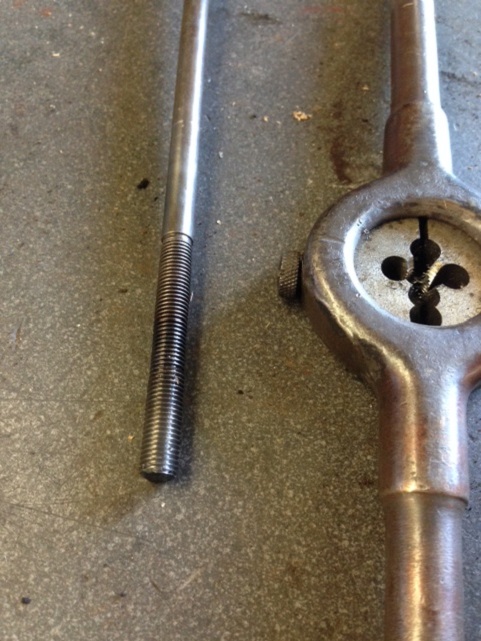

Got some brake material from McMaster Carr and made them too. The brake rod on one of em was missing a few threads so I ran a die up on it and welded it then ground it round and took die off.

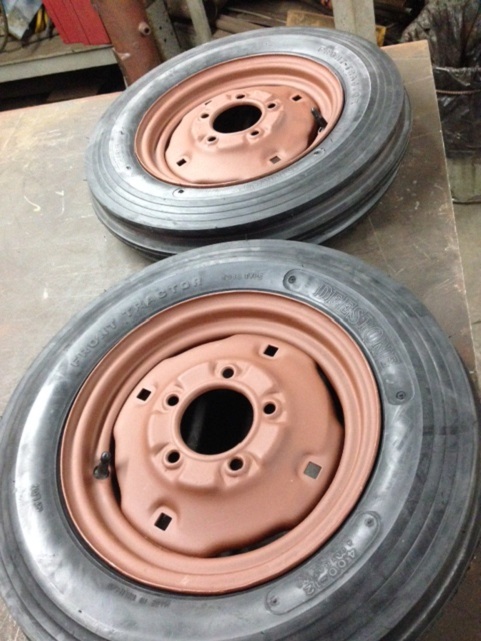

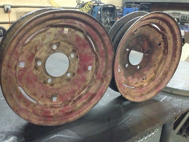

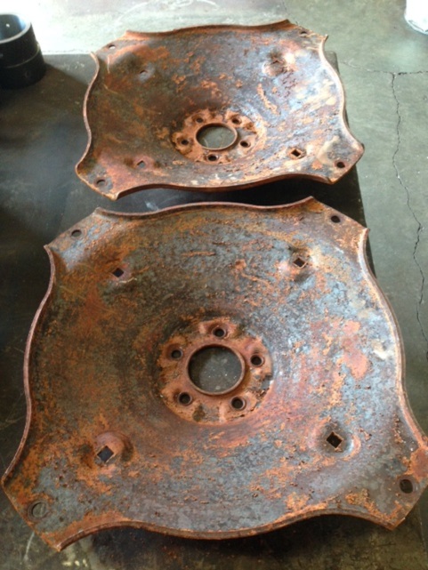

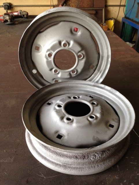

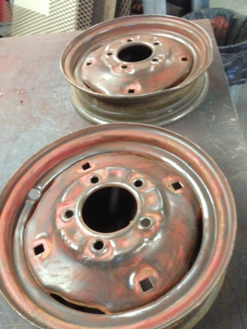

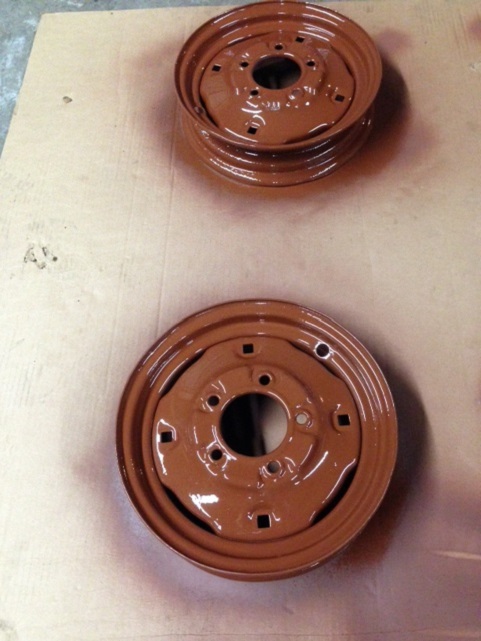

Straightened front wheels out where they were bent, wire brushed them & wasn't satisfied so sent them to sand blaster then burn off oven & primed them and installed new tubes/tires.

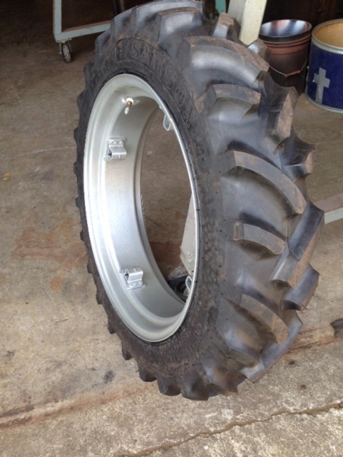

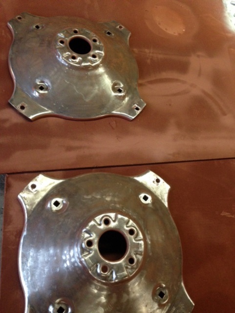

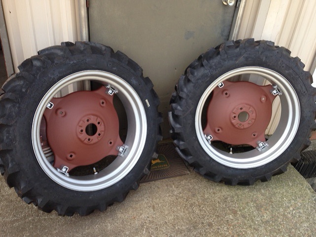

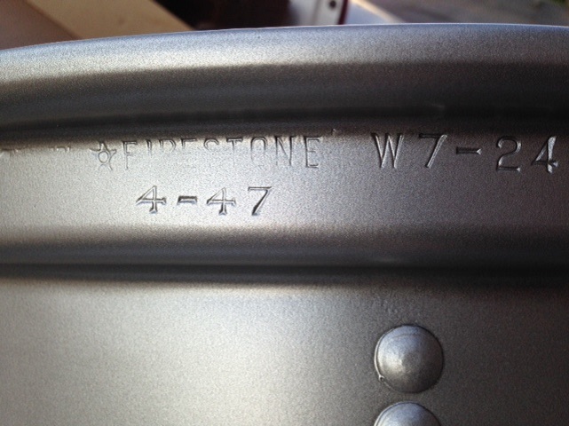

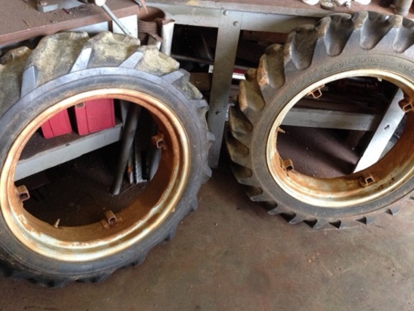

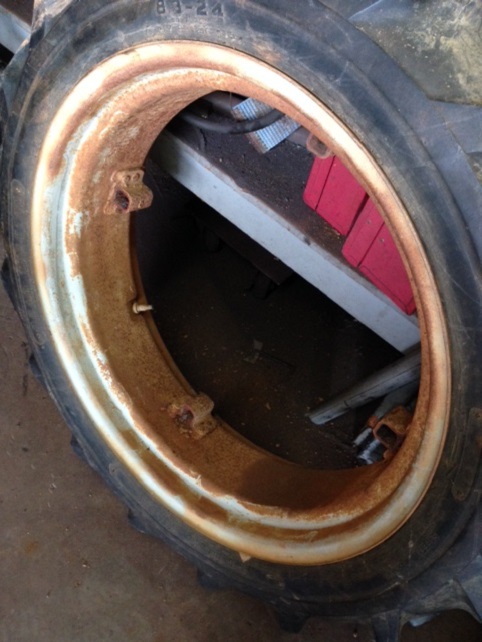

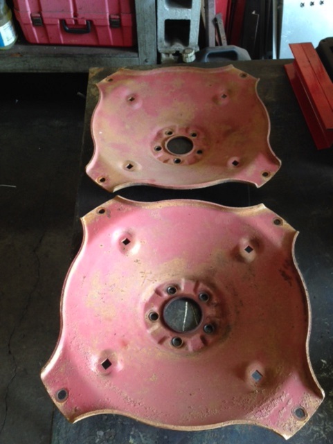

Took the rear rims to be burnt, blasted and powdercoated silver. Centers were burnt & blasted. Primed and new tires/tubes installed.

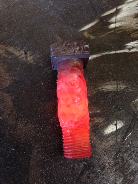

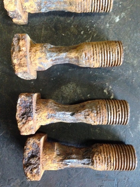

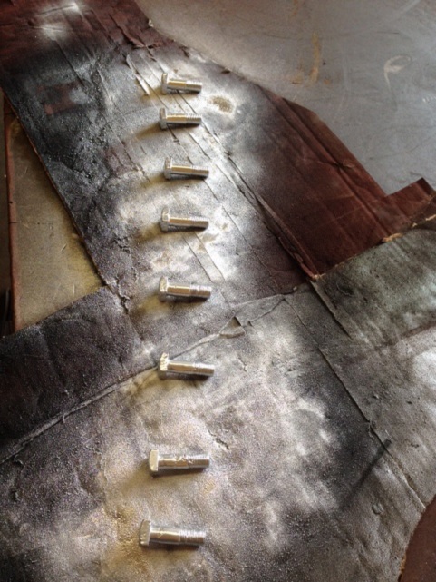

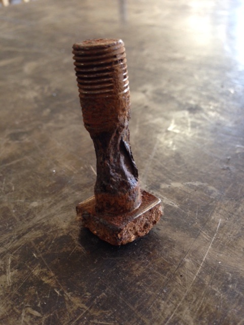

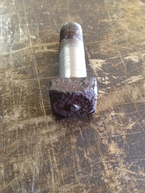

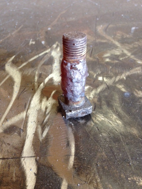

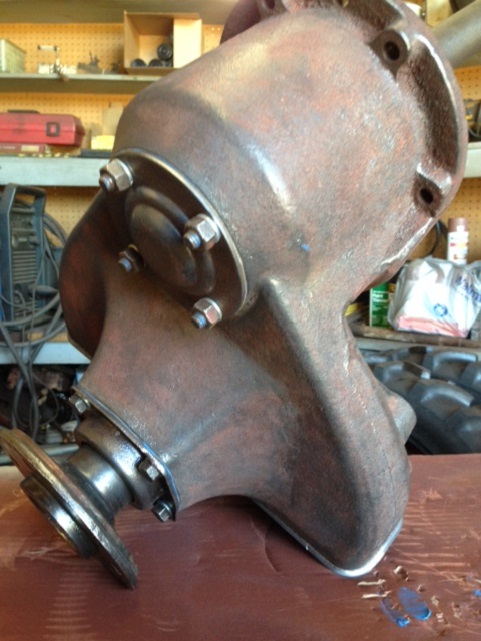

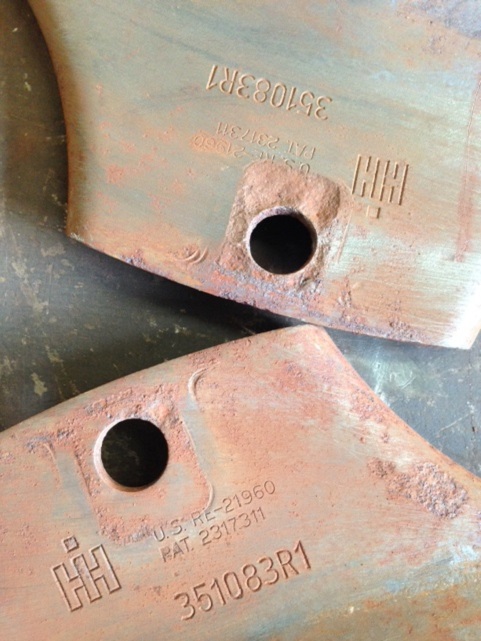

The rear wheel bolts were shot, decided to save them for the circle dot head.

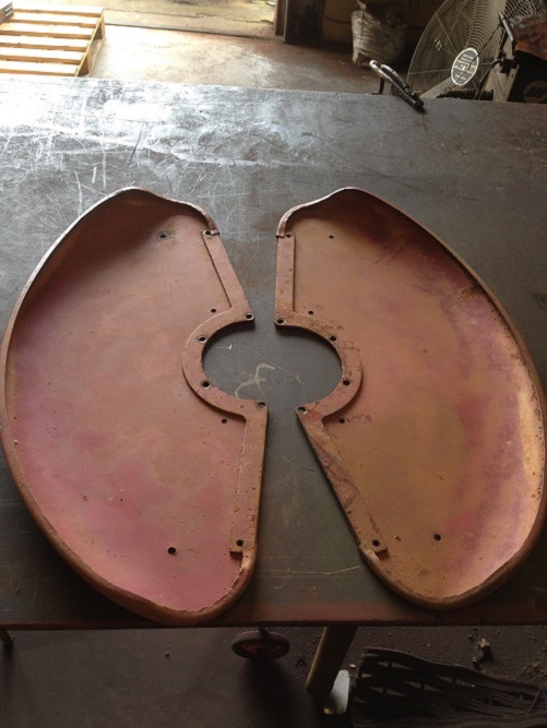

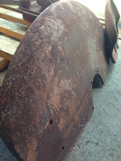

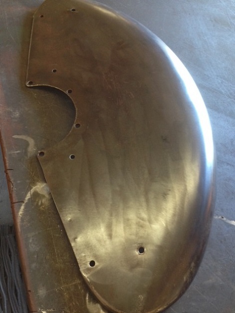

#9

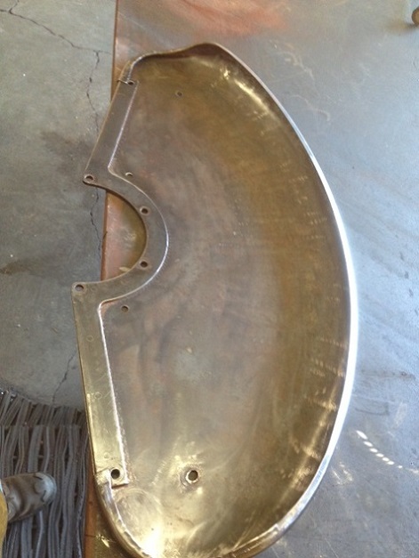

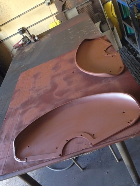

Fenders were in great shape. Had them burnt off then wire brushed & primered.

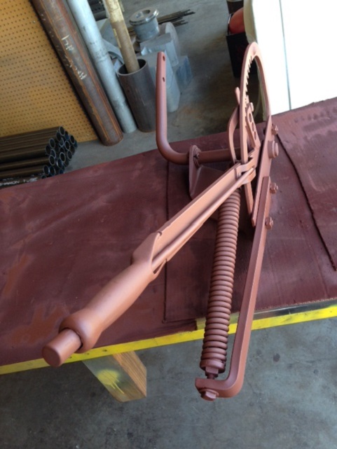

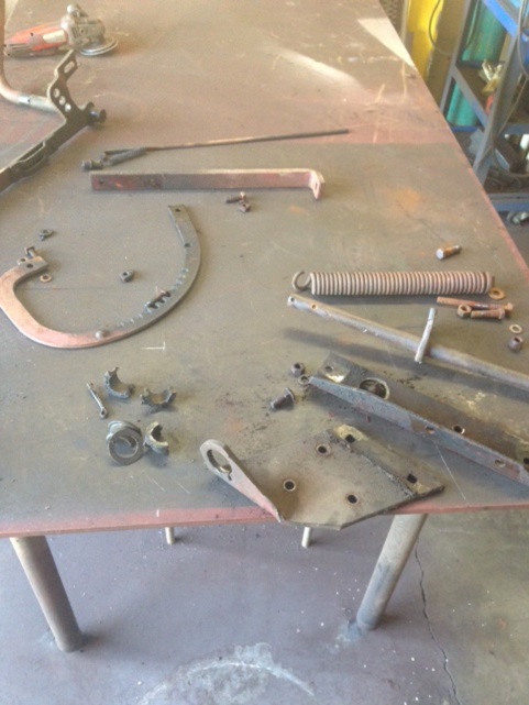

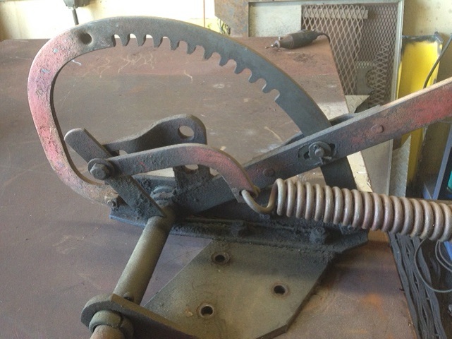

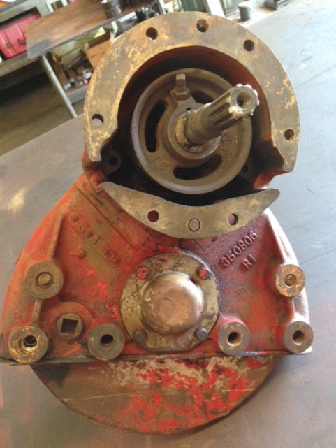

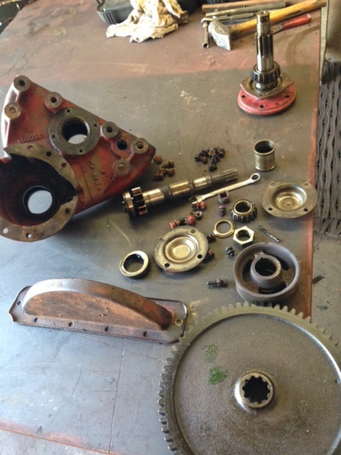

Rebuilt the hand lift and welded up some worn places etc.
