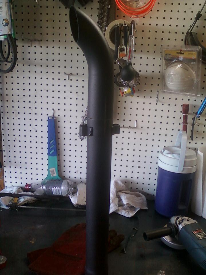

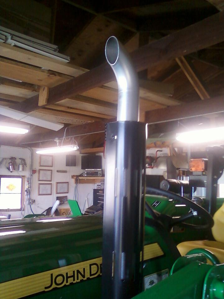

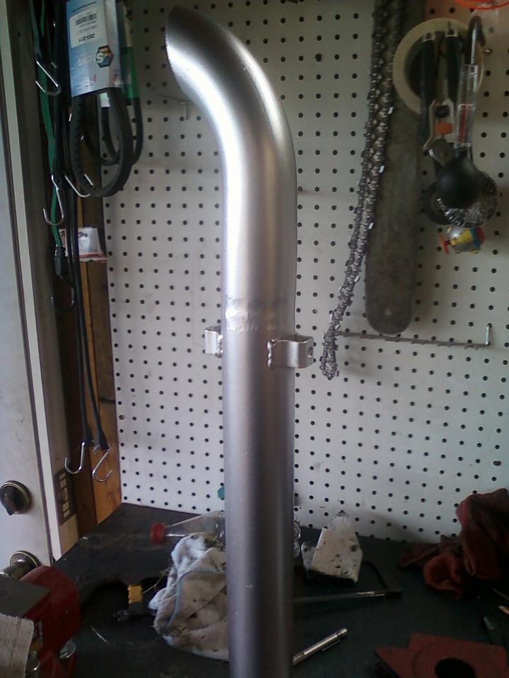

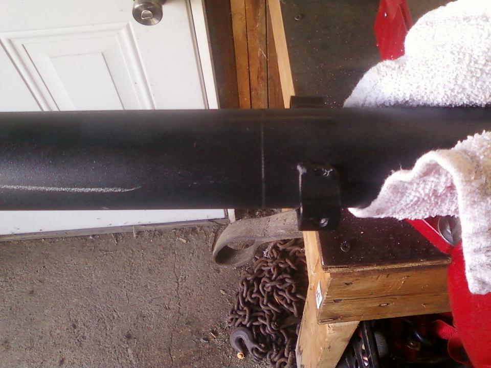

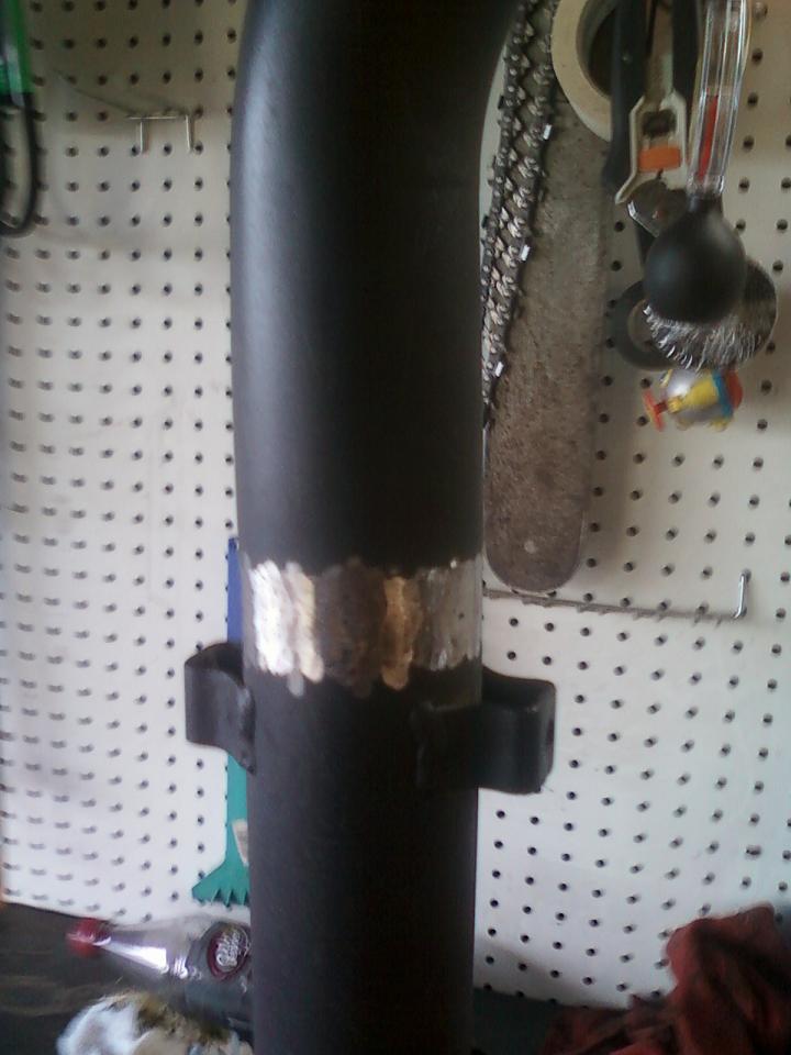

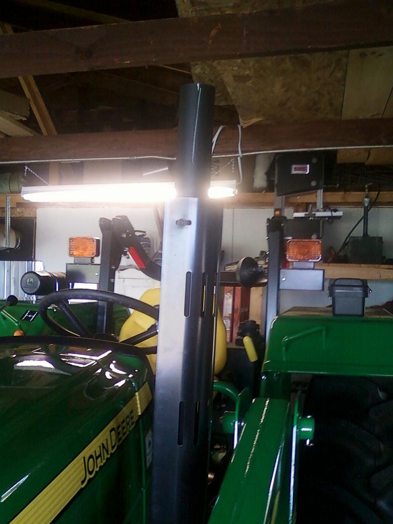

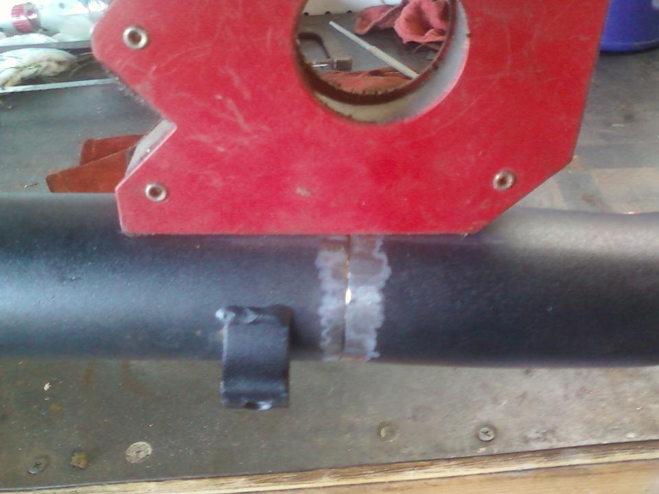

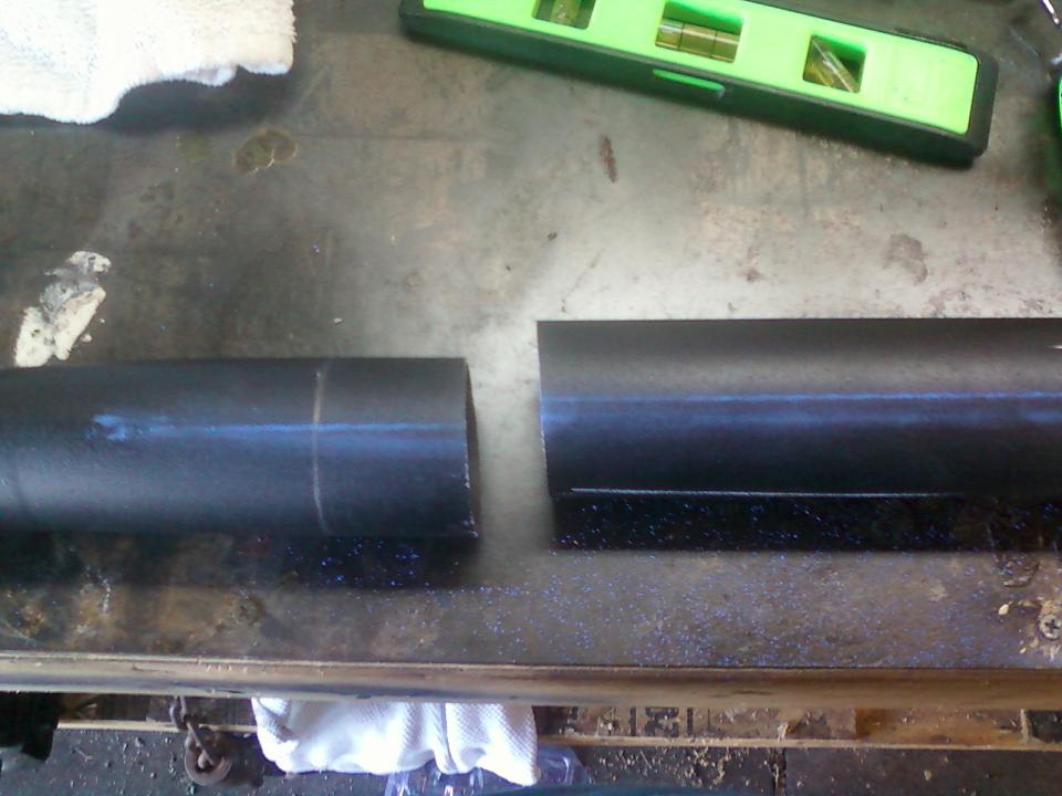

OK, so on the advice of Woodsmith, I got to work in the shop when I got home from work this afternoon, and cut the two pipes and rewelded them back together. Here are the results...
Here is the stack after my initial cut in a panic to get it in the garage and out of the weather...
The bend which was originally removed from the tractor...
The two pieces of pipe chalk lined for proper bend alignment after cutting and welding...

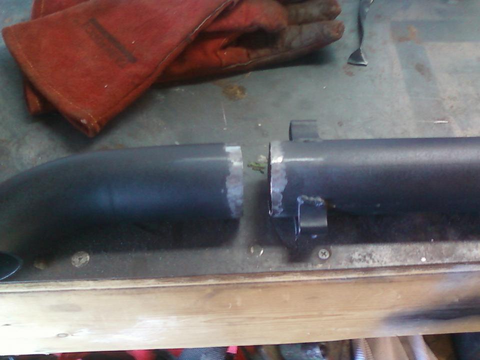

Tractor-side pipe ready to cut down to size...
Checking fit and alignment prior to welding...
Prepped to weld...
Ready to tack weld...
Welded and ground...
Coated in header paint...
Reinstalled from left side of tractor...
Reinstalled from right side...
I made the cut for the weld just above the brackets for the heat shield so that the weld would be partially hidden behind the shield, and I'm probably going to paint the pipe a final coat of high heat wrinkle black which will hide the weld even more...the silver header paint was all I had for the time being in the shop to coat it with...A BIG, BIG thanks to woodsmith for the idea...Even with the proper equipment, sometimes we have a brain fart that needs another's opinion. Everyone else's opinions are much appreciated too...

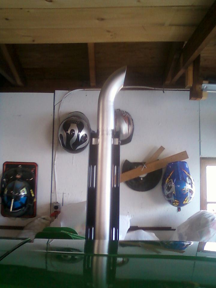

My new 5045D was born with a stack that's unfortunately about 6" too tall for my garage, and unfortunately, I needed to hack off the bend on the end of the pipe. I now have a short, straight cut pipe on the tractor, and I'm looking for opinions on how to proceed...Should I leave the pipe as is, with heat sheild in place, and put a rain cap on the pipe (ugly, but cheap,) or remove the heat shield and black pipe and replace with a shiny new chrome turnout pipe(More expensive but cleaner looking)...If I decide to go with the chrome turnout, I'd like to know if anyone has any online suggestions as to where to find one of the appropriate size, as this one's going to need a 2-1/8"I.D. X 24" long. Not having any luck finding that particular size in the usual online sources...any thoughts are appreciated fellas..
P.S. I'll post a pic of the tractor as is when I get home to get your collective creative juices flowing...:laughing:
Any good hot rod header shop should be able to bend a chrome pipe of any size you want. I don't think discoloration will be a problem on the cold side of the muffler. :thumbsup:
