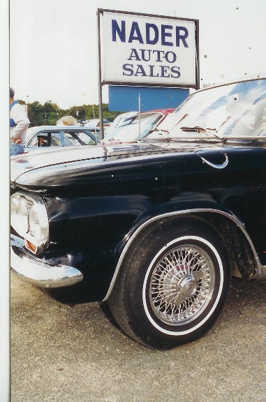

picture of my wheels....... The wheels and car are perfect.... the picture has lots of defects from dust on the lens..

Dayton probably makes new wheels that will replace those perfectly. Last time I checked, they were about $350 -400 per wheel for my Jag E-Type, Dunlop still makes wire wheels too, but the Avanti probably came with Daytons anyway........ Link to Dayton

Jagmandave . . . my wheels look identical to one of the photos on the Dayton website. I sent them an inquiry so I think I may be on my way to getting this car fixed up over the winter.
