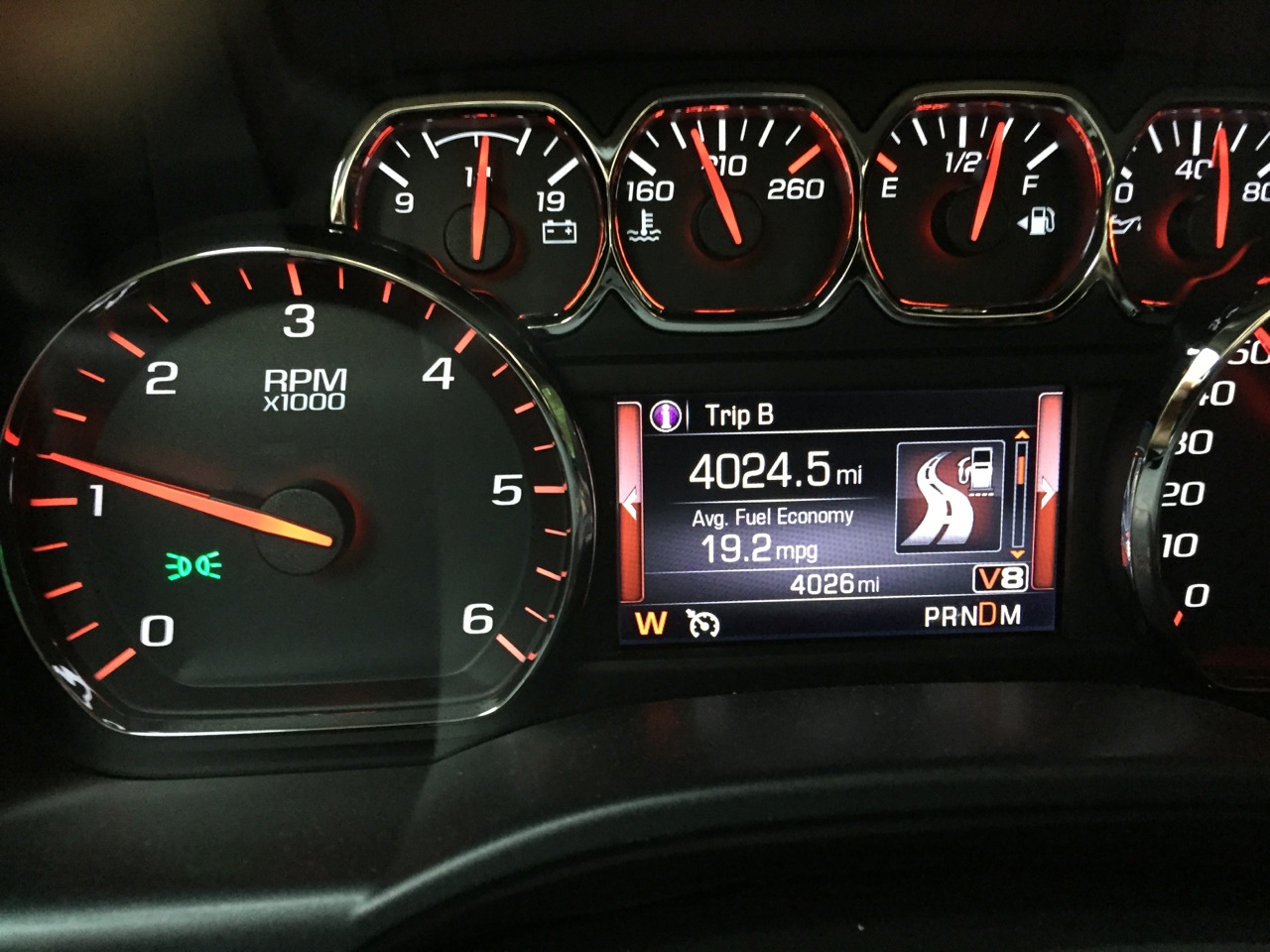

Just crossed 4000 miles with a 19.2mpg average. Truck is doing great and no problems at all. Been hauling a lot of building materials lately and glad to have the longer bed and V8. Last week, I pulled an electrician's van out of mud (sunk to the floorboards) at a building site down the street and glad I got 4x4!

Just crossed 4000 miles with a 19.2mpg average. Truck is doing great and no problems at all. Been hauling a lot of building materials lately and glad to have the longer bed and V8. Last week, I pulled an electrician's van out of mud (sunk to the floorboards) at a building site down the street and glad I got 4x4! <img src="http://www.tractorbynet.com/forums/files/trailers-transportation/395724-new-truck-img_4938-jpg"/>
19.2 is very good. That's a full mpg higher than my Ecoboost, its average is 18.3. It's a Super Crew FX4 with 3.73 gears.
Have you hand calculated a few tanks to verify the dash? My ford is never off more than .2 mpg, so it's very accurate.

That's dam good millage for that steep of a gear. What trans you have?
/ New Truck #40
I purchased a used 2012 Silverado at the end of August the average on the display is sitting a 16.5 after I put on around 5000 miles. Which is within a couple of tenths of what I have been hand calculating.
