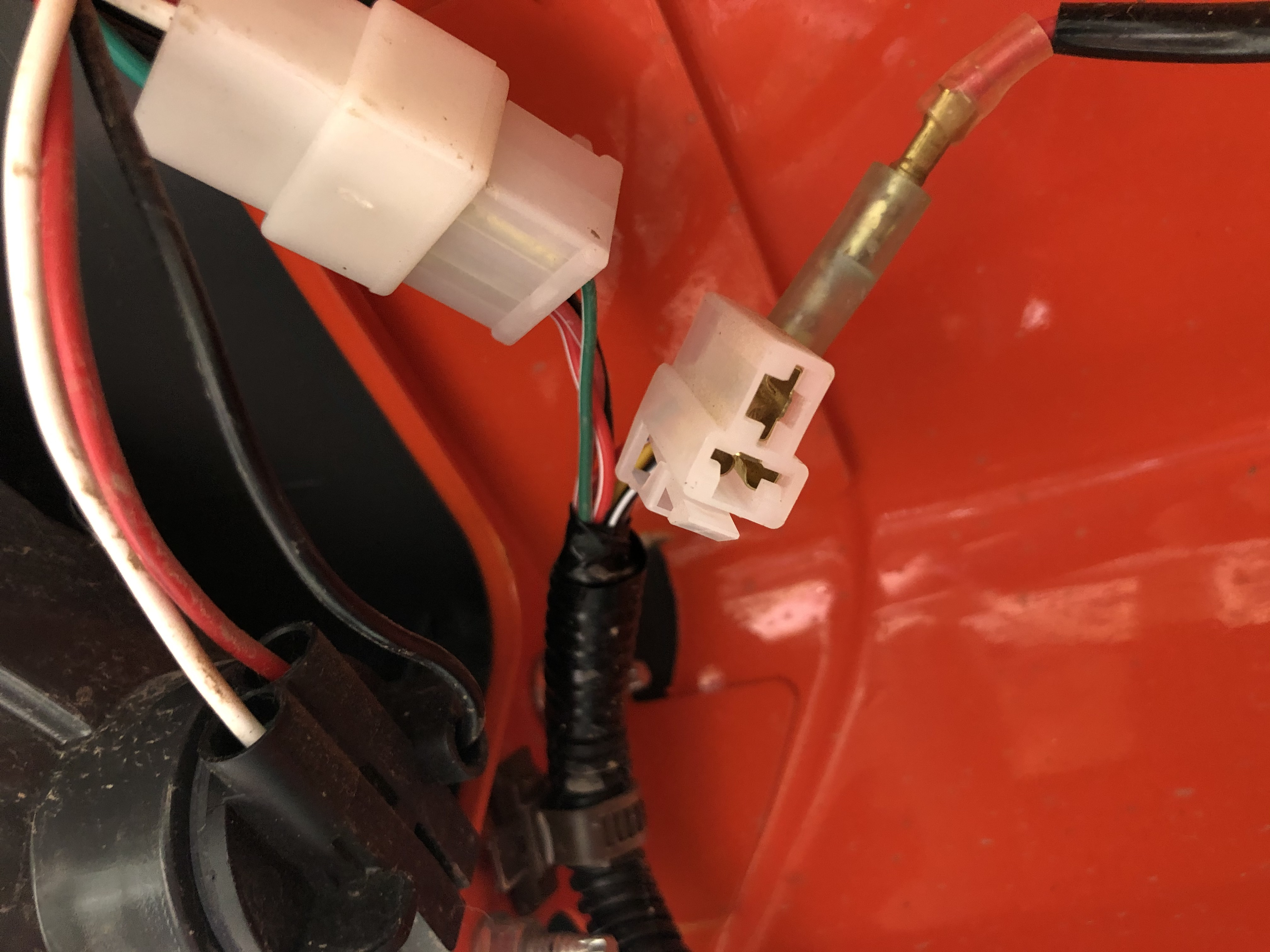

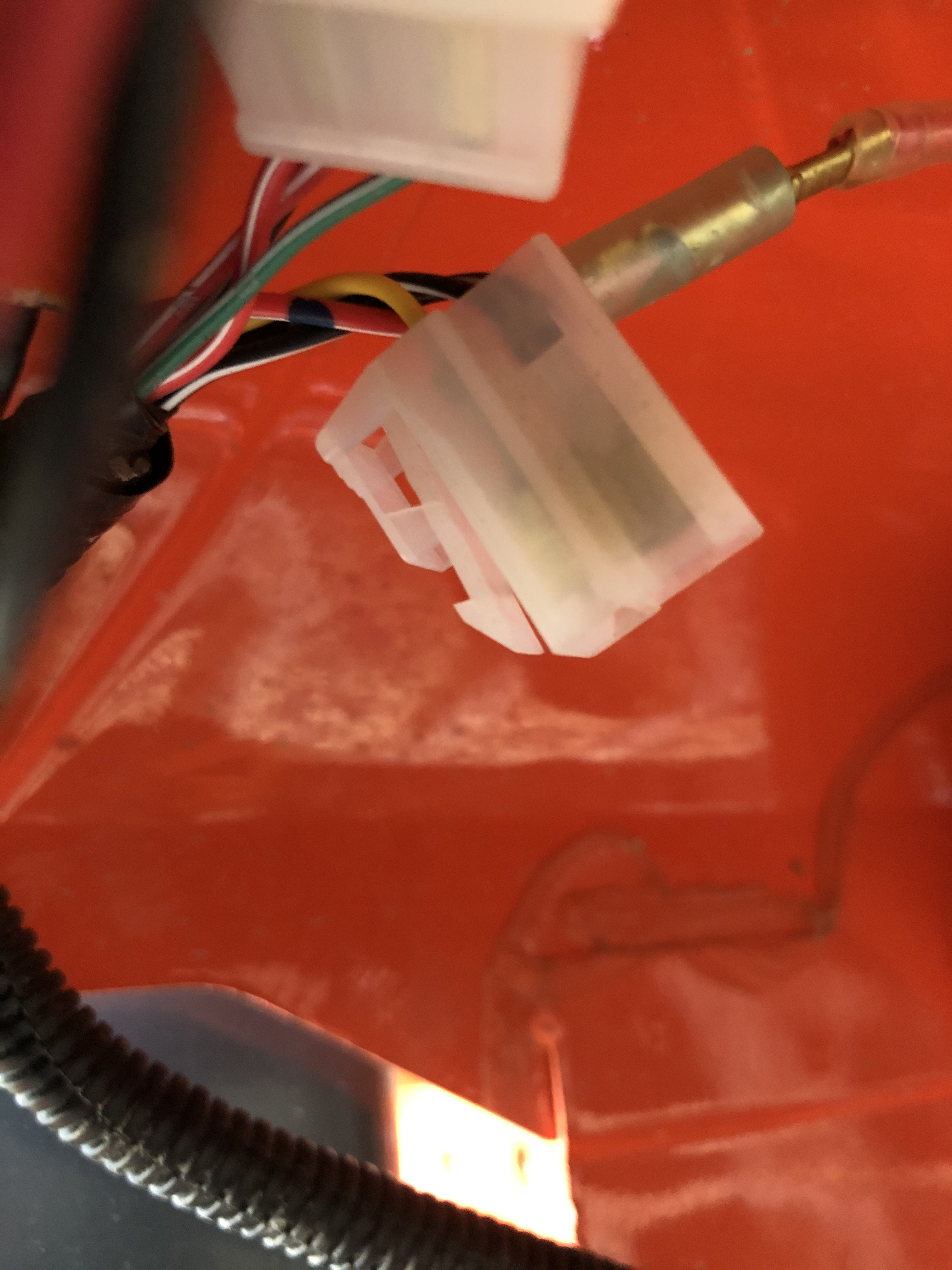

If you can find the right connector and add on the end of the leads you plug into that. If not, I just added and crimped a quick connect female and male and plugged them into the existing terminals.

Thanks. That is helpful. Are those photos of your completed job? Or are they just showing me where to plugin?

Tractor is 35 miles away. I don't have completed pitures from the project. I took before-pictures to see what I was planning and tried to make sure what I would need.
