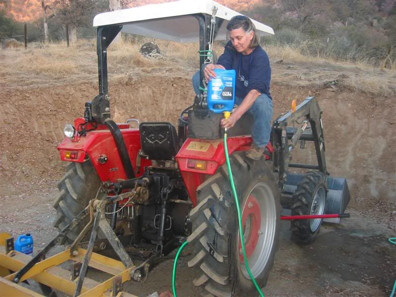

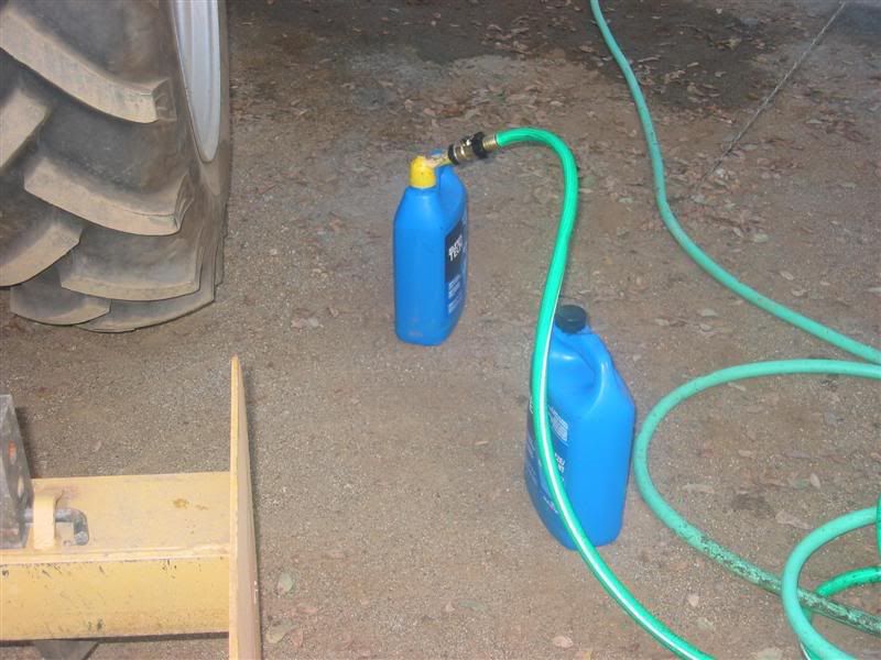

I filled my tires about a year ago with anti-freeze and water. Napa sells a couple of alternative filler tools that are very inexpensive. I'd reccomend getting one that allows you to siphon a bottle of antifreeze while adding the water. I think it's like $14 bucks or so? Anyway, I did not use one, instead there was a "cap" at Pep Boys that scews onto the anifreeze bottle and I poured 2 gallons into the fronts and rears. Out where I am in CA it does not get that cold....rarely under 32°. I filled the fronts completely to top of rim and tried to maintain the weight distribution between fronts and rears so I did not fill the rears all the way to the top of rim....just shy of it. Now, a year later, I realize I could have filled them up and it would probably not have made much difference.
Anyway, I used the Napa tool to do it and it took a couple of hours to do all of them. Longest part for me was pouring the gallons of antifreeze...adding water went fast. Here's a thread I did mine in... it might help a little bit?

How would one start a siphon from an anti freeze bottle into the tire? Not challenging; just asking.
Much like a paint sprayer or pesticide sprayer or liquid fertilizer sprayer. Like I said, I used the cheapo tool (about $4.95) and poured the antifreeze into the deflated tires. Actually had Mrs. 3RRL do it while I drank a beer.
I thought I had seen a tire filling kit that had the siphon hose for it? I thought Napa sold them? Maybe it was the hardware store? Anyway, anything like that ould work. You put the hose in the antifreeze bottle and the unit is attached to the garden hose. Turn it on, both go in. I'll try to find a link.
