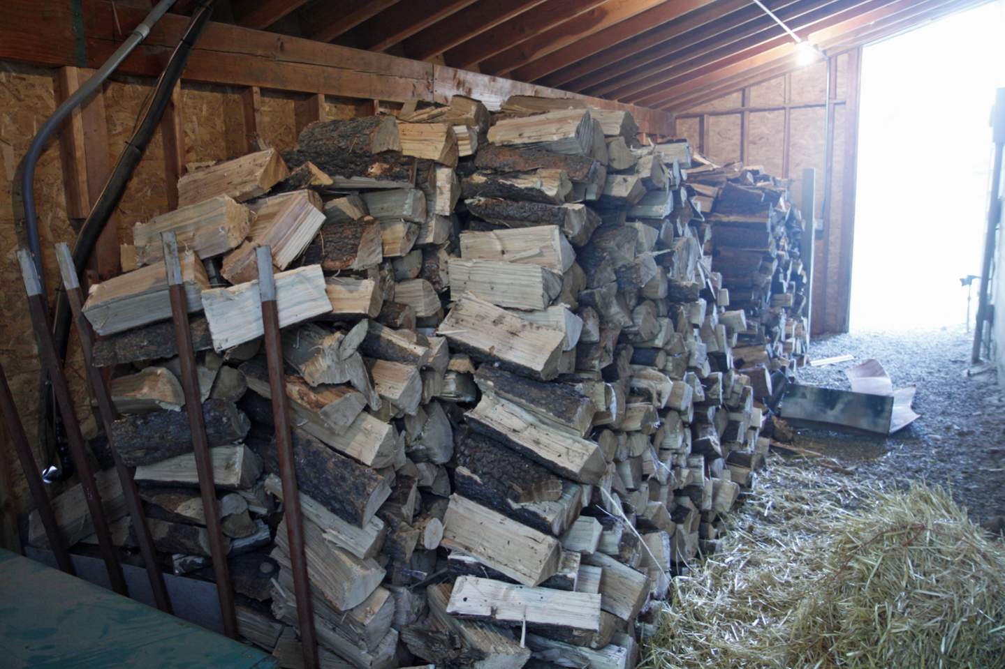

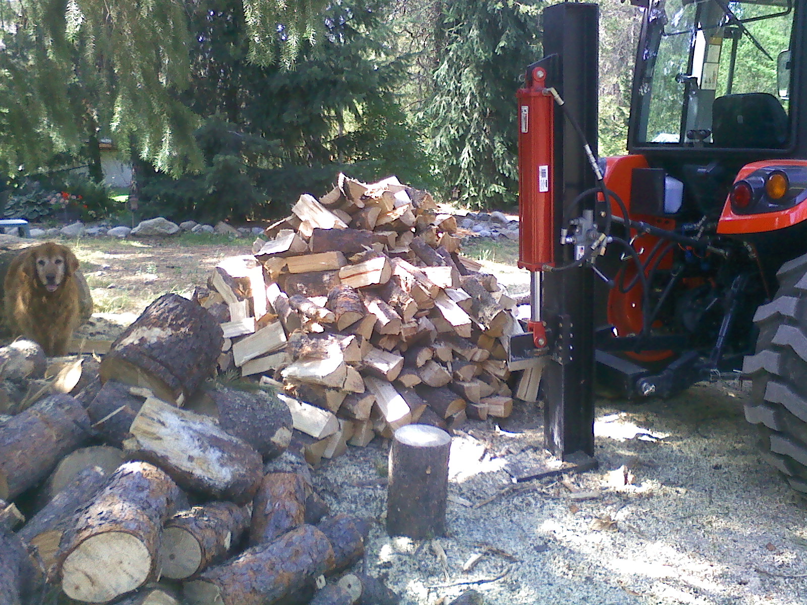

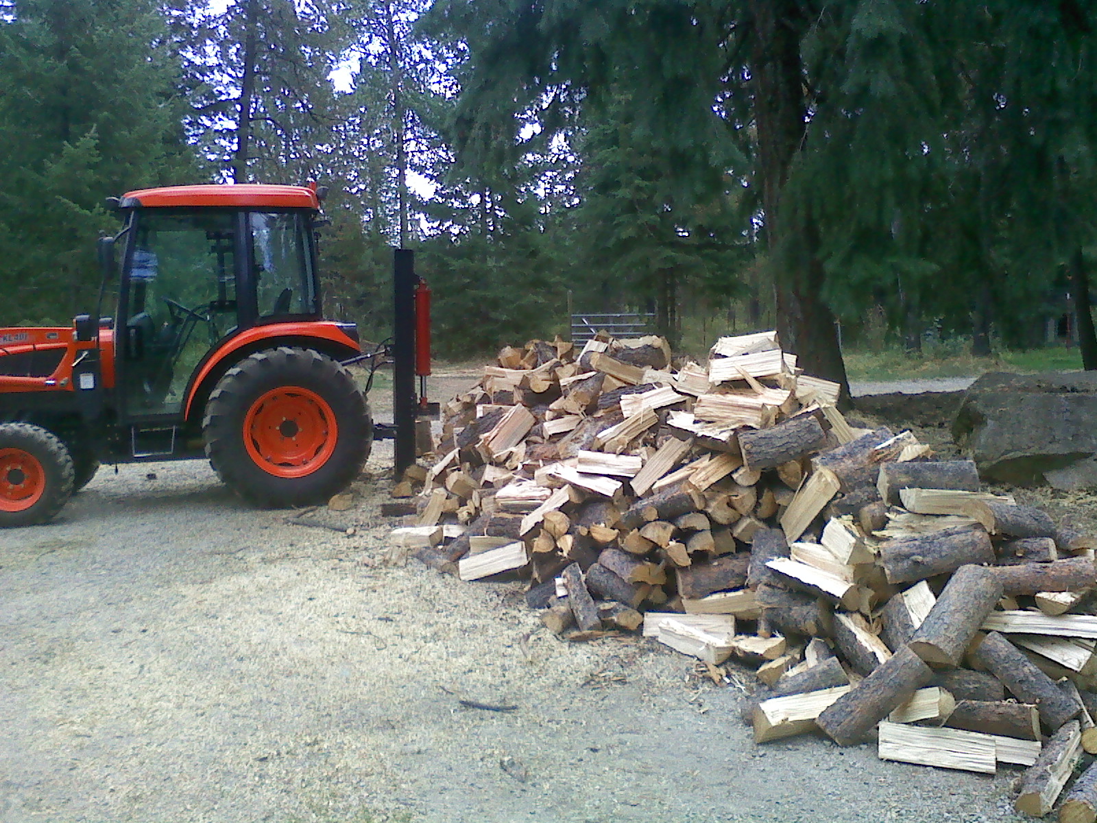

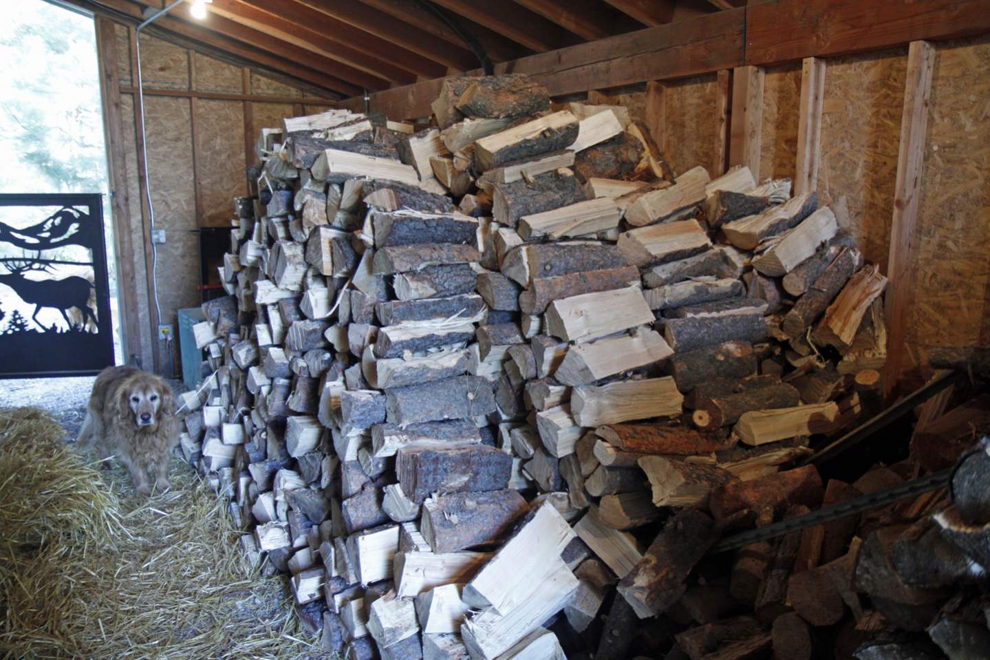

Spent a few hours splitting the pile of wood, then a whole Lotta time hauling it and stacking it in the wood shed. It these times where i wish i had some prison labor...and or kids... to help out. I'm getting too old for this c***. But this is more than enuf for next season. I already had this seasons wood put away last year.

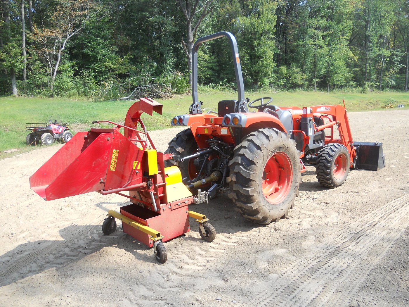

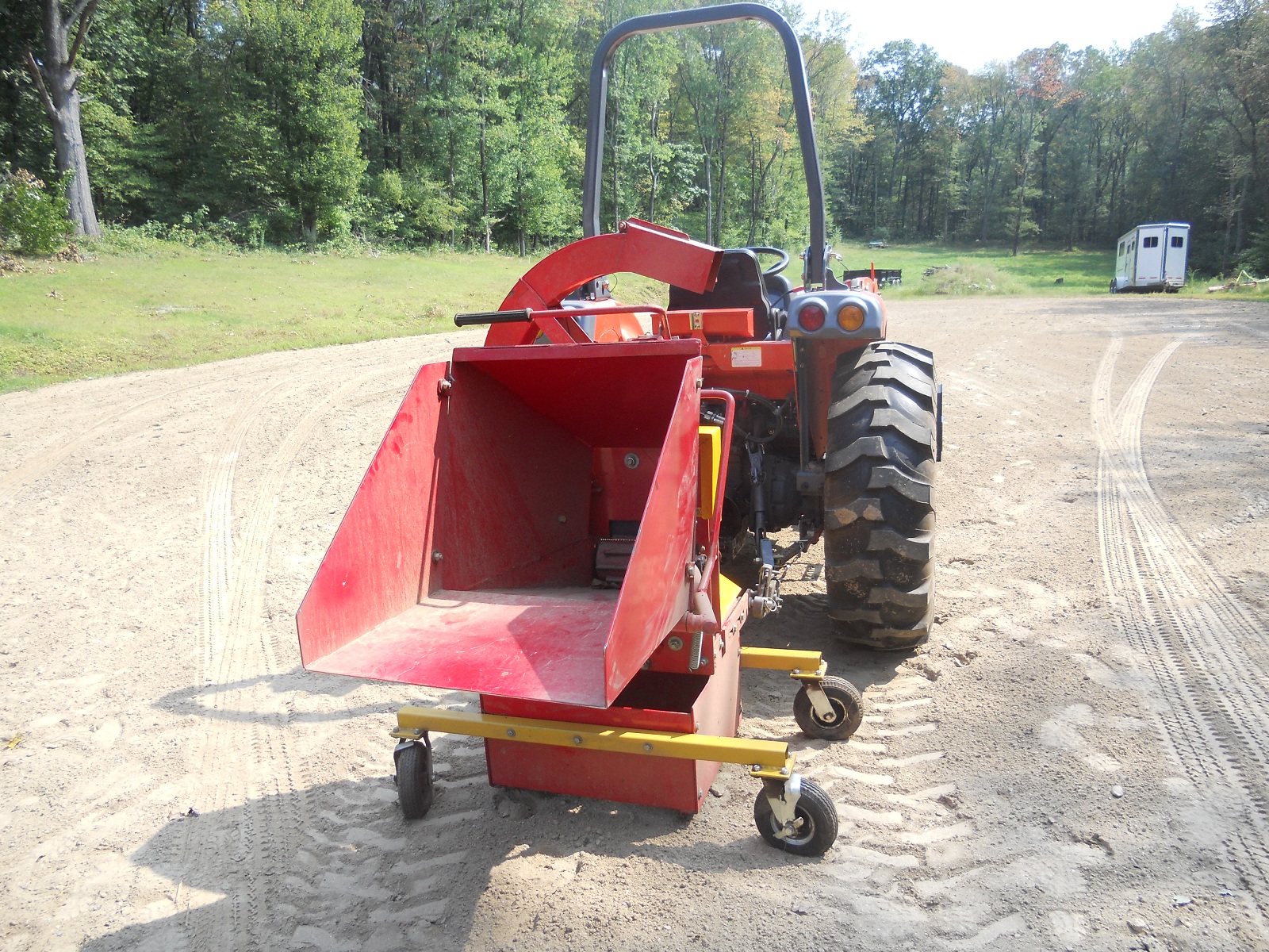

Finally fixed the short drive shaft problem and got my Jinma chipper hooked up to the Kioti. I almost forgot that I had an almost new PTO shaft for a brush mower that I wasn't using. I had to get a new splined universal yoke for one end at TSC. Put it on and now it works like a champ. Chipped up all the branches I had from the tree I cut down plus the storm damage.
One problem I noticed was that the feed drum tooth bars need to be sharpened or somthing because sometimes it just sits there over the branch and spins and won't pull it in. The downpressure from the springs is good and strong but it doesn't seem to pull the branches in as good as it used to. Anybody else had this same problem? What did you do to fix it?

I have the same chipper and have had good luck with it as well have you jammed it up yet when it happens just break the fly wheel housing and remove the chips not a big deal I use mine with a 40 HP Kioti and this week end used it on some small stuff with my 1520 ford seemed to work ok I was wondering if the ford could spin it only 25 HP good luck

Hey Johninct,
I have same chipper, it's been great,
I took out the feed drum and cut much more aggressive teeth in the feed roller tooth bars with a mini grinder with a cut off wheel, it works 300% better for feeding ,,, pulls the stuff right out of your hands
