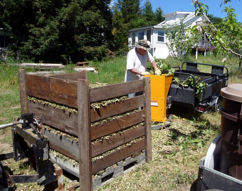

So true! I bought the HF $350, 5.5hp shredder to shred pruning debris. If you can cut your stuff with loppers, this will shred it. But as shown here, everything has to go in the top.
Also the discharge is straight down. I keep a wide grain shovel there to toss the material into my mulch bin.
This shredder starts easily and has plenty of power but the ergonomics, the user convenience, isn't as good as a more well-thought-out unit.

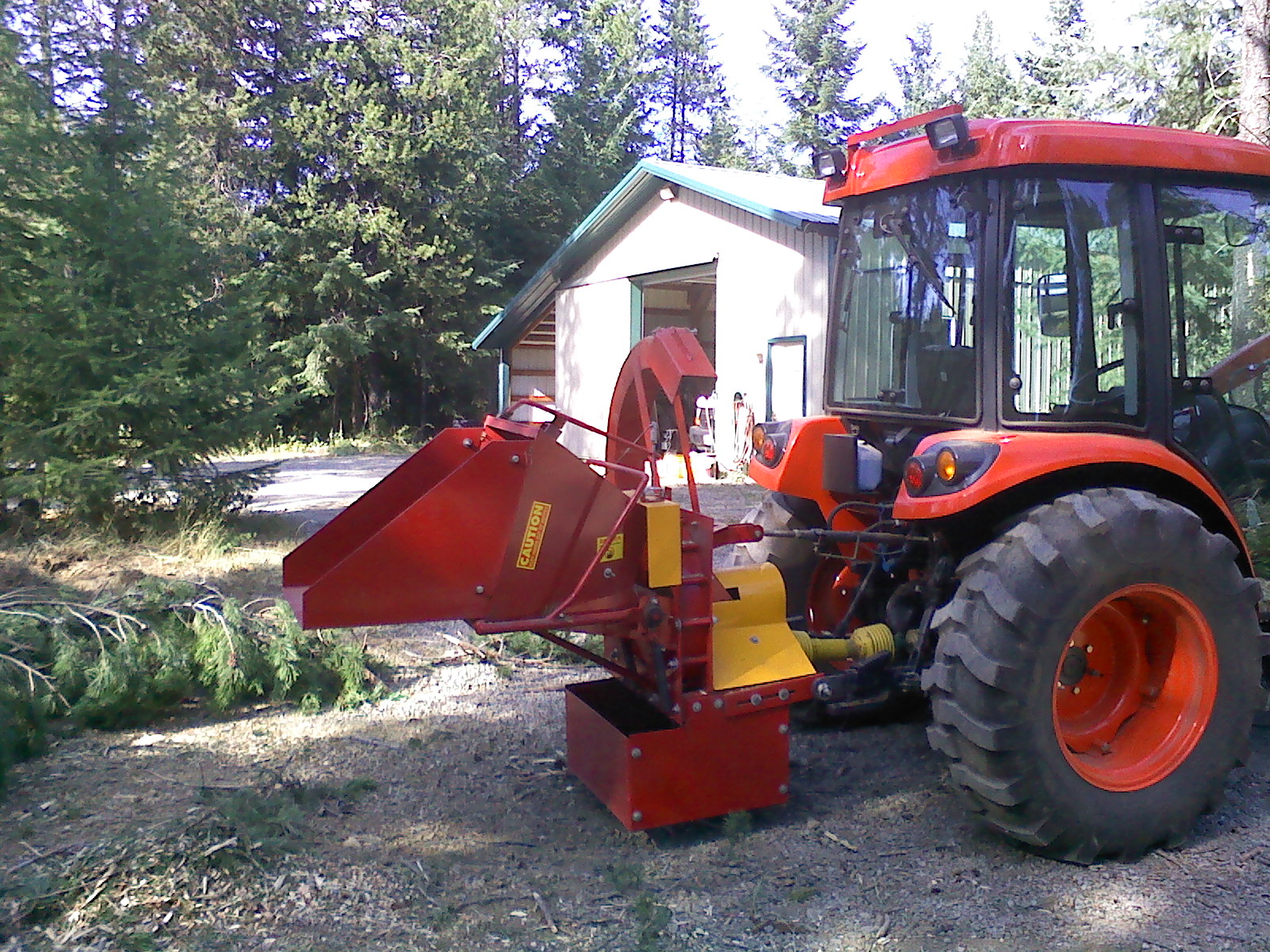

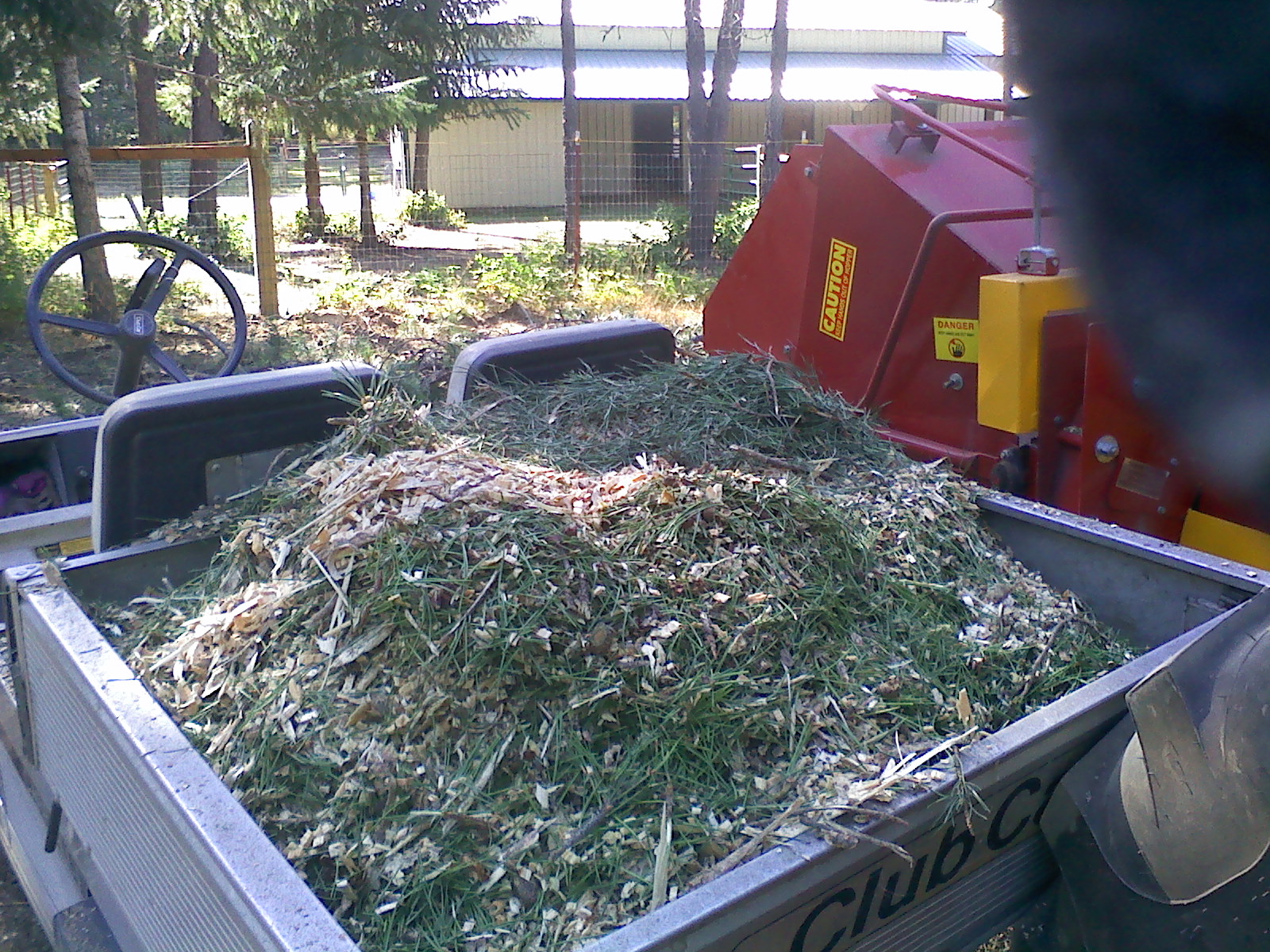

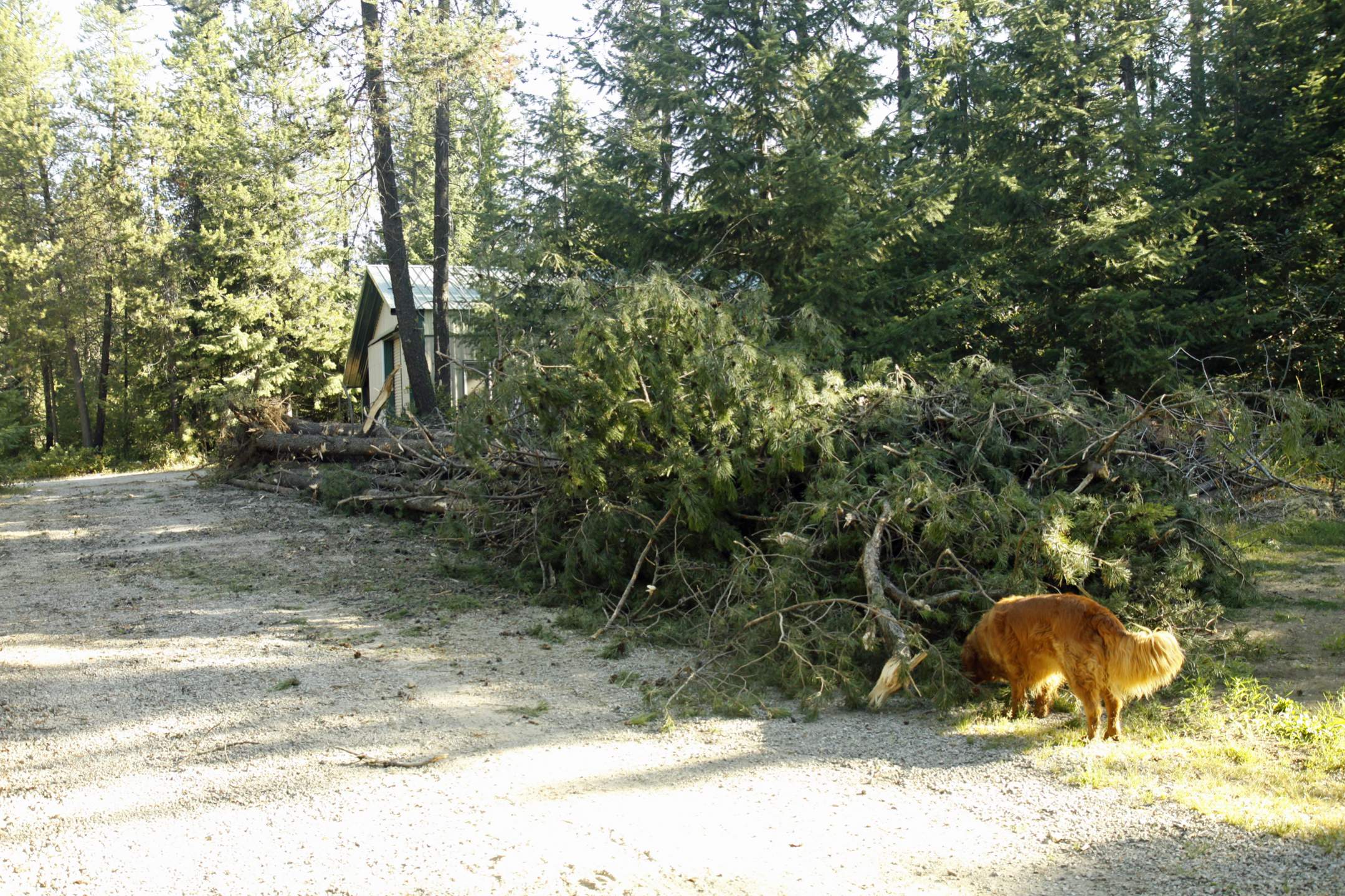

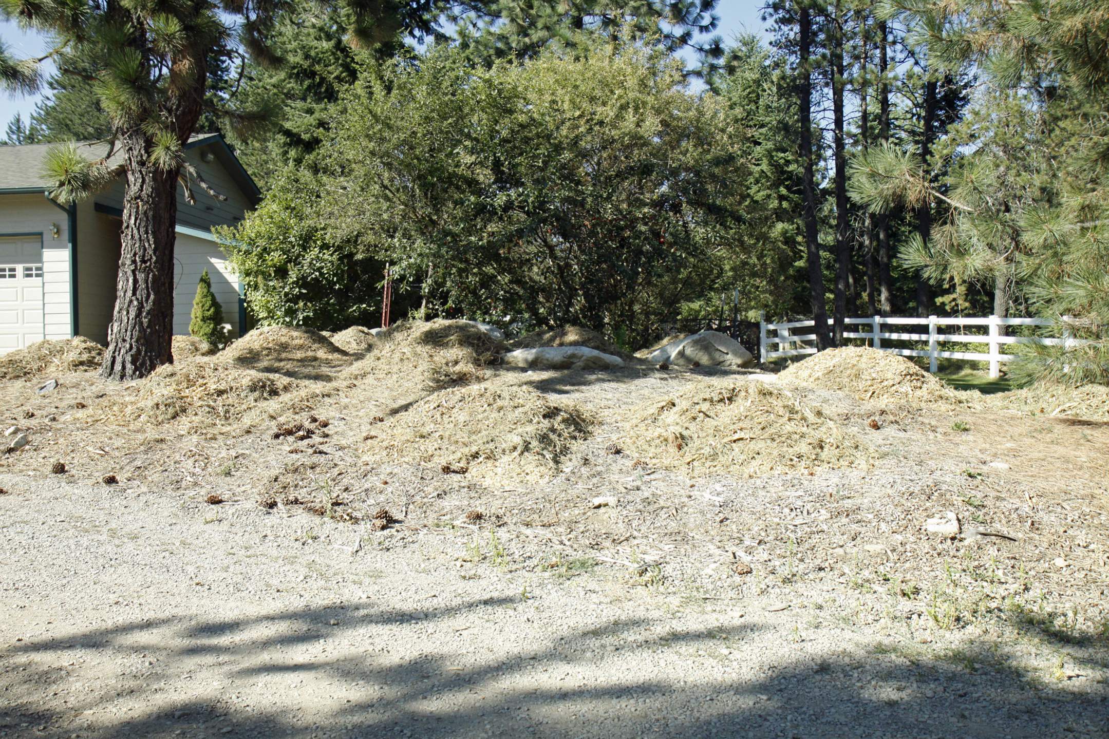

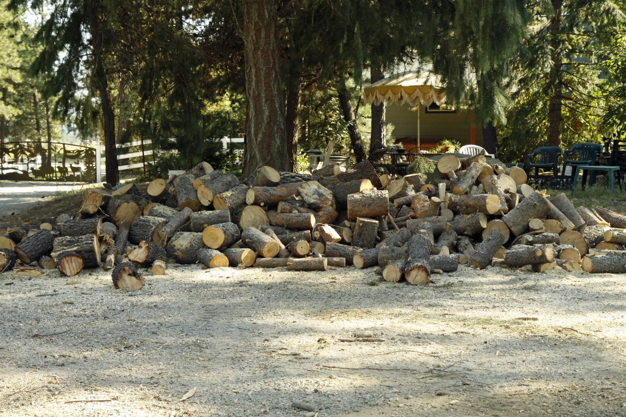

/ Chipper #7
I have a Jinma 6" PTO powered chipper that i used for 3-4 seasons on my JD870 (25 HP pto) tractor without any issues. I hav now used it for 1 season with my 45HP Kioti.
I have never had an issue with this chipper. Its Chinese made, but very good qiuality 1/4" + steel everywheres.
Handles 6" fir/pine/aspen without a hitch
Though i generally keep anything over 4" for firewood. It doesnt have a hydraulic feed, but does have a belt driven feed and a chute to direct chips.
I believe i paid about $1,200 incl shipping. I use it alot, have 20 acres of trees to maintain. Since getting this i no longer have burn piles.
