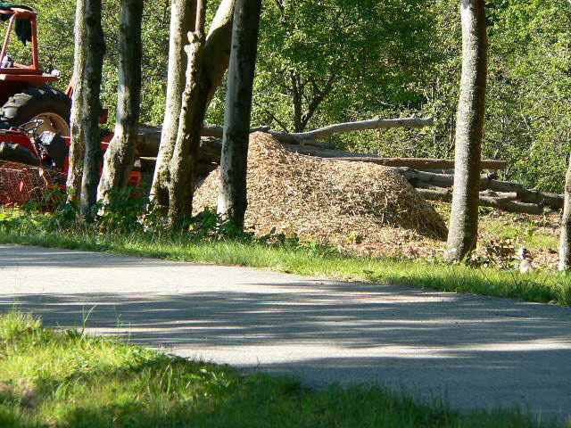

Congratulations! I spent a good part of the weekend feeding my Patu chipper and spreading chips over the asparagus and blueberry patches. The Patu came to me by way of Craig's List. When I got it home I used it right away and was somewhat disappointed with the performance - I had to push everything into it. With some good help from TBN members, I secured an owner's manual .pdf and the next weekend opened the chipper up and reset the knife feed depth (chip size) and knife to anvil gap to nominal specs. It was like a whole different machine. Draws very nicely now.
Long winded, I know. Point is, give it a good going over, check the blades and adjustments and give the bearings a good squirt with the grease gun. Then go have at it!

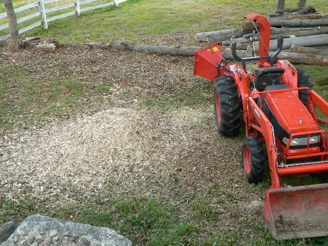

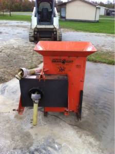

Had a chance to use the chipper today - wow! I'm impressed. The tractor ran it with power to spare - it barely lost rpm even on big hard stuff. I ran a few limbs that were at least 4" and hard and dry. They needed a little pushing through, but it chipped them right up. I found that pretty much if it will fit in the chipper, it'll chip it, period.
I do think the blades need sharpened though. I felt the edges and they had a few nicks in them. Does anyone know if they are reversible?
I'm not as impressed with the shredder, as the pieces that came out were rather big. I think I'll try getting some steel grate and making a smaller screen for it - seems like that would keep the big stuff in there and let it get shredded more finely.
Anyway, thanks again for all the suggestions and advice everyone!

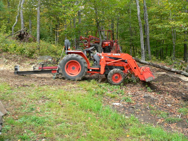

I have a Patu. It's a direct drive off the PTO shaft. PTO shaft has a clutch. When it's engaged it's as if it isn't there. I am really surprised at how quiet it is. Running full 4" diameter maple limbs thru it doesn't seem to put any load on the 26 hp PTO/engine. I have just finished chipping all the branches from three 24 to 30 inch DBH silver maples that I had to drop after the big wind we had in August. Fed in everything 4" and under without any clogging.
If I could hitch it up to the B5100, I'd be interested in what size I could run through it with just 10 hp at the PTO. Hitch geometry & PTO shaft length makes this difficult. A recently delivered 40" tiller with PTO shaft for the B5100 may provide an oportunity for another try ...
If this chipper hadn't come up on CL, I was in the process of getting spending approval from The Plant Manager to plunk down some green for a Wallenstein BX42. That's one nice looking chipper. I really like the enlarged/rectangular feed chute. I suspect it would reduce the amount of trimming I have to do prior to chucking limbs into the Patu. Some of the limbs were so twisty and gnarly they looked like they came from the trees in The Wizard of Oz.

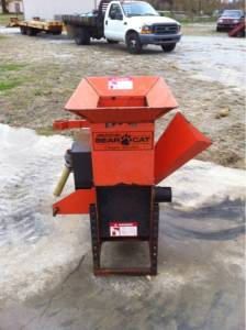

Hey guys, I've got another question about the bearcat. I've done a lot with it already and love it. I really need to do a little work on the shredder though. The previous owner must have had it in a place where it got wet occasionally, because there is a fair amount of rust in the shredder parts. Quite a few of the knives are stuck and wont spin freely like they are supposed to. I thought running some branches through it would knock them loose, but no such luck. Actually what looks like happened is some of the double knives have spread and gotten stuff jammed in between them - thus spreading them and seizing them.
I'm trying to take it apart so I can clean them all and loosen/lube everything. Problem is, I can't get the rods that the knives are on to come out. I took keeper bolt out and have tried knocking the rod out with a punch, but it's not moving. Have any of you taken yours apart? I'd like to take the least destructive path, but I guess worst case scenario I'll have to torch them out and buy new ones. Any help welcome!

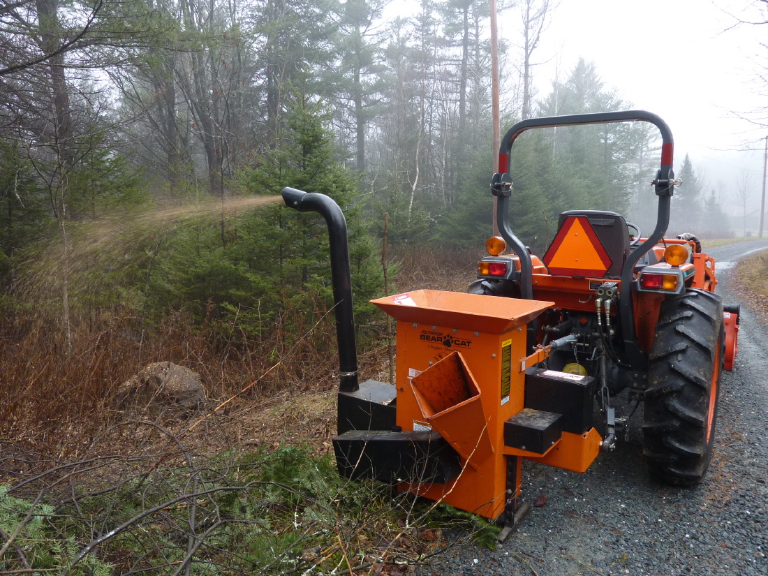

Not sure what you are referring to. Is it the short 3" (or so) six knives that are on each shaft that will not turn? It would seem that a soaking of penetrating oil and a hammer would break them free.
If the knives are jammed somehow they will not let that rod come out. Maybe a photo to compare to the one posted below would lend some light on the subject. Others may be able to give a hint.
BTW, try to keep rain from going down the chute to avoid rusting problems. A tarp works just fine.

Yes, it is those knives. They are a little different than yours - mine are more like sickle mower sections. I thought they would break loose with a hammer and penetrating oil, but it's not that they are stuck, they are just really tight. I can move them with a hammer, but they need to be loose. I think the knives being jammed is what is keeping the rod from moving. Hmm...I may try a little heat, but just don't want to damage anything. Any thoughts?
Yes, I keep it in the shop out of the rain, but evidently the previous owner wasn't as careful.

Oops, I forgot - here is a picture of it.
