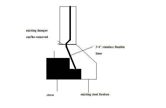

I like to do things myself but, I thought I would let a pro place a stainless liner in my chimney for a new pellet stove that is until I took a half day from work to wait for him to see what he needs to do the job didn't want a quote or nothing just the job done and he didn't show. So I'm going to do it myself but have a couple questions <ul type="square"> [*]1. Will the attached diagram work as far as the bends in the liner? [*]2. Installation guide calls for 3" for up to 15' EVL (equivalent vent length) mine is 19' EVL so it recommends 4" vent but, 4" won't fit between the existing heat tubes. Anyone see using 3" a problem or if the 4"can be ovaled to fit? [*]3. What is the blanking plate used for that needs to be fabricated to seal the firebox off from the flue with a hole only large enough for the vent to pass through? [/list]

What software is needed to open your document? What product is this that you plan to use?

The Blanking plate blocks drafts from the chimney.I think it should be made of metal.
Check with the stove man. for the size of vent pipe for the difference you have. Again I think the 3 inch may work.

I'm new to this posting thing what I did was drew a sketch in MS paint and the file was to large to attach so I made it into a zip file and of course it worked for me because it's saved to my hard drive so if you or anybody else has any suggestion's throw em at me

I'am in the hvac plumbing business,and I can tell you that I always go by the manufacture installation instructions.Engineers designed & tested this to work as it states in the installation instructions.In my business if you stray from these instructions & something happens ,LOOK OUT ! I'am liable ! /forums/images/graemlins/blush.gif

I'm with kenmac, I've installed 2 wood stoves, complete, and around here at least, the mfg instructions are the "code". So when the inspector came out, there was no UBC or anyother source governing the installation but the mfg. FYI, I'm not all that big on permits and have my share of bootlegs but, when it comes to wood burning appliances, if I don't have a permit for it, and it causes a house fire, my insurance won't cover it. Not sure how things are in your area. Good luck with it.

I converted your bitmap to a GIF and reposted it - less than 1% of the original size.
Next time you can just pick ".gif" from the "Save As Type" box when saving the picture in MS Paint.
