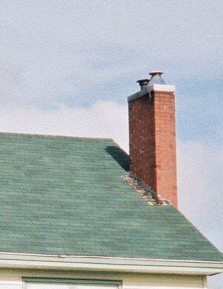

On our house we have a double clay flue brick chimney. One flue has the furnace. The other flue has a stainless steel insert for the fireplace insert. The chimney top has a stainless steel cap that covers the entire top of the chimney. This cap has in turn two other round stainless steel flue covers with their own cap. This pretty well seals off the top of the chimney.:D
If the leak in your chimney is from the top the silicone would be the easiest solution.
You could also consider forming up some corrosion resistant metal covering [metal cap] that will extend down and around the top sides of the chimney.
Another approach may involve laying on layer of metal mesh reinforced mortar but this method may be subjecting to cracking as the original has done.:confused::confused:
The attached picture of our chimney.
