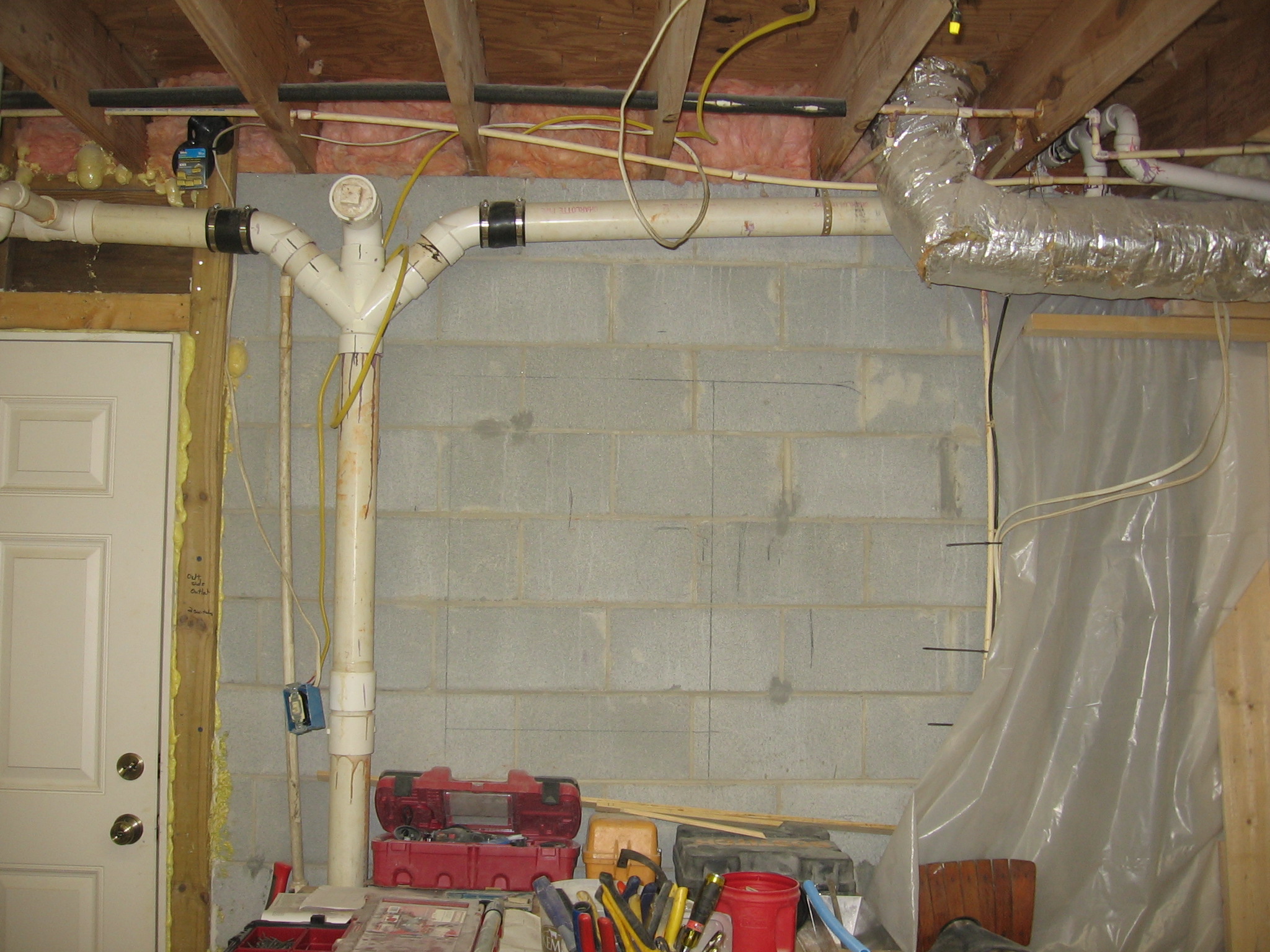

Here are a couple of pics that show the inside of the wall and the obstacles.
   / Chimney Installation Questions #17
So you're going to go thru the cinderblock and up the outside of the house, it doesn't look so bad. At least you have no concerns about any combustable wall material being close to the flue
At least the wall's not finished so you can see what you're working with, do you plan on finishing it eventually?.....Mike
Mike, yes we plan on finishing the wall when we do the stove/fireplace.
I wonder if a non brick chimney around a double wall system would be best.
My soffit is about 15 1/2" deep/wide.

A 6" Selkirk (what I use for a generic name for a s/s chimney) is about 10" O/D, allow 3" ( I think it was minimum to any combustable material) so that's 16", not gonna happen so you're going to have to leave it open like I had thought, a 'slot' in the roof, open on the outside edge. I've seem them done like that and if done right, doesn't look bad at all. IMHO think it's better and easier as you don't have to flash around the chimney/roof pass thru.
However you do it, find out where the rafters are in your roof so you can go up between them. I'd hate to have to see you cut a tail off a rafter to run the flue up when you could have moved the stove one way or the other with no problem....Mike
