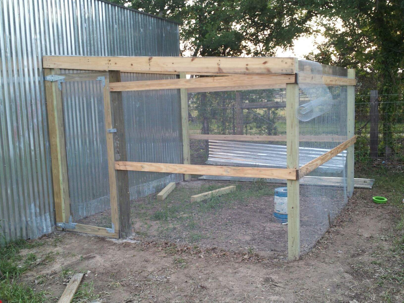

/ Chicken Tractor or Chicken Tank? #15
I started on mine but its taking me alittle longer than planned:D

My took a LOT less longer than planned. :D I figured I had a least two months to build but them chicks where growing, and ARE growing, too fast. I need to fix the gap at the top of the door so the chicks can stay outside at night. The last two nights have been too cold even if the door was fixed.
Is that 1/2 hardware cloth you are using?
Did you bury it in the ground to prevent critters from digging into the coop?
A coworker's family member just lost 40 chickens. A critter, sounded like a weasel, got into the coop through a small hole and killed all of his chickens. :eek:
