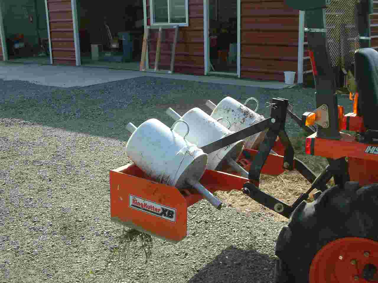

The cheap box blades usually are pretty lightweight, so you'll have to add weight to make it work effectively. The more expensive BBs tend to be heavier.
My cheap KK XB box blade (4-ft wide) that I use on my Kubota B7510HST is way too lightweight to do simple things like strip turf/weeds without adding about 360 lb of extra weight (each plastic bucket is filled with 120 lb of concrete).
To be honest though I sincerely doubt that an "expensive" BB of the same size would weigh as much as your "wieghted" cheap BB, right?:rolleyes:
Mike in Warsaw
My BB is 4-ft wide. Workallthetime's is 5.5 ft wide. But you're correct. That difference very likely does not add up to 360 lb. So he'll need extra weight.
