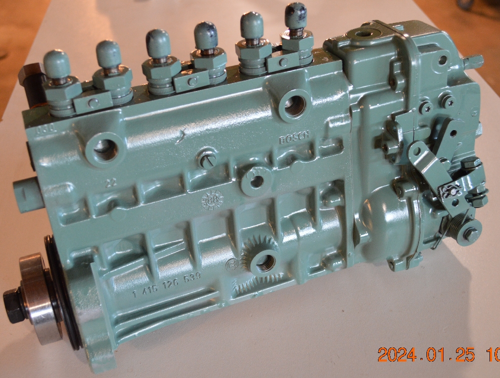

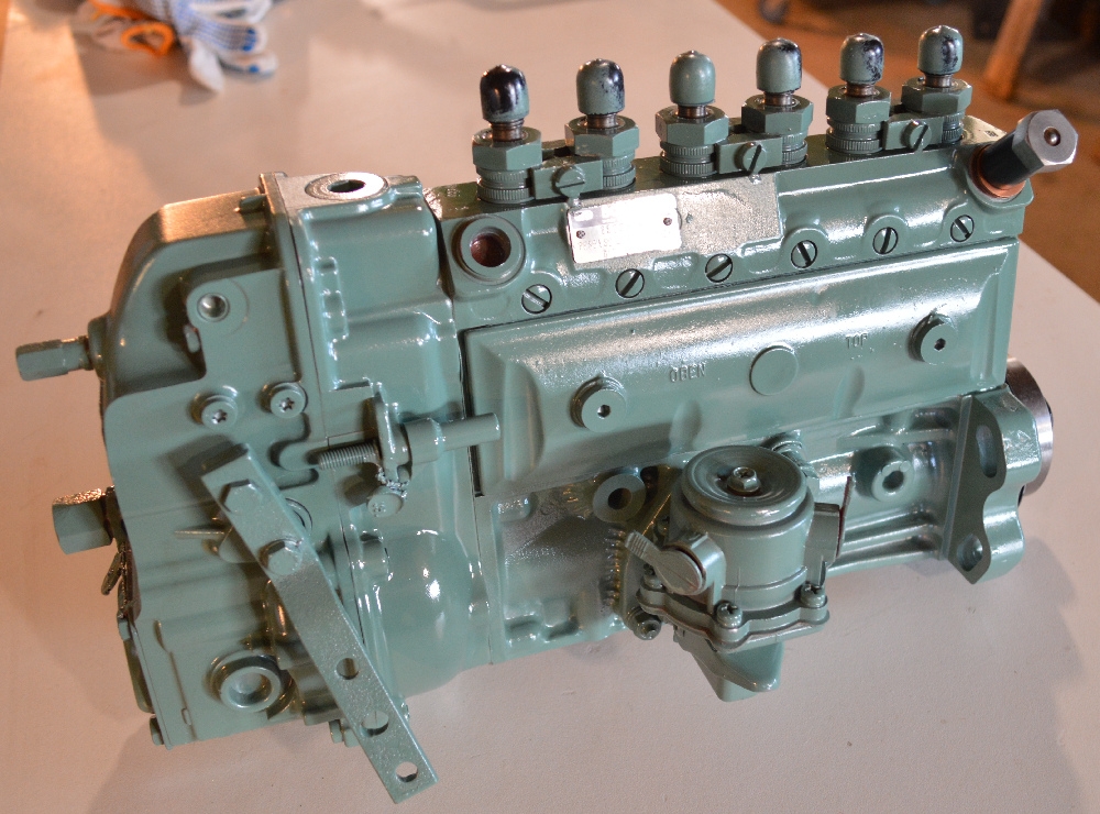

My BOSCH inline pump doesn't seem to have the view-port or I'm too dumb to find it. It's on a normally aspirated F6L912 in my 1991 Deutz-Fahr-Dx-6.05 (european model).
The good book says to time it with a drip check but I have no idea what pressure to use and don't wanna blow the casing up with the only hand pump I have, an injector testing pump. This ritual requires the inlet port to be pressurised and the #1 outlet port to to have a u-tube where a forming drop is to be observed. It doesn't say what to see before the drip nor after, is it a last drop or a first one, etc. I would have expected a more professionally written procedure like
1 - Back the crank to about 90 degrees before compression TDC
2 - Hang a u-tube on #1 outlet port (line to #1 injector removed)
3 - Pressurize the inlet port 20-40psi(?) with a hand pump, maintain pressure.
4 - Observe no dripping out of u-tube (or no-flow as the case may be "I JUST DON'T KNOW!")
5 - Turn crank sneaking back up toward compression-TDC
6 - Stop when Fisrt/(OR is it Last?) drop forms on end of u-tube, THAT is "Commencement of Delivery"
I got this so screwed up I really wanna do another drill instead BUT my pump doesn't seem to have a view-port. The last 912 I did was in 2008 and on that one I just reused the pump and reinstalled it to punchmarks made during stripping.
This is a rebuilt pump with the cover screws sealed, the minute I break those open the value of the pump goes to 'core' but if necessary I can look in there too. Would really appreciate step-by step guidance on this so that I don't just FUBAR the whole procedure. I've got compression-TDC very precisely marked.
+++++++++++++++++++++++++++ Addendum

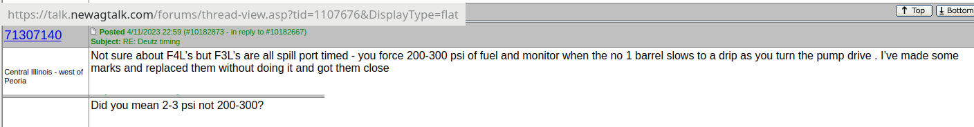

This pump doesn't BTW seem to have a timing pin OR a view-port
I have since found the above info but it's a bit ambiguous from 2-3psi to 200-300psi
