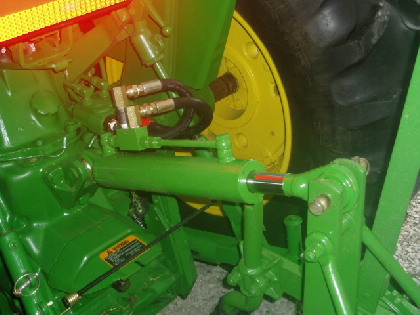

Talk about timing!!!! I just "installed" my FIRST CHOICE hydraulic top link today, on my finish grading tractor. I bought it through Sweet Farm Equipment.
Here's a picture!
   / check valves for top link #6
And another view!
Nothing like a new toy!
