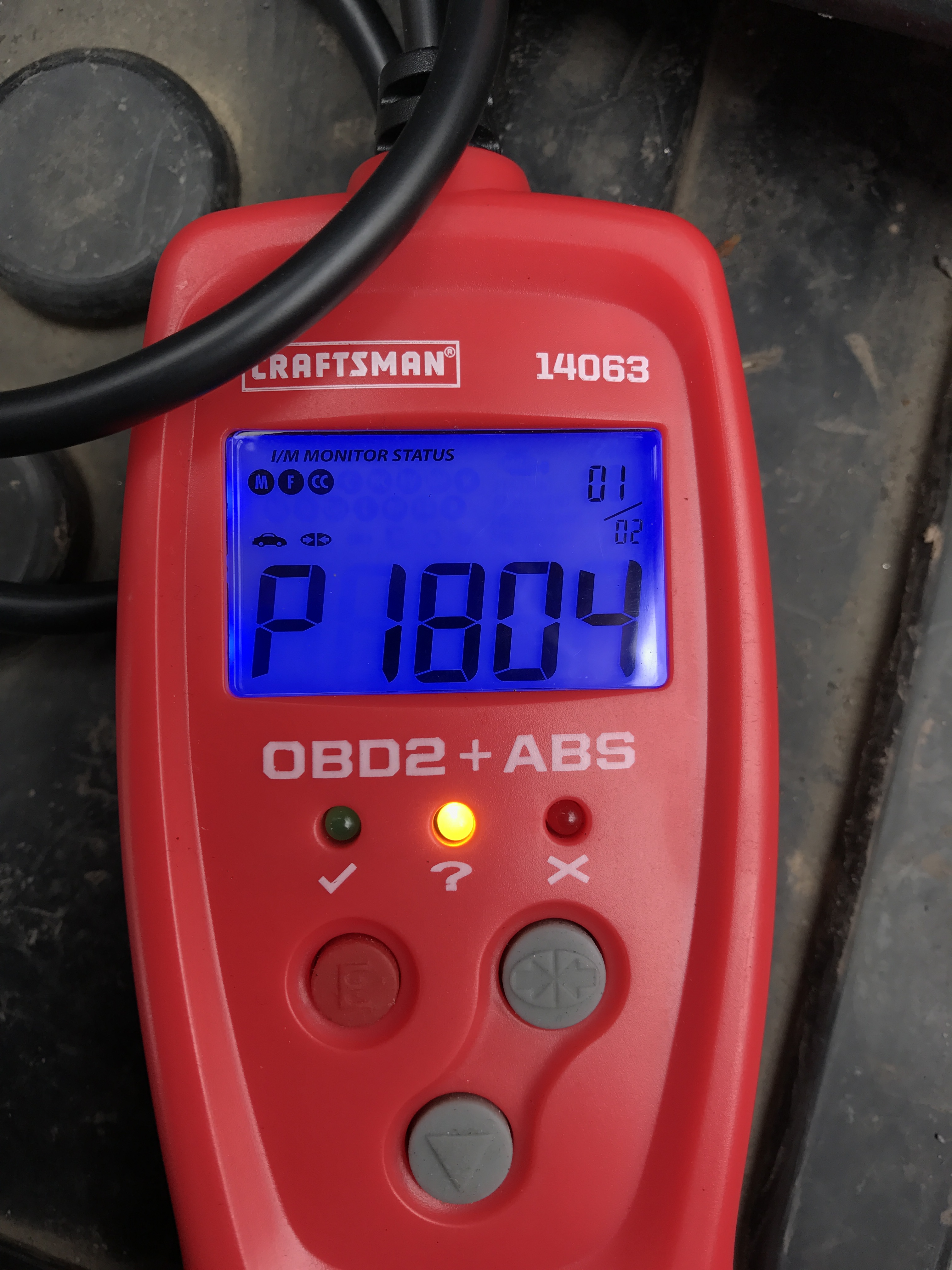

Does anyone happen to know what the Check Engine code P1804 specifically means?
I've seen it mentioned in another thread that it was a Mahindra specific code but no description was given of what it means.
Tractor had 1st issue of cranking but not firing. Tried it a second time and it fired. Check engine light came on briefly but then went away in 2 minutes before able to check it.
Then 2-3 episodes of the tractor failing to fire when cranking 3-4 times and would only fire when throttle is held wide open. Check engine light stays on and it's now in Limp Mode, not revving past 1900 RPM. OBD2 reader says code P1804.
Waiting to hear from the dealer.
Just thought i'd ask here.
Seems fuel related.
Tractor was running great, first time it saw below 1/2 tank of fuel and this started happening now, increasingly worse.
Pulled the tank and checked the screen/pick up, clean as a whistle.
No water in fuel; pre-filter drain check looks good.
Filled the tank back to full just to check, but it's still cranks and needs full throttle to fire.
Thanks.

Sure it's an 1804 and not 1801?
/ Check Engine code P1804 - Mahindra 3550 PST
yea, P1804 (disregard the 1/2; it showed P1804 as both codes)
/ Check Engine code P1804 - Mahindra 3550 PST #4
P1804-- RAIL PRESSURE LIMITER OPEN :eek:

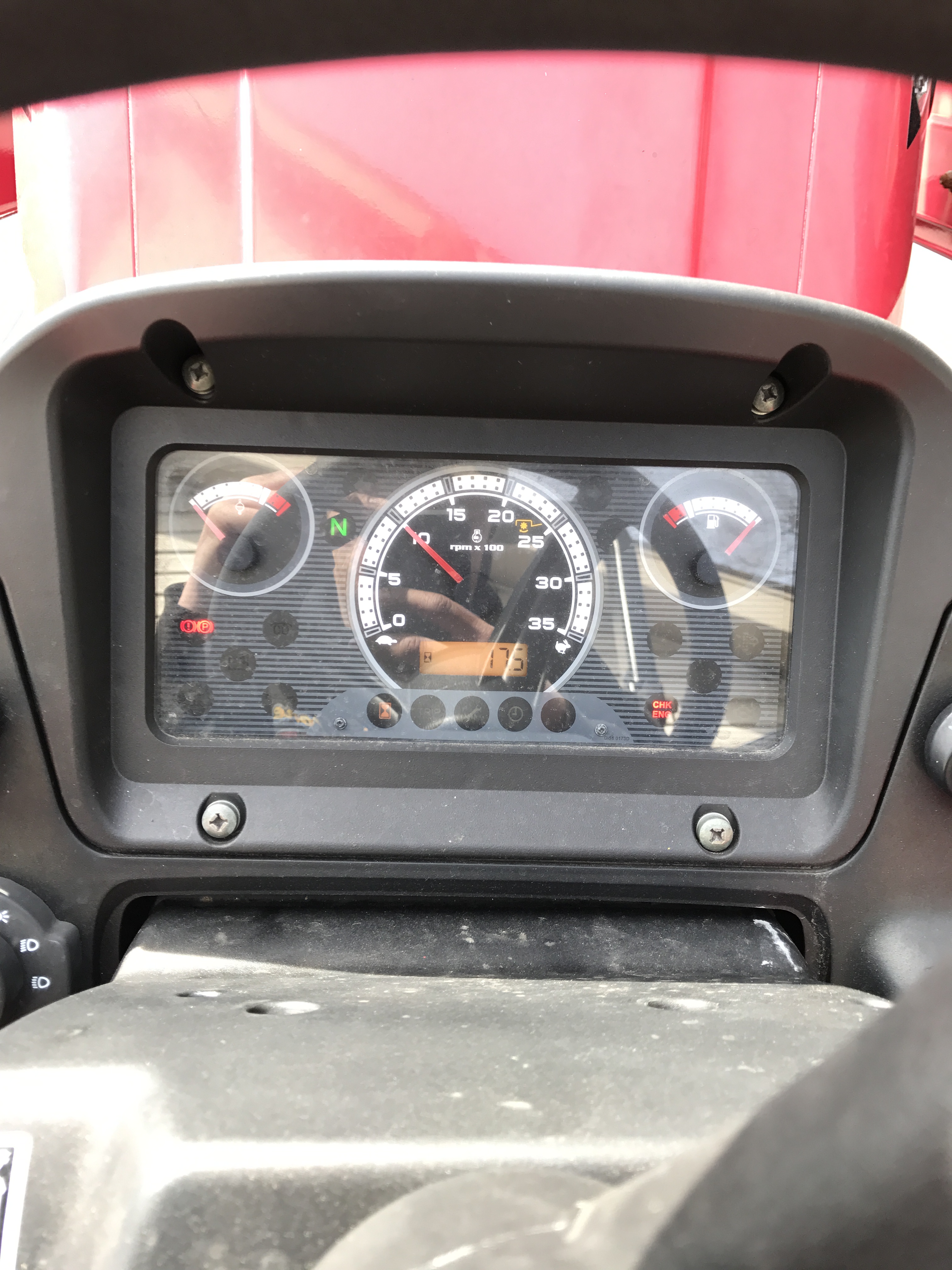

So the plan is to swap in a CPS and see how it does. They also installed the most current ECU software they had, aka the ECU reflash. I did mention about the temp gauge not moving at all unless I was actually doing some serious work with weight on the tractor. I also saw a video where someone explained how when Mahindra switched to the newest Tier 4 powerplant they never utilized the proper new temperature sending unit/gauge combo.
The Tech is going to see if he can find more info on this and track me down an appropriate temp sending unit if possible.

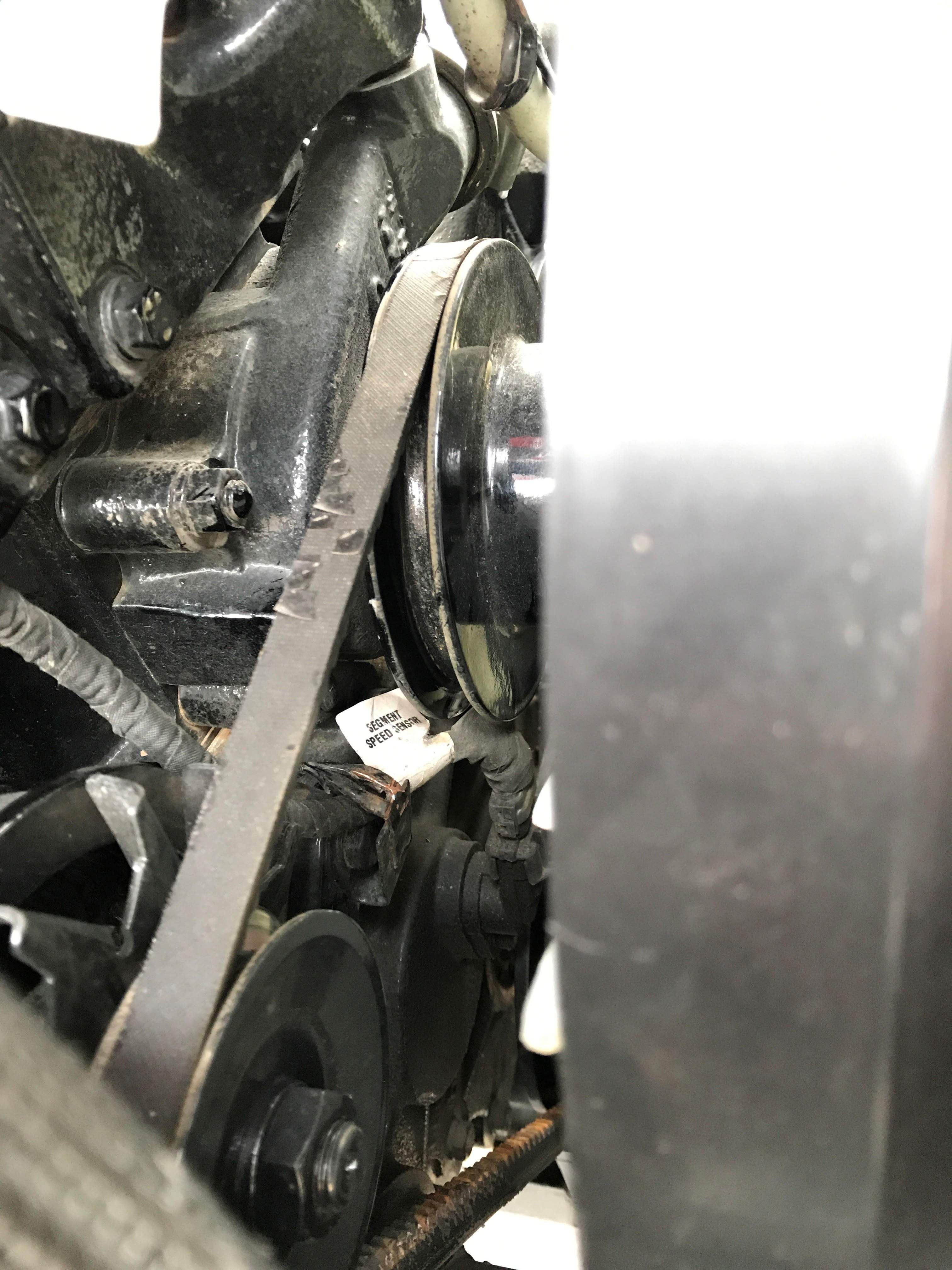

Here is a pic of the sensor; front right of the engine. in the middle of the triangle formed by the alternator pulley, fan pulley, and crank pulley.
The wiring tag says Segment Speed Sensor. The Mahindra Parts manual say Phase Sensor. The Garuda software read the code as Camshaft Position Sensor. It could also be Engine Speed Sensor or Crankshaft Position Sensor.

One correction to what i said in an earlier post: "For clarification, the Camshaft Position Sensory / Crankshaft Position Sensor / Engine Speed Sensor are all synonymous on this tractor. There is a single sensory on the front of the engine, between the alternator and crank pulley." THAT IS NOT FULLY ACCURATE
There is a separate Crankshaft Position Sensor located on the right hand side of the bell housing, just under the cab (essentially under the brake pedal). The tractor had no input from the Camshaft Position Sensor / Segment Speed Sensor (as per the harness tag), so it could only go off of the crankshaft speed sensor to communicate to the ECU about engine position. The ECU automatically limits engine speed to around 1900-2000 RPMs and the CHK ENG light comes up on the dash, showing code P0340 on the Garuda software.
So anyway, I finally had time to arrange for them to come up. Again, the dealer is just great, and sent the tech up to my house this morning when I was free.
I already had the sensor ready for replacement.
I raised the loader to max height. Locked the hydraulic joystick. Opened the hood. Removed the two 12mm bolts to hold the exhaust pipe on. And then had semi ok access (for my relatively small hands) to the sensor. I removed the harness clip. Then used a 5mm allen wrench to remove the single sensor bolt (note, the screw head had some paint or rust in it at first and I could only get a 3/16" allen in it but it was loose. A little wobbling around and I got the proper 5mm allen in there and removed the bolt).
Theres a rubber oring around the sensor. If it's not on there, be sure to fetch it from the hole in the block were you removed the sensor.
New Bosch Sensor P/N 0 281 002 667 was installed.
Clip placed back on.
Exhaust pipe reinstalled.
Turned on the key, let the grid heater run.
And she fired immediately upon cranking.
CHK ENG light gone.
Hooked up the Garuda software, P0340 code showed as healed, and we cleared it out afterward so the ECU is clean.
I'll also say that the temp gauge now responds appropriately after the reflash they performed on the initial visit also. Atleast it seems that way. it's also been 20-30 degrees warmer now though too.
