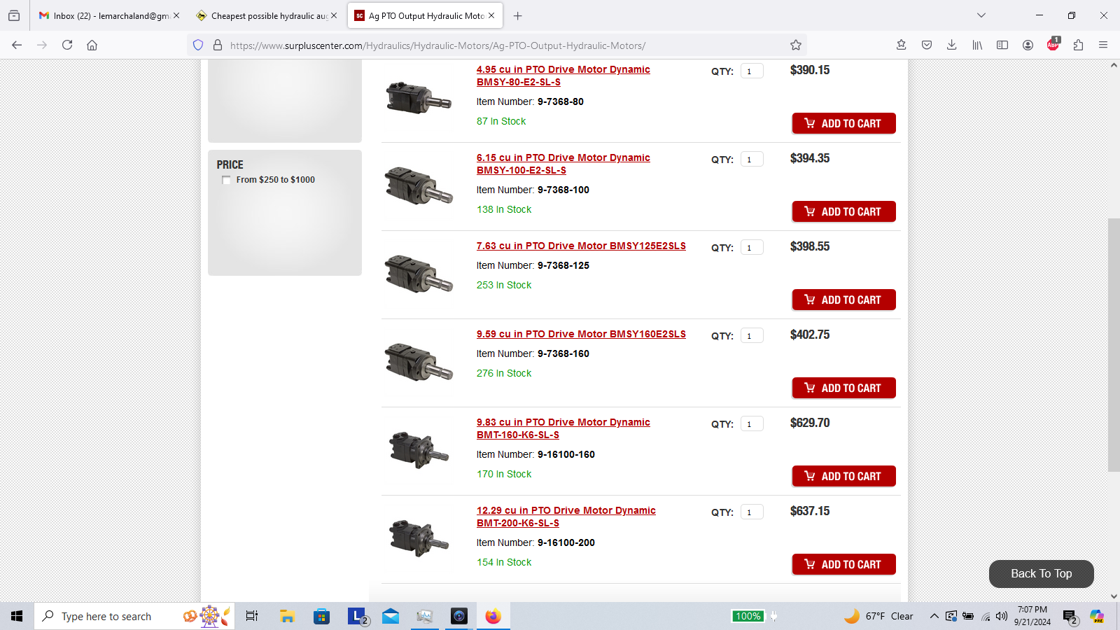

The larger the cubic inches of the hydraulic moter the more torque and also the more GPM to reach max speed.

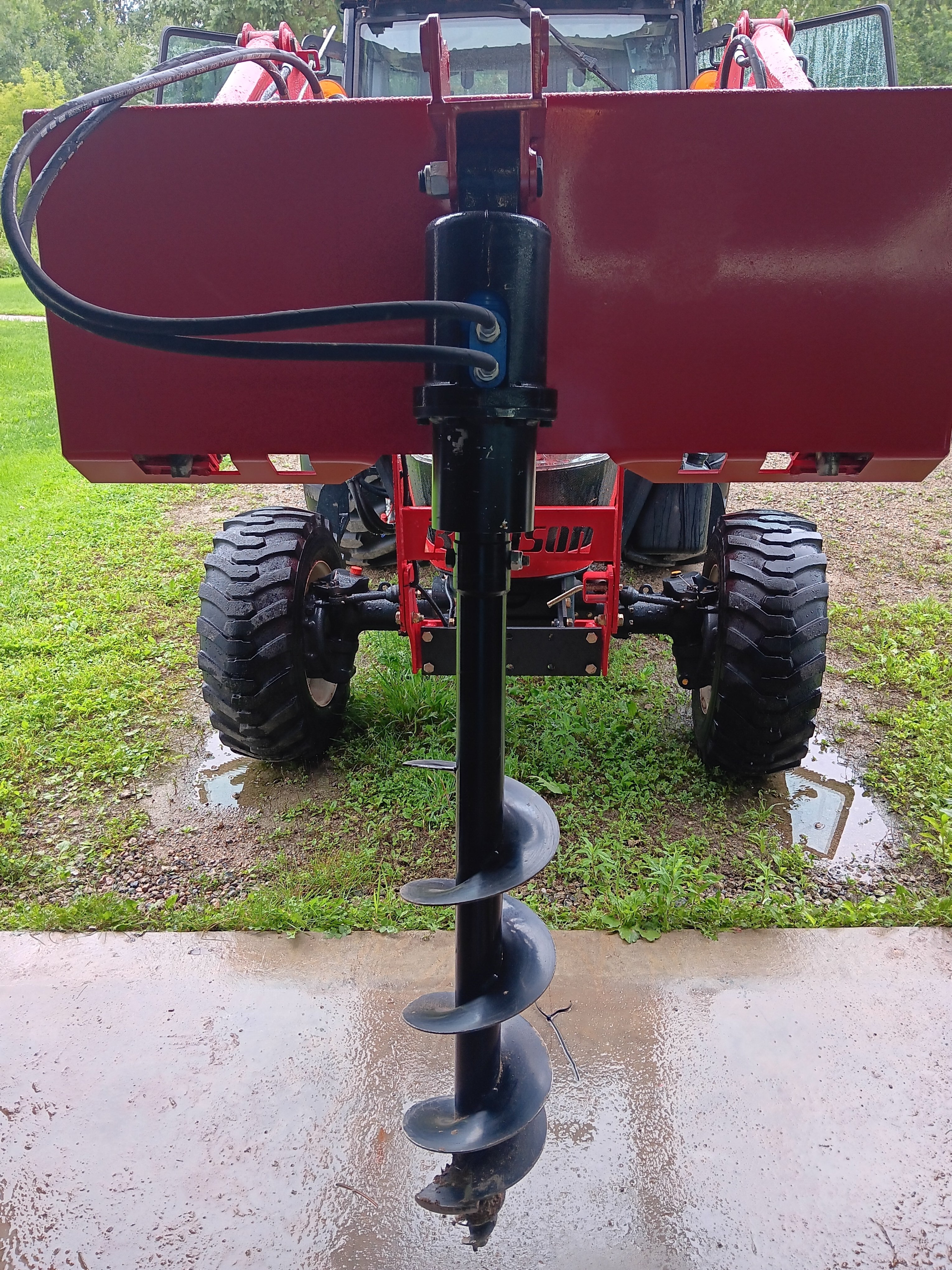

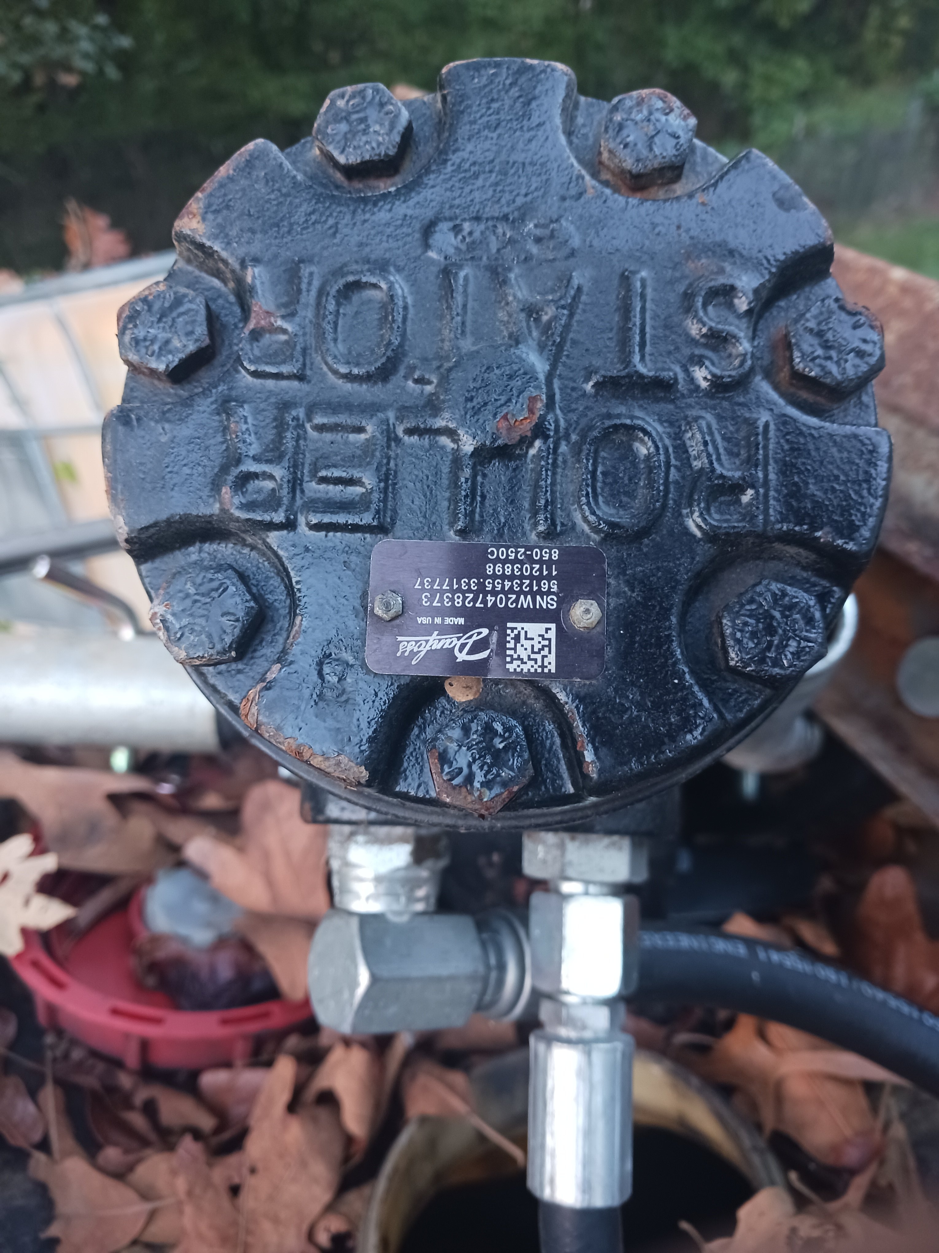

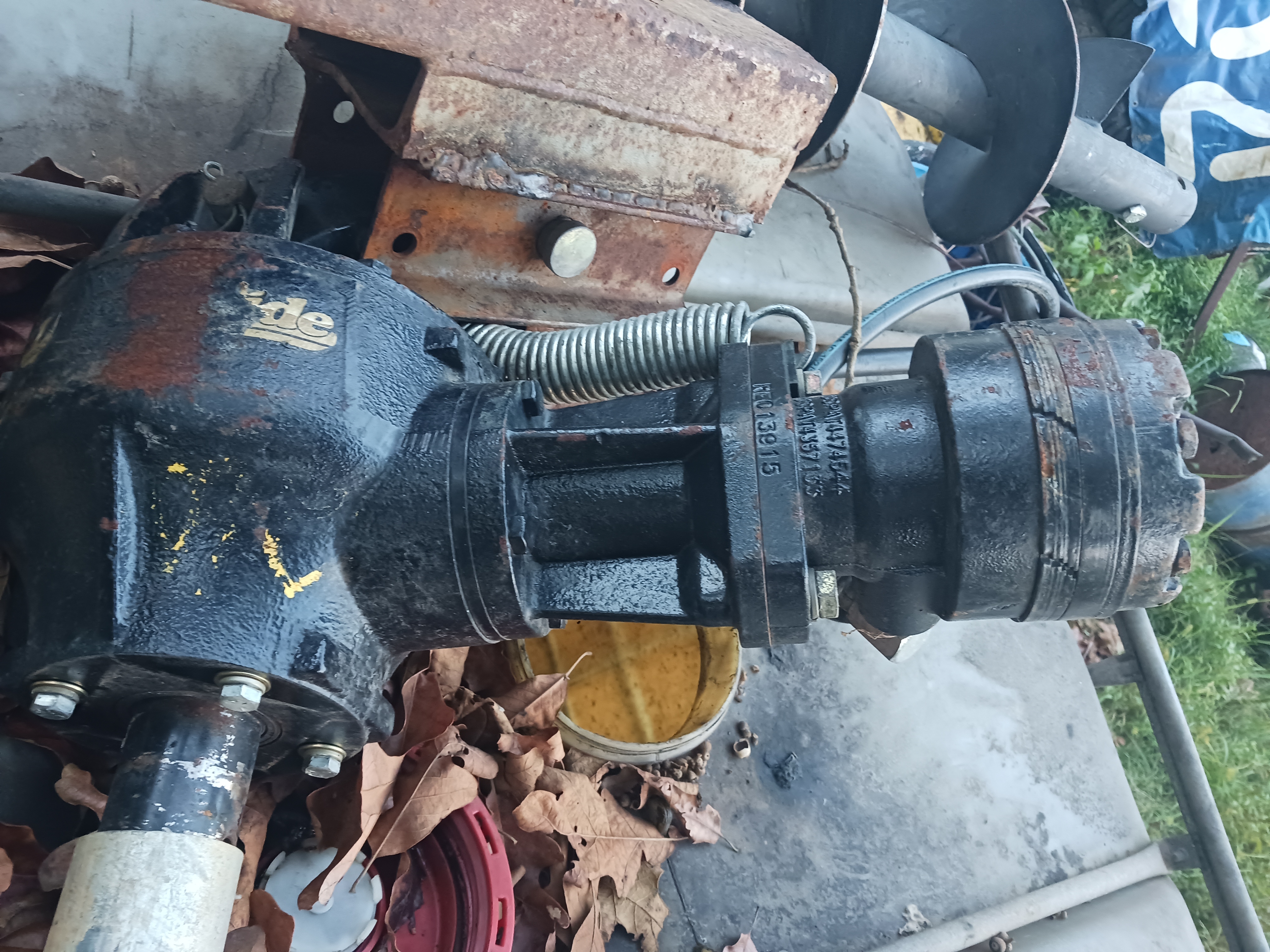

I made one from an auction purchased hydraulic motor, frogged up an adapter to put my augers on, and bolted it up to a JD Q.A. plate (Amazon) on one of my loader arms. Runs off the curl side of the loader control stick. Hoses were the highest cost. Plus now I can see exactly where the hole is going to be and no longer have the owl neck needed to run a rear mounted PHD. Best part of it is drilling replacement holes for broken posts. The loader arm pushes the wire fence back and away from the new hole. The motor is mounted in a 'cage that's gimballed using an old ujoint set so it's always pointed towards the center of the flat earth. All on its own...
   / Cheapest possible hydraulic auger #4
This is 1 I picked up at an auction its a land pride unit came with 8 " auger I modified a 4" auger for it works ok with the rocky soil here
