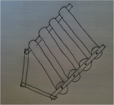

Why not make a multiple roller cultipacker from some round timber fence posts and some 2X4's? You could use lag bolts as the axles and sleeve them with pipe segments to hold down wear on the wood frame. It probably wouldn't hold up to daily use but for food plots and hobby farming it might do OK. If you add enough posts it might be heavy enough to give good seed to ground contact. See bad sketch below.
Dumb idea?
/ Cheap roller/packer? #2
Seems like it would skid and bunch dirt before it rolled.
I have seen a bunch of car wheels and tires of similar size with a pipe through the center that was cheap and worked.
/ Cheap roller/packer? #3
I helped a buddy build a roller for the grass runway we lived on and it looked just like your drawing. Don't know about wood, ours was 14"-16" steel pipe for the rollers filled with water and I beam down each side. It did skid the grass some in turns but we were going straight down the runway and turn around in the field off the end. The 4 rollers did a lot better job than any single roller could because it would hold a roller up as it went over a low spot and put more weight on the high spots.

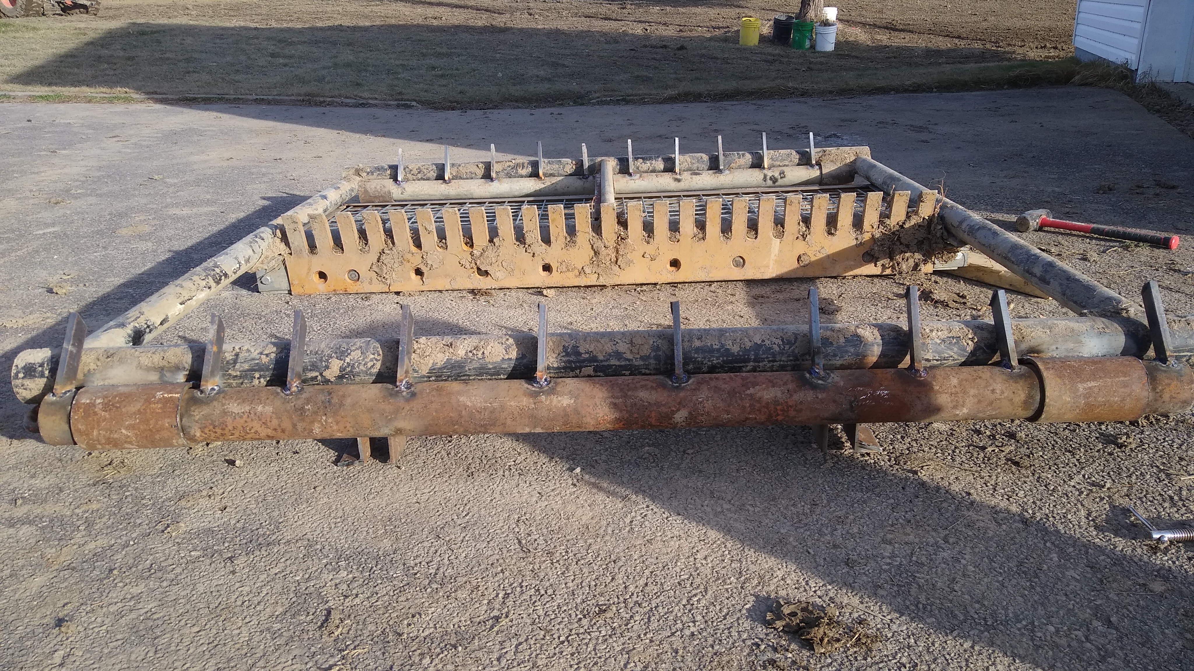

The problem with a single roller (width) is that it will high center over small dumps and furrows. No matter is you have 5 single rollers behind each other. I have made one and it worked ok but I found out that it didnt press the seed down in some places because it rolled over a small dump and the seed at the ends of the rollers did get touched. That is why a cultipacker had
individual rollers that spin on shaft that also spins... I made one out of a piece of pipe.. See below... I traded it for a nice box blade after using it.:thumbsup: Now if you can drag your field to almost level it would work fine..

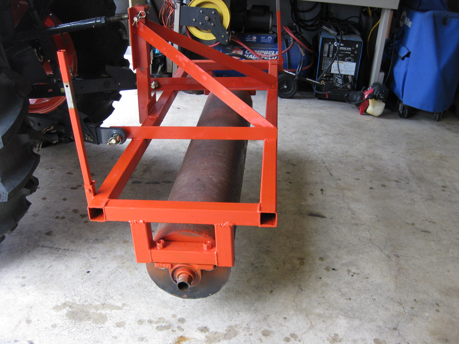

In my "good idea" note book, this is how I plan to do a homemade cultipacker..
I'm planning on 12" corrugated galvanized culvert for a 5' unit..
Have also seen pictures of a homemade using cement filled auto rims..
That could be a basis for a number of different attachments..
I caught 1" pillow block bearing at PA on sale... $8

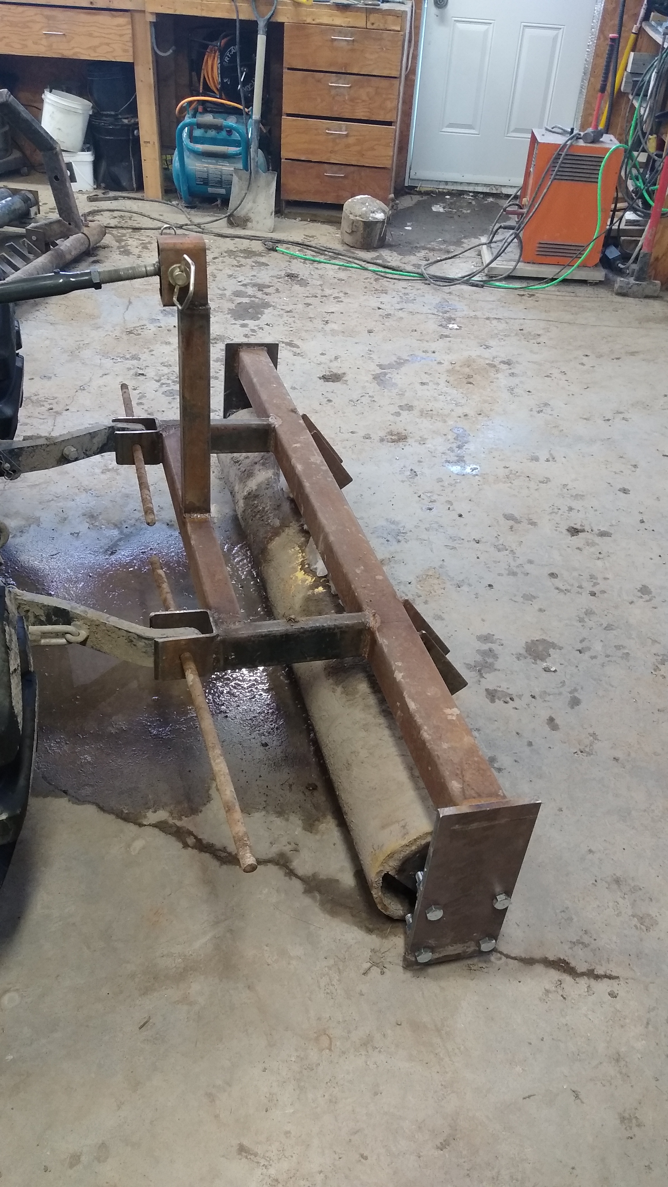

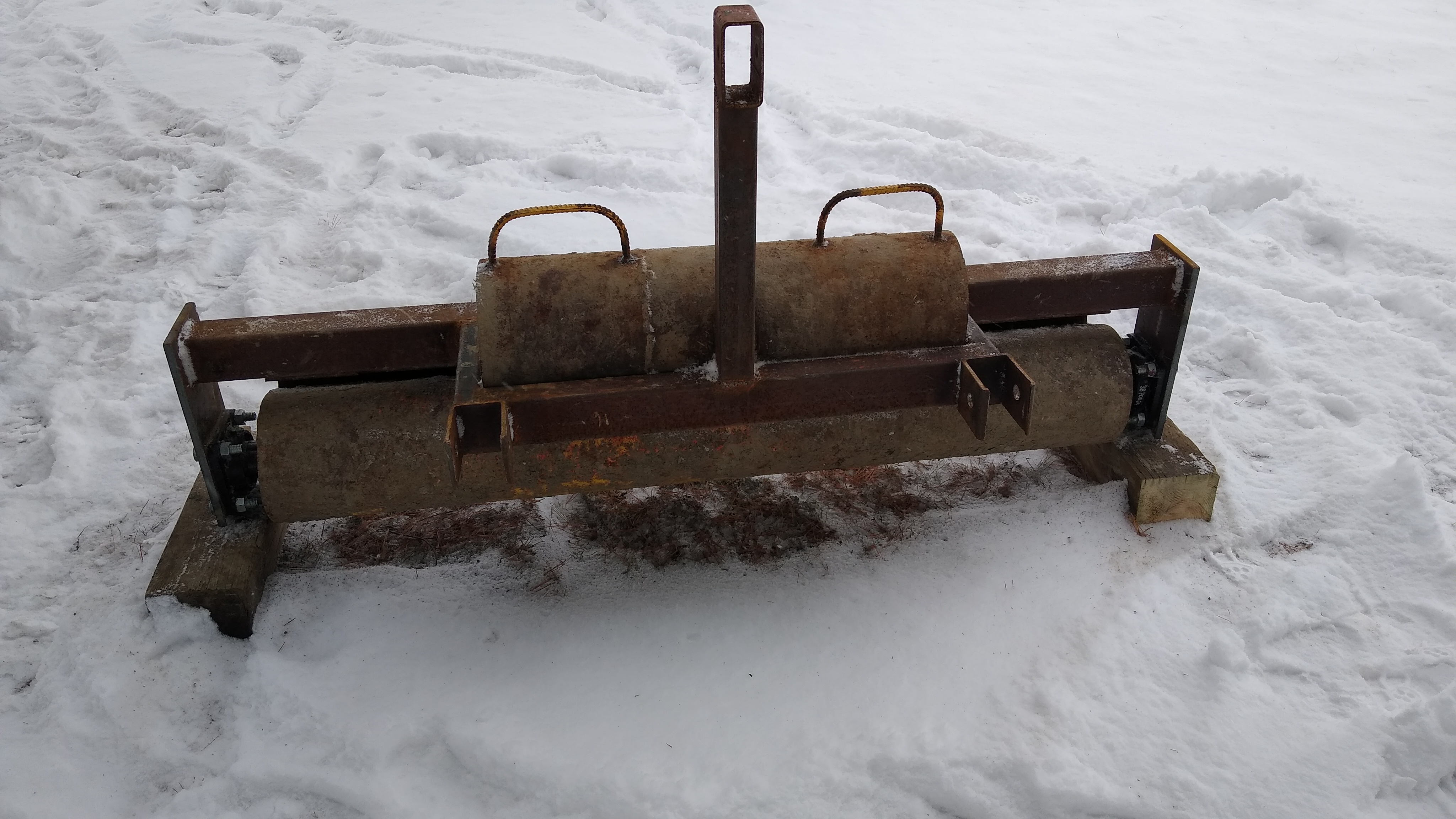

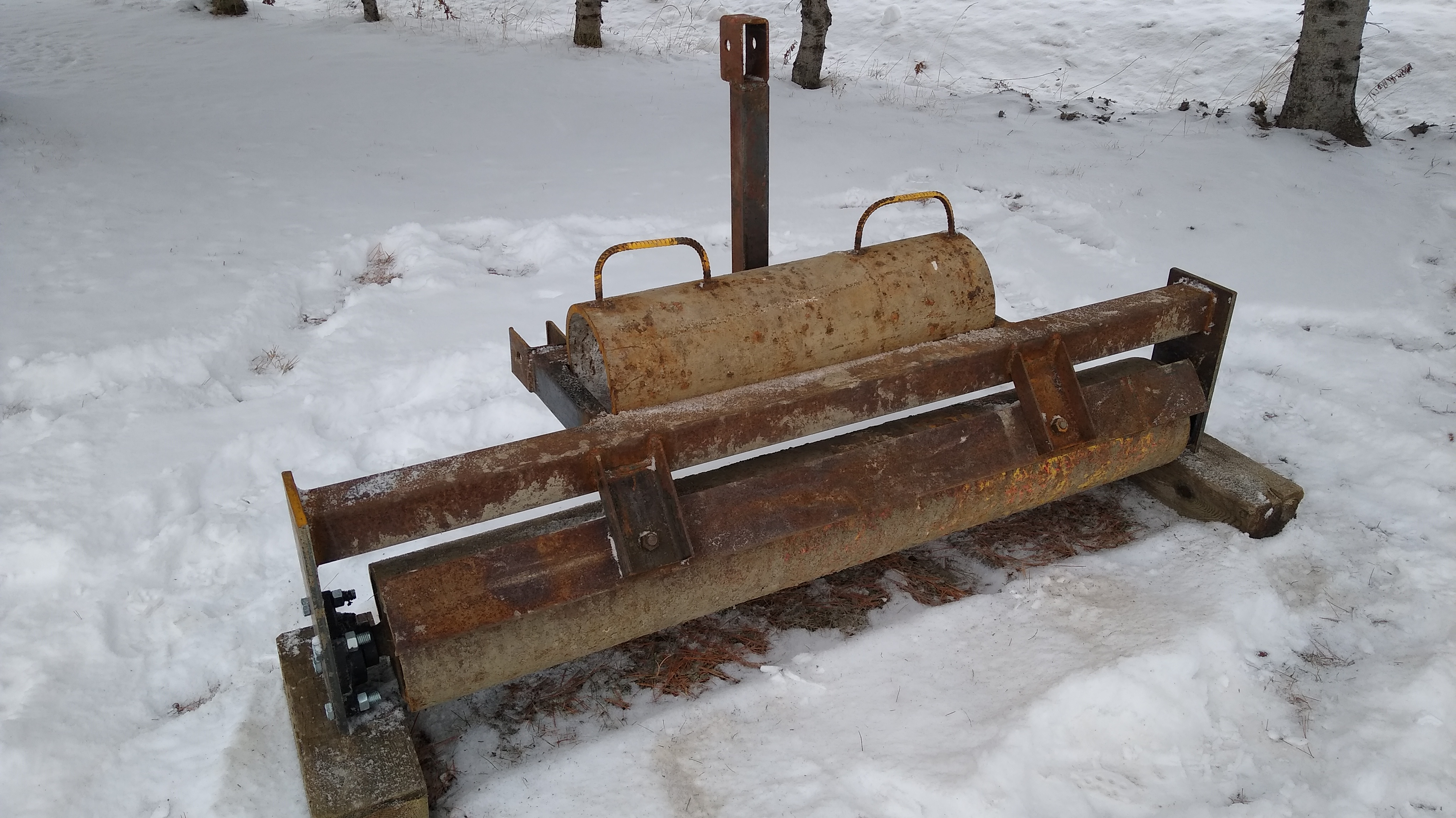

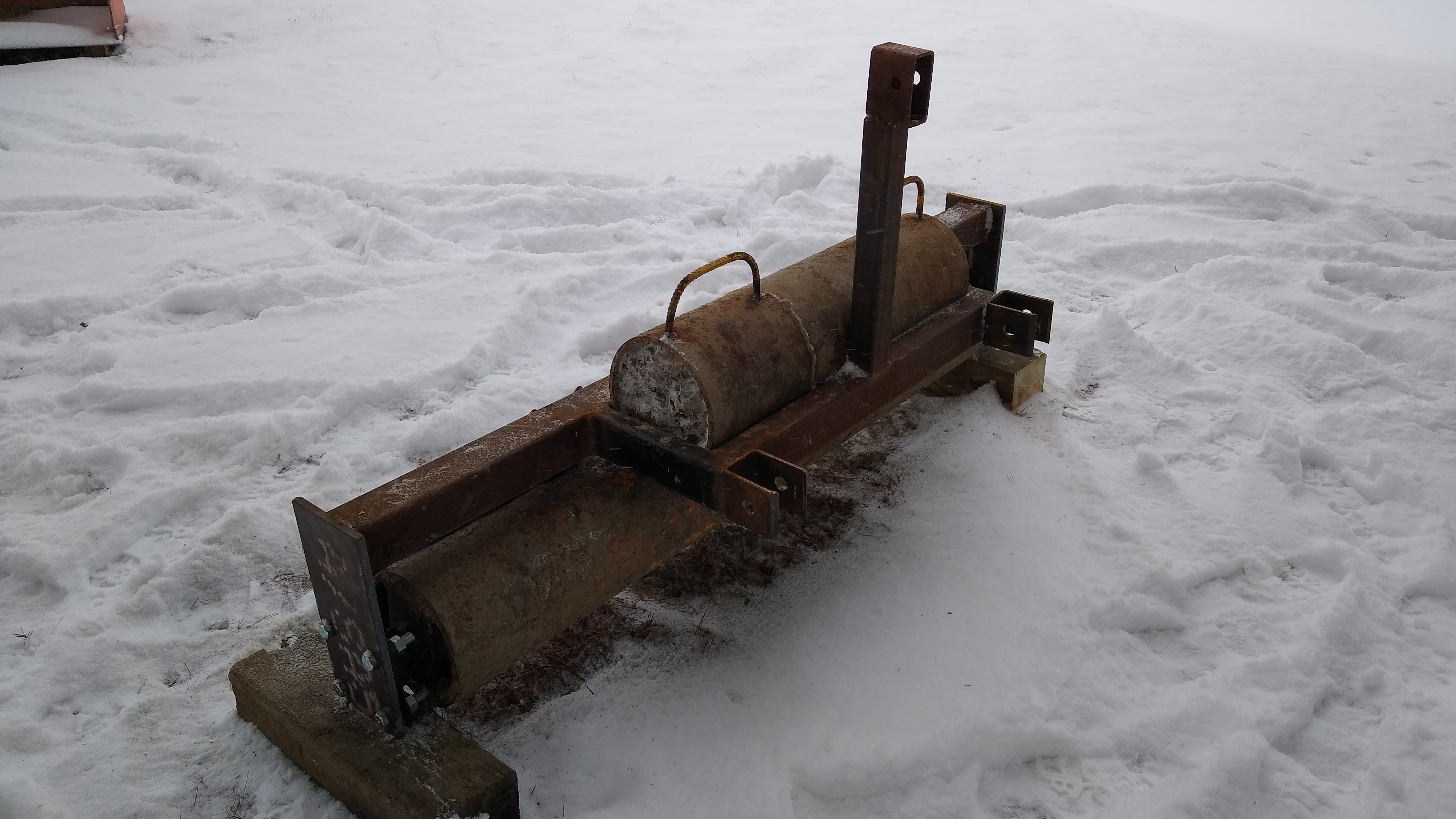

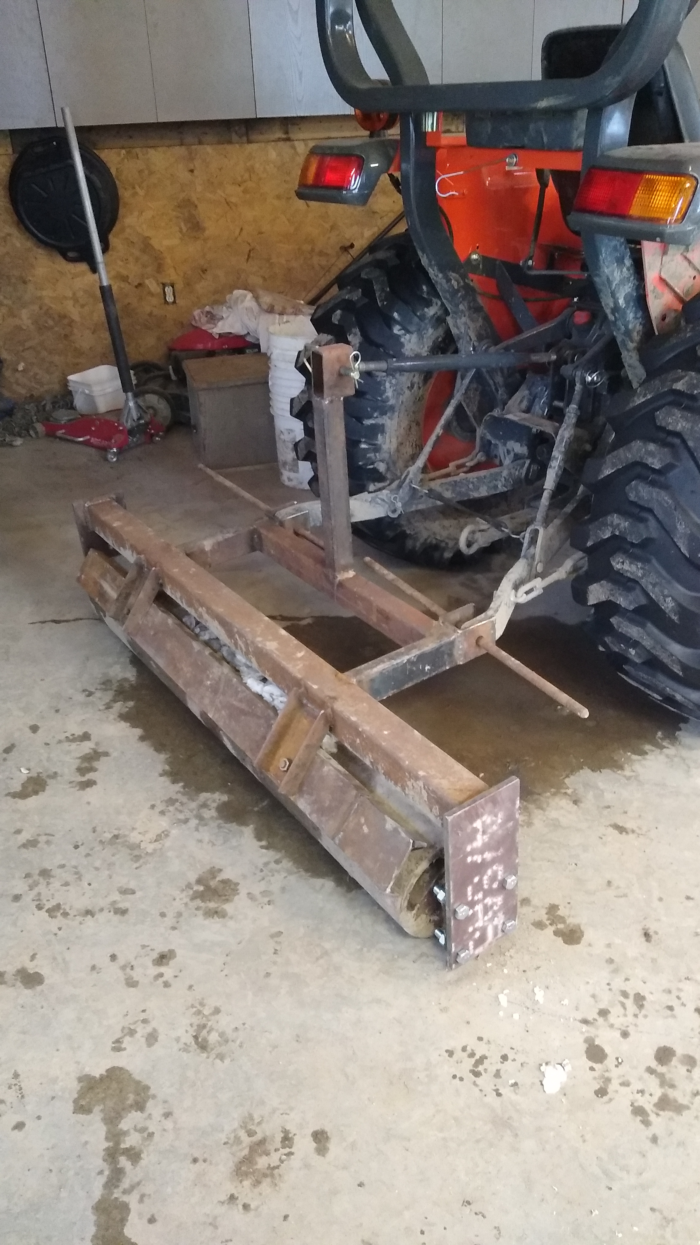

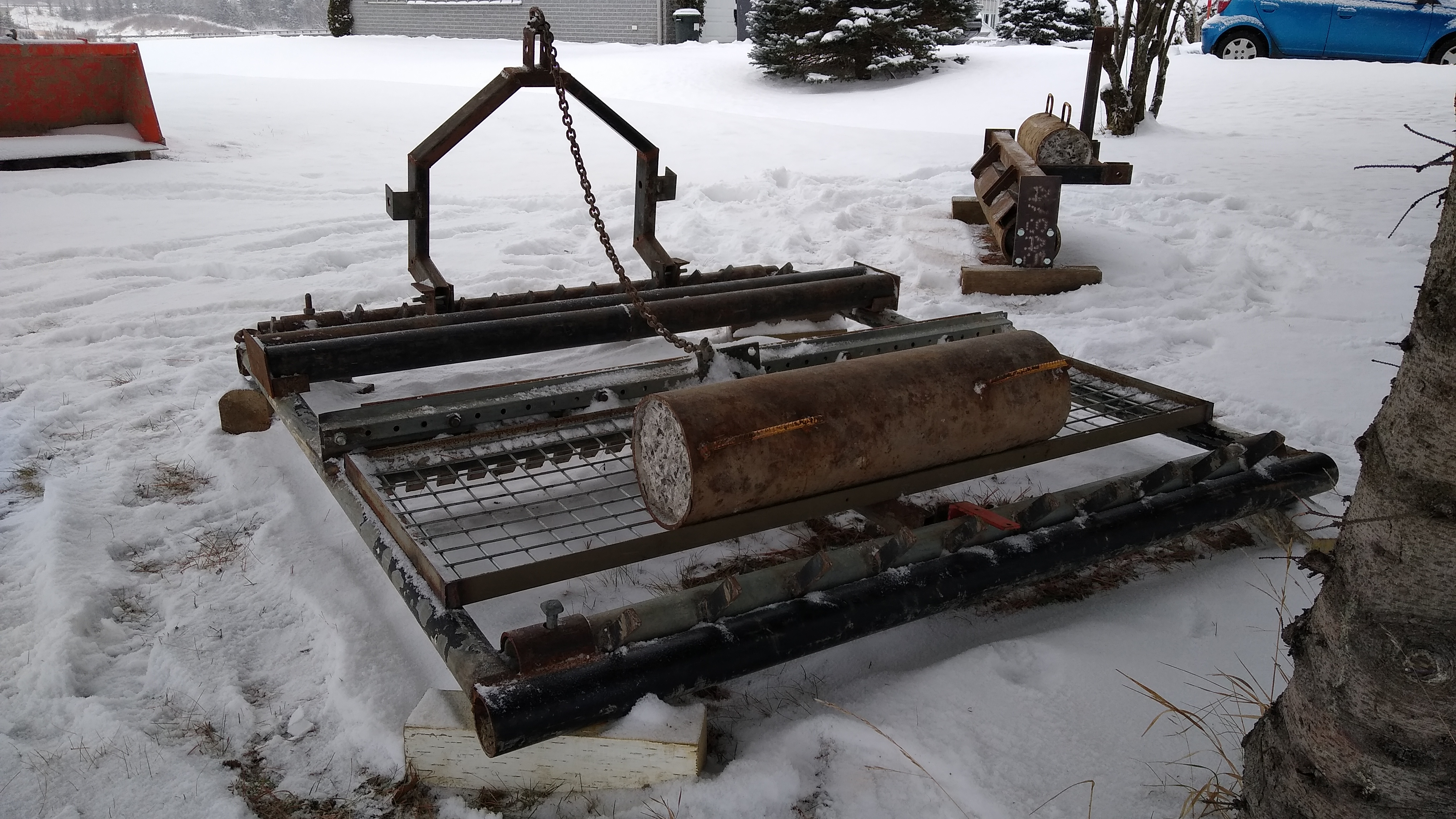

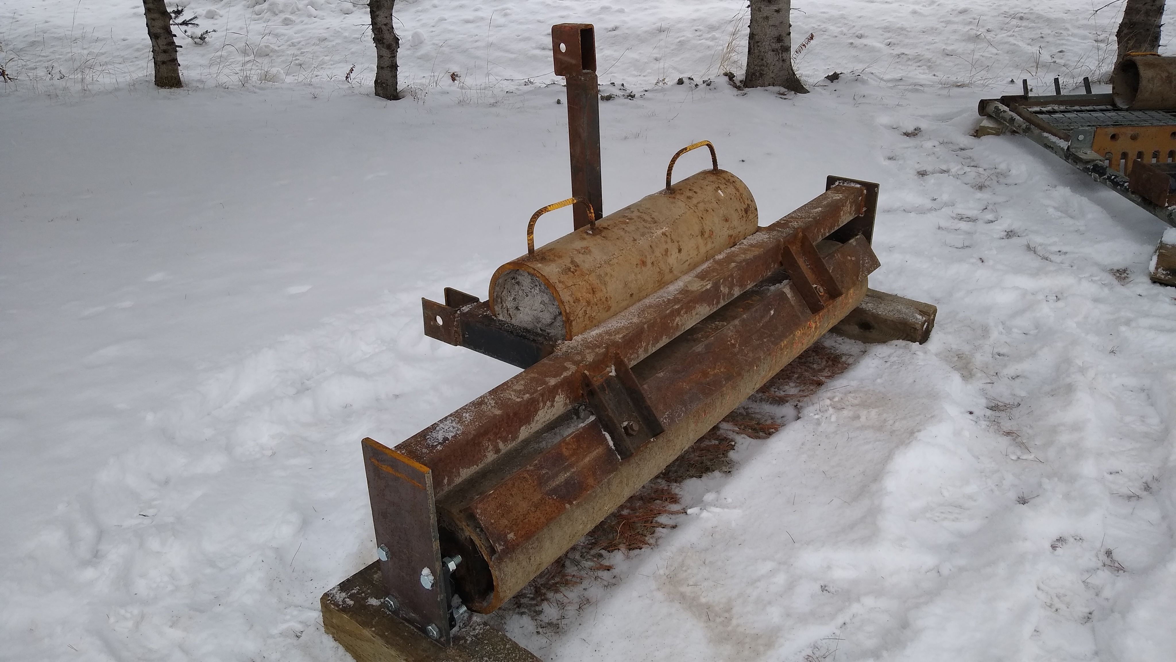

i finally build my roller and finished it this morning with 1 3/4" 1/4'' thick pipe and Bearing
it rolled fine on snow for testing. tomorrow i will build a 200lbs weight to had to this APROX 500LBS attachment
to make ot 750lbs total weight. Pipe roll is 8'' inside diameter 1/2'' thick filled with concrete (350LBS-400LBS) IMG_20201125_085814911.jpgIMG_20201125_085859154.jpgIMG_20201125_085916783.jpg
/ Cheap roller/packer? #11
too late now but the diameter of the pipe is a little small compared to factory built cultipackers I have seen . it may not roll as easily over bumps or clumps of dirt.
/ Cheap roller/packer? #12

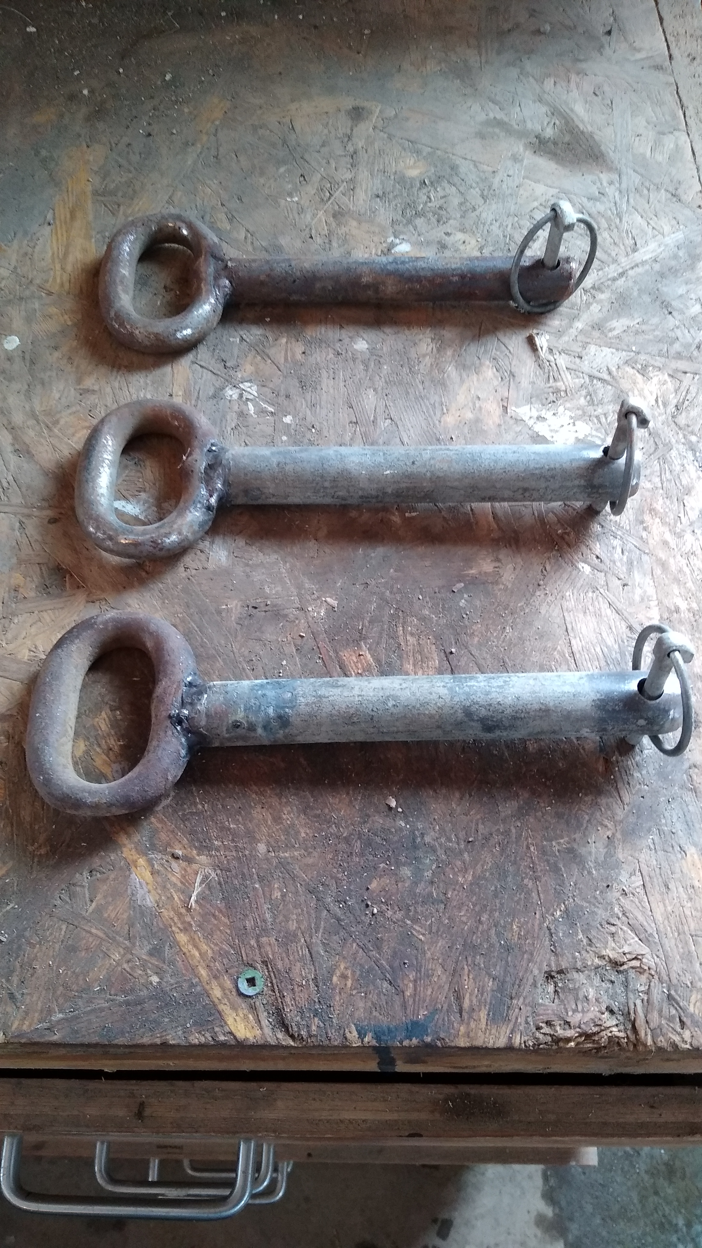

i hope you are planning to shorten the pins holding the lower links on :)
I like the scrapper idea to keep dirt from sticking to the roller

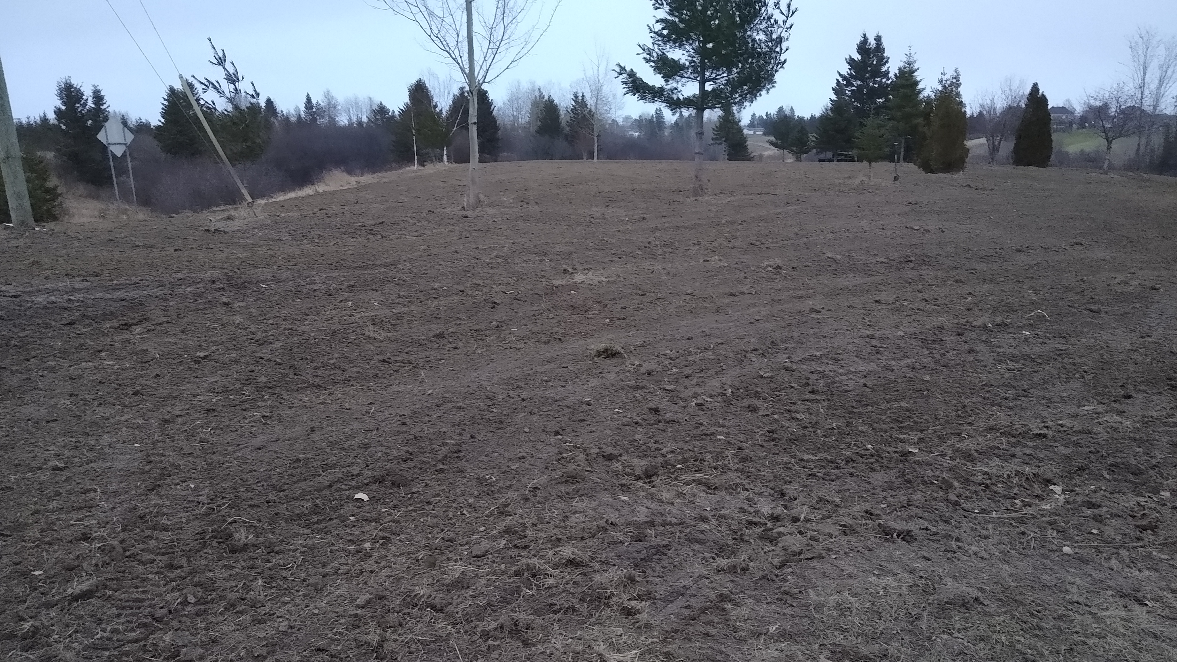

I have built what I shall call - home made drag. It effectively levels the tilled ground and covers the seeds. I have a rope yoke between this "drag" and my ATV. If you built something like I have - you might not want the spikes on the leading & trailing 4 x 4. I go round & round - back & forth. The wild grass seed is buried and the plot ends up almost smooth as a pool table.
/ Cheap roller/packer? #16
/ Cheap roller/packer? #17

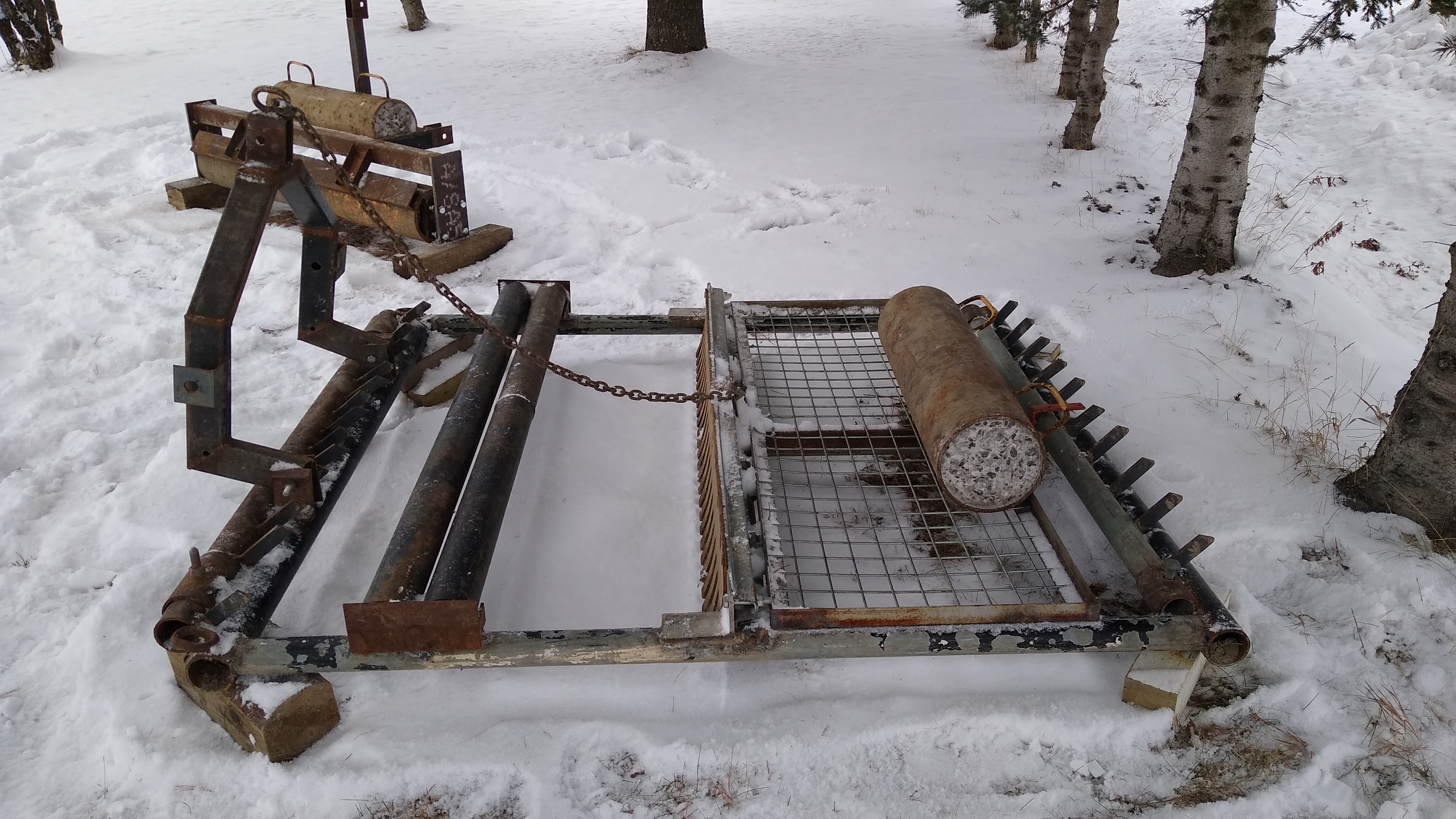

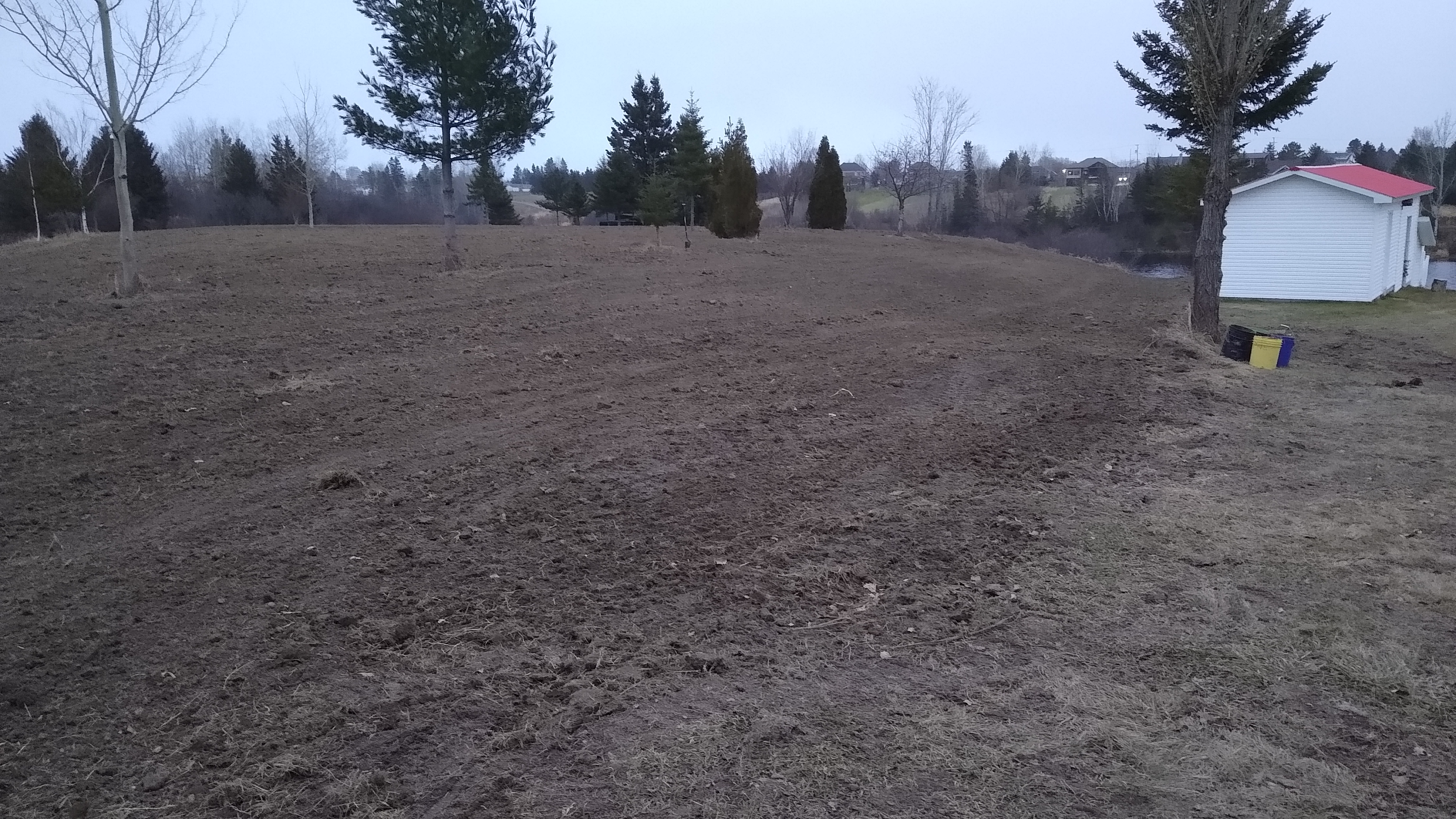

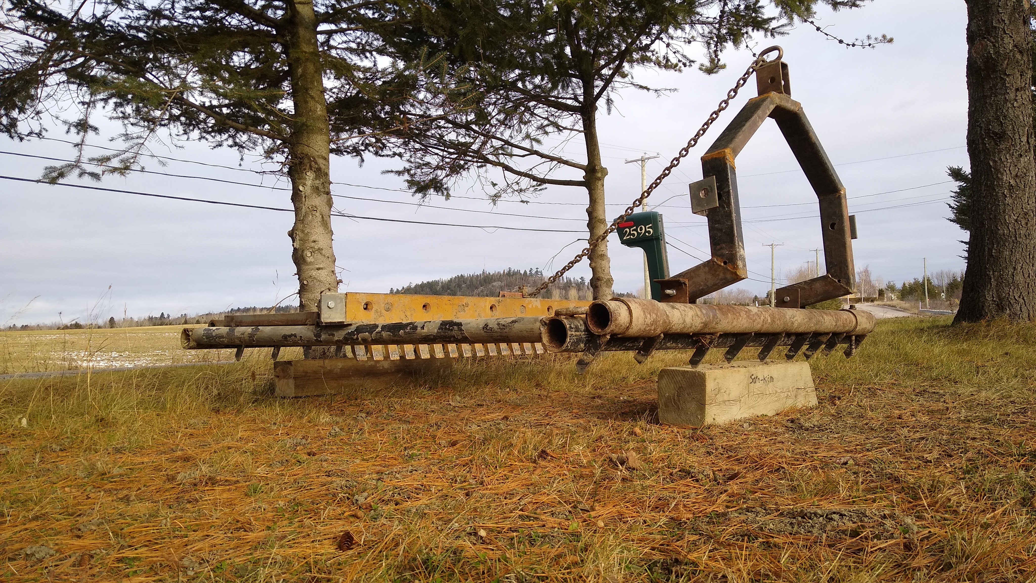

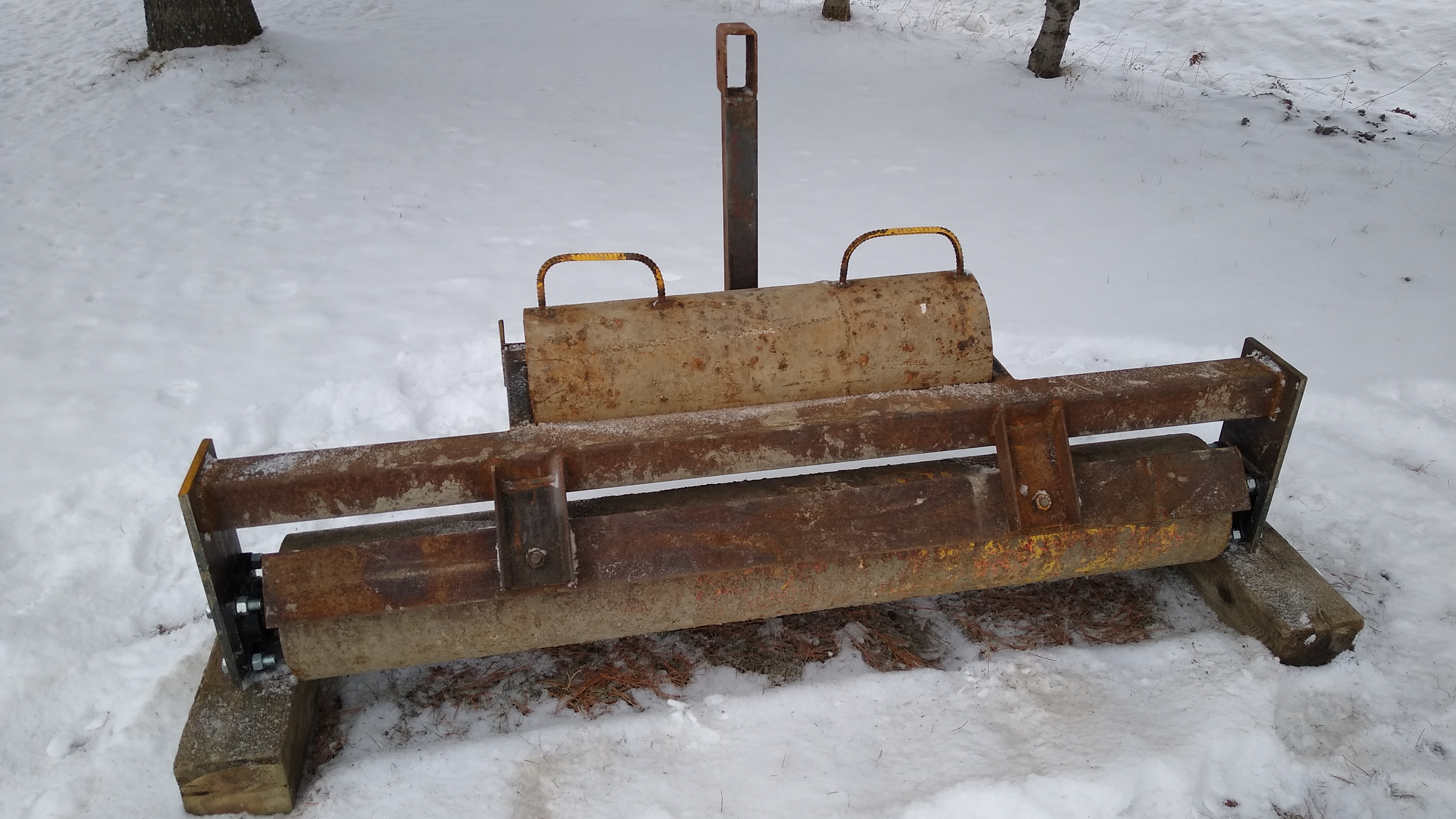

i tried it out and it rolled nice on dried soil . I am gonna use it only once after seedling grass seed over 2 acres and roll it at least twice over to get the seed well pushed down and a very good compacted soil.

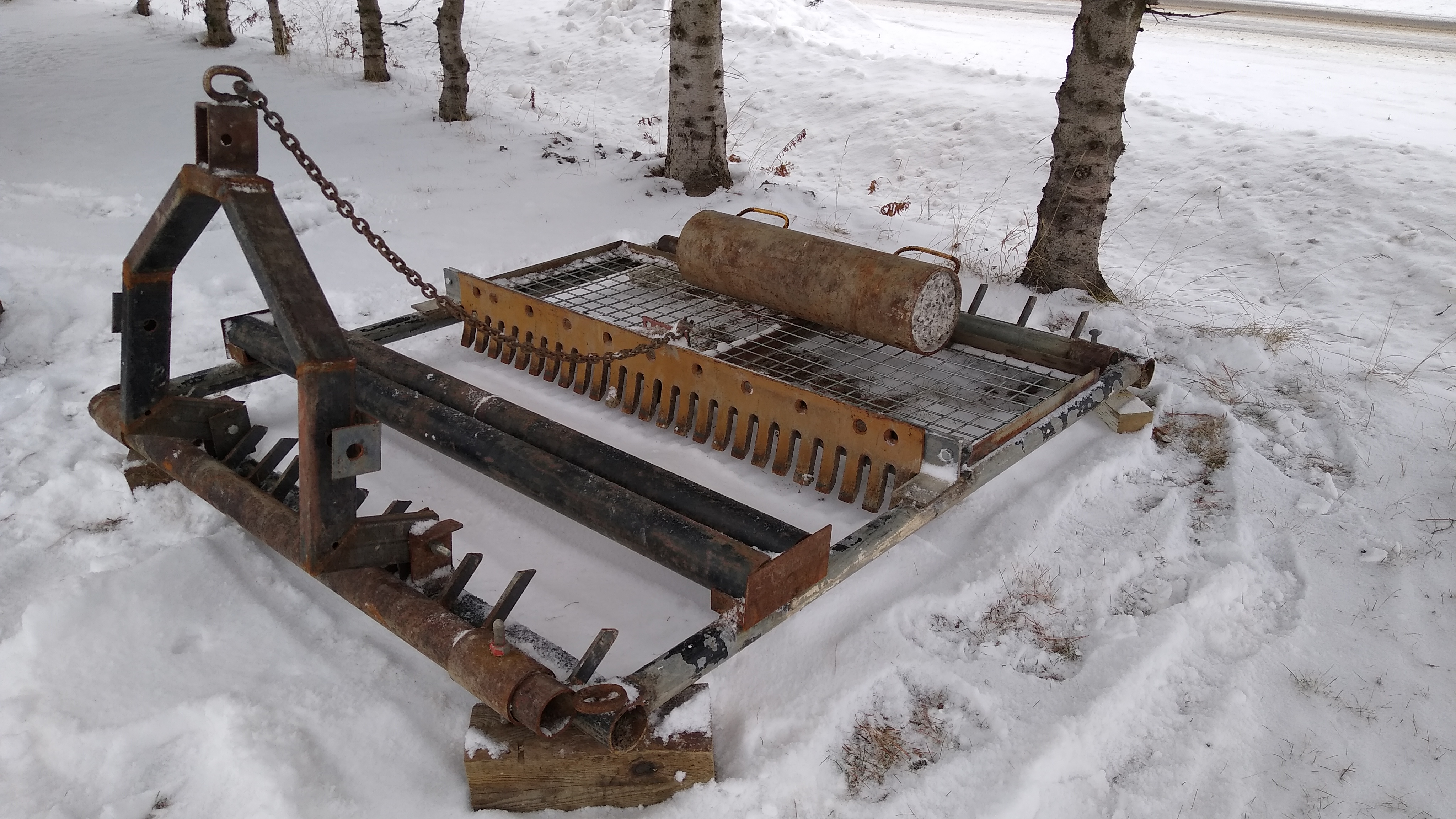

but before i will level the soil once more with my homemade 3 point or tow drag grader with spike to not only level the soil but break the small roots , pull the rock up to surface, backfilling the hole ,and break the bump. it work very good.IMG_20201210_105959803.jpgIMG_20201210_110016215.jpgIMG_20201210_110023563.jpgIMG_20201210_110046316.jpgIMG_20201122_094341557.jpgIMG_20201122_094353553.jpgIMG_20201115_090530186.jpg
