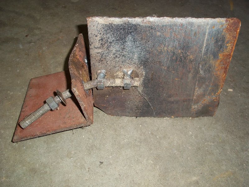

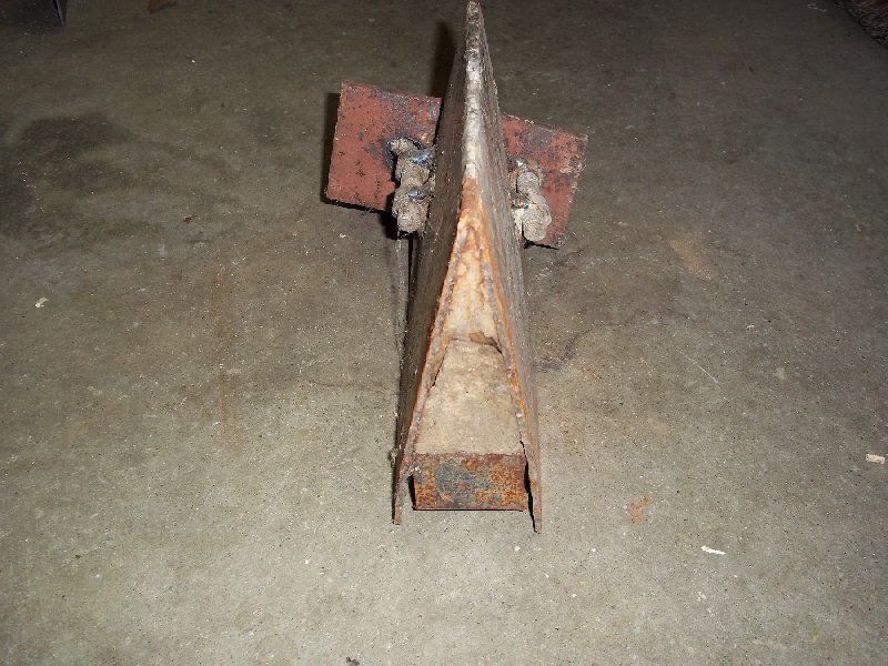

Yes I did... Buried coax with it. Worked very good.
basically I took two 8" x 6" plates of steel (1/4 plate), welded the 8" edges together to form a V with the wide end of the V about 4" apart, then welded bracing in to the open end of the V.
Then on what would be the top of the V closer to the point I welded two 3/4" nuts per side. (I did this with them on 3/4" all thread so the threads would line up).
I then took a piece of scrap 3" x 3" 1/4" angle and drilled two holes in it.
To use it you basically slide it over a tooth on the back hoe and tighten the nuts clamping the V under the bucket and the angle in the bucket.
I straddled the wire with the tractor and dragged a ditch about 100', while the wife simply put the wire in the ditch (which ended up about 5 or 6" deep) and pushed the dirt back covering it.

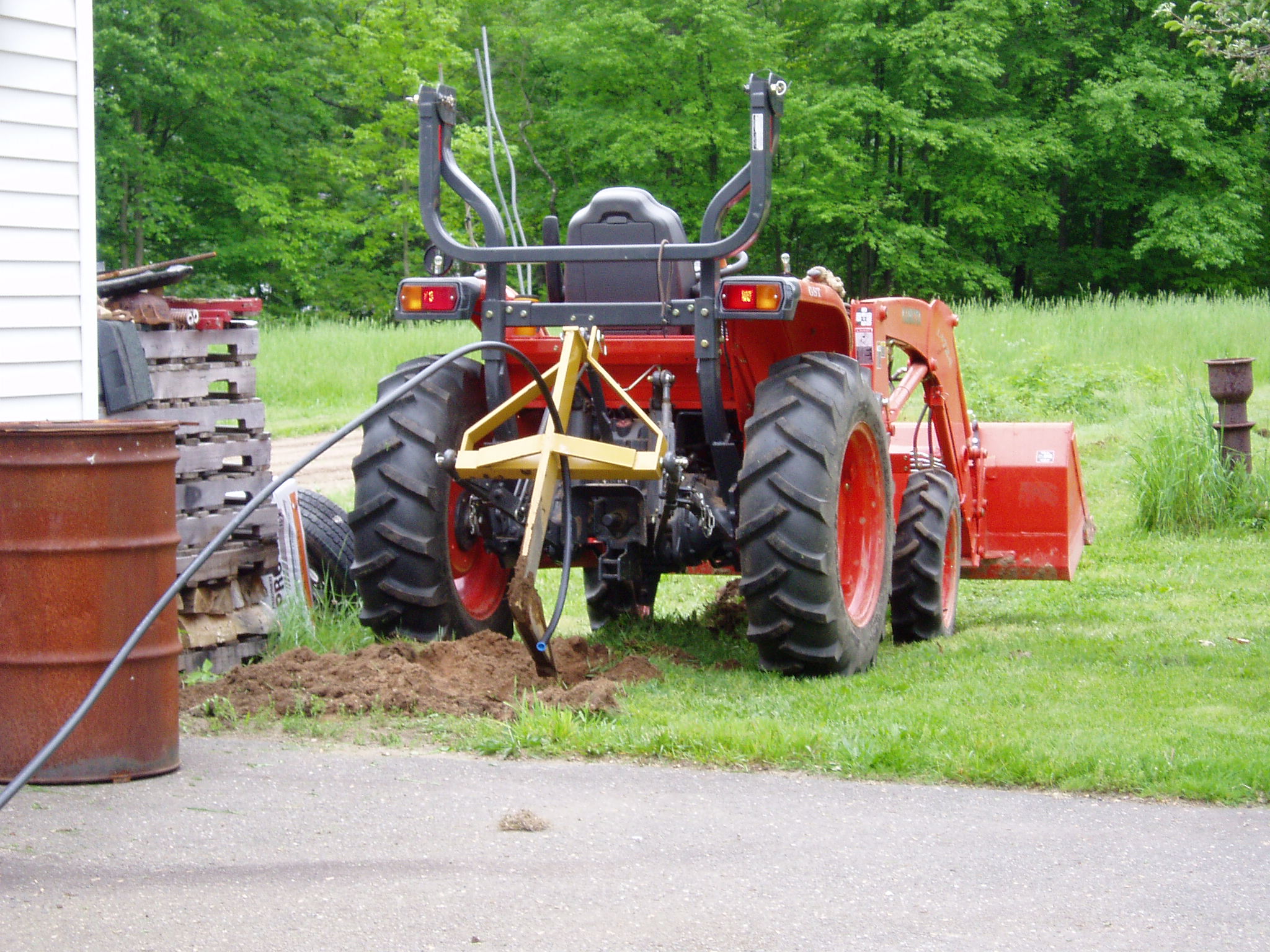

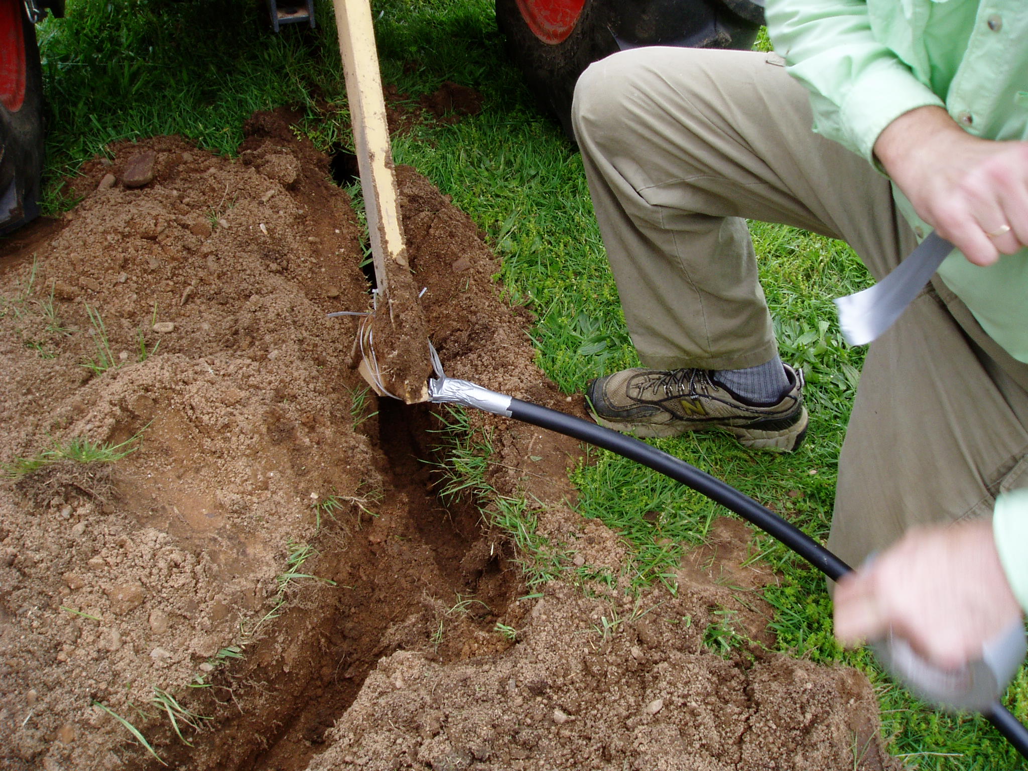

I used a subsoiler to bury some thin walled PVC hose - don't see that it would be functionally different from doing the same with cable. Warning - the following picture includes duct tape:

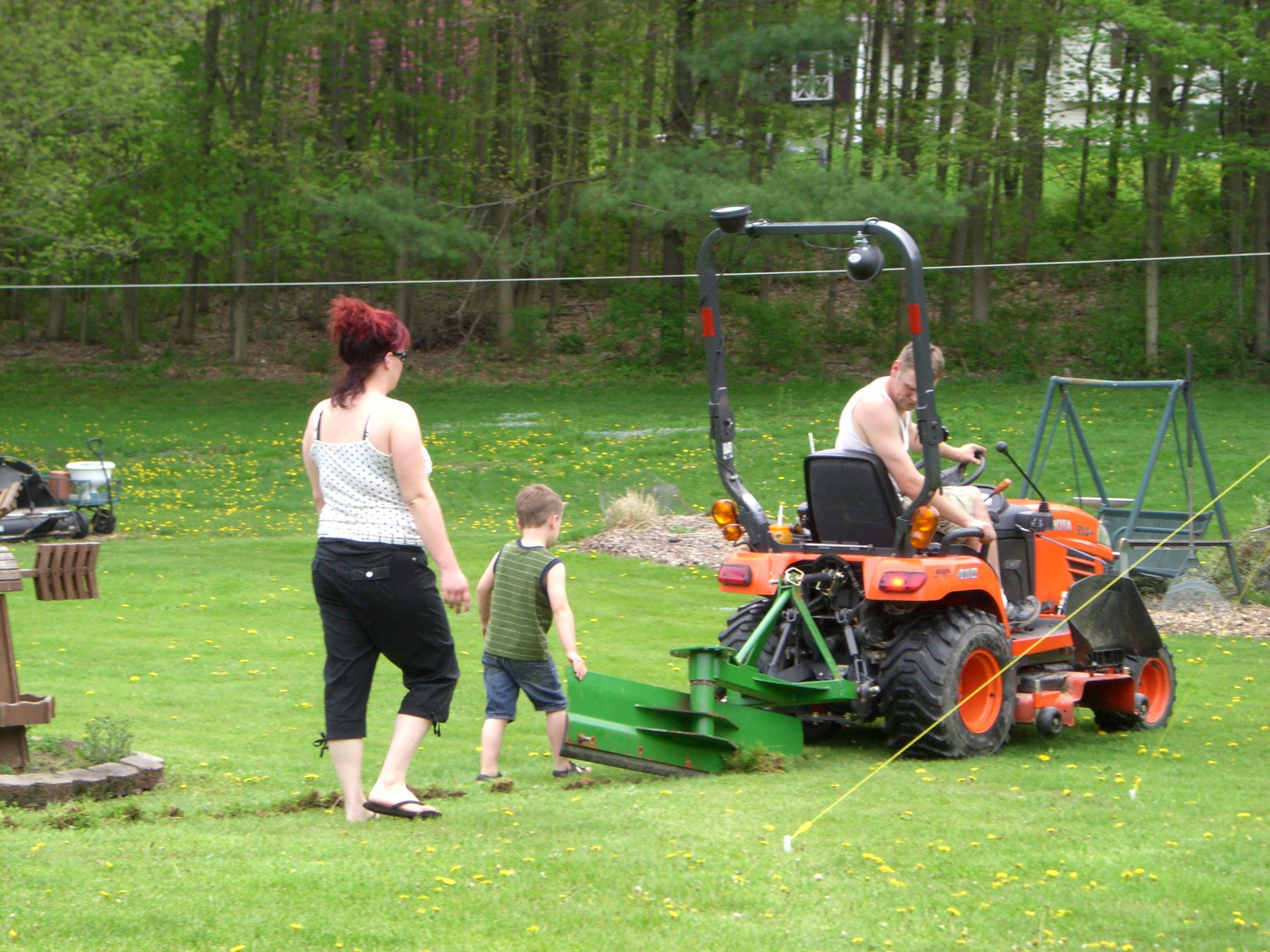

I have a single bottom plow and removed the wheel which is to set the depth. I dropped it and drove forward and it cut the most perfect 6"x6" trench I've about every seen with the removed dirt piled on one side. I did it for drainage and it did it so clean and easy that I did about 5 times as much as I needed. So, if you have a single bottom plow or can borrow one, it's something to consider. Just have to come back along and cover your ditch with the dirt piled on the one side.

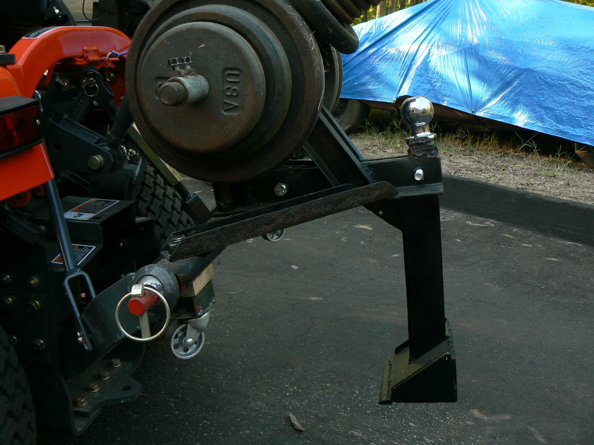

Mine looks ugly compared to the above or the ones in the link
