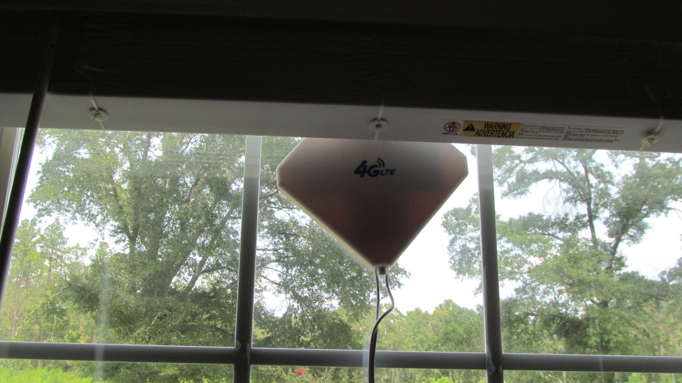

My Mobley will get 15-20 down if I get it positioned just right in a north window and tape it to the glass. The problem with this is it's in the hot sun part of the day so I have moved it inside the blinds where I get around 4 down.

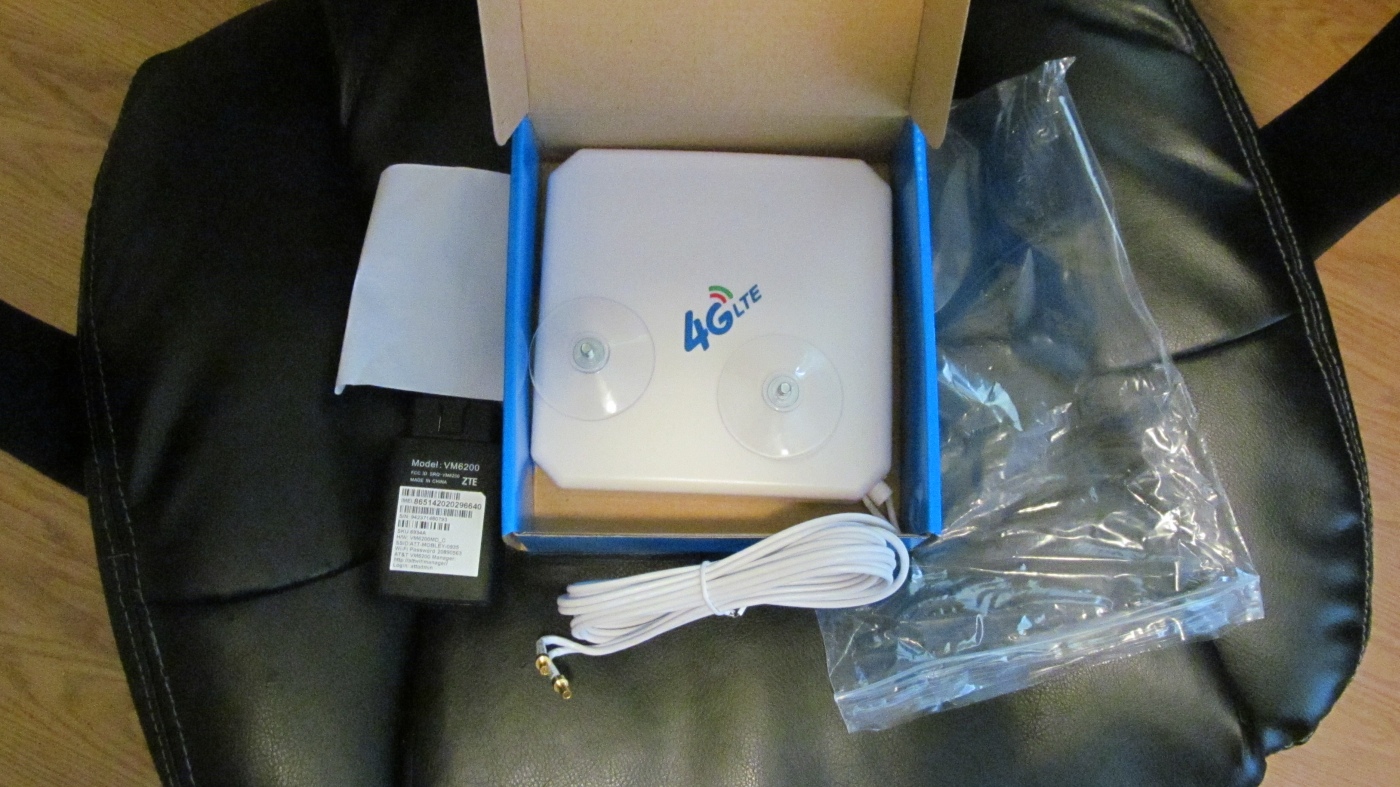

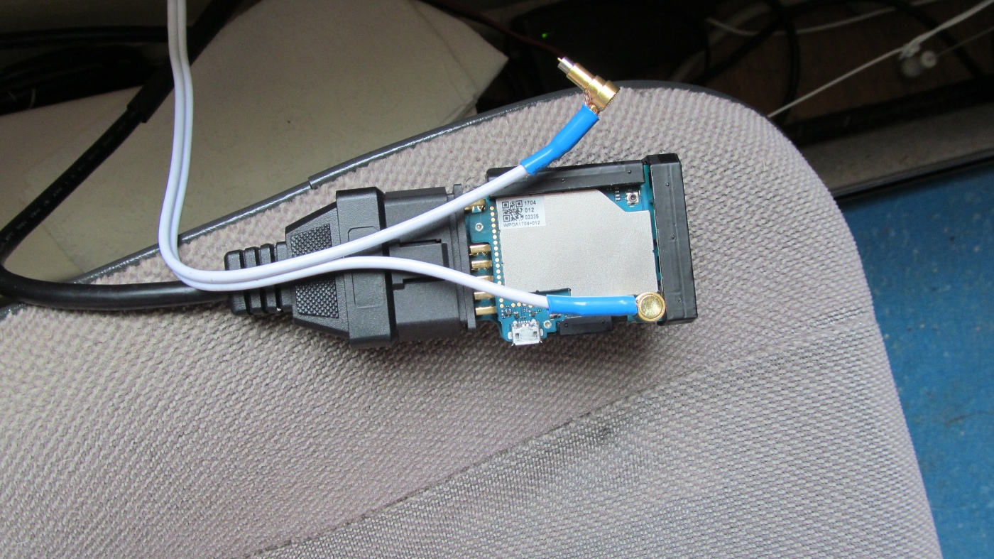

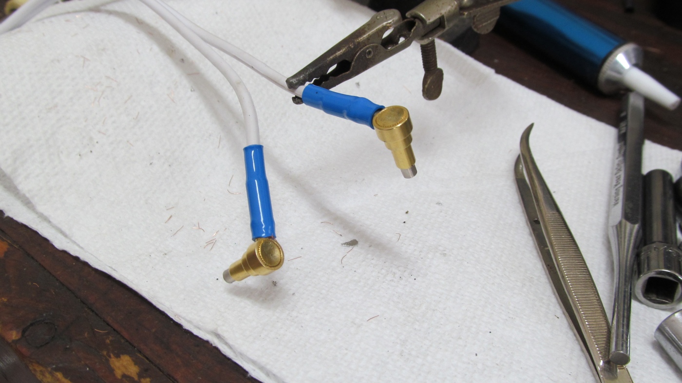

I was hoping to attach a cheap suction cup antenna and get to 10-15 and keep the Mobley inside out of the heat. I bought one that had mixed reviews but some said they had good improvements with other 4G hotspot devices. It came with TS9 connectors so I changed those out with the MS156 connectors. I gave it a go yesterday but I started the day out with a sketchy connection. I was never able to get any connection with the external antenna connected but that was also the case off and on with it in normal configuration. Some days I have to restart the device even though I have it on a timer that turns it off for a 1/2 hour in the wee hours of the morning. It could be I didn't get results because the tower was having issues which I have confirmed is my problem at times. I also didn't know which two connections to use so I stuck with the center one I had seen someone else connected to and alternately tried one of the other two and also tried just using that one. On some other type devices I have read two of the connections are the 4G LTE antennas and the other is for a GPS antenna. Not sure the Mobley has a GPS module but the connection could just be on the board. Does anyone know which two connectors are for the 4G LTE antenna? I am going to give it another go one day when the unit is behaving.
This is the unit I tried.
Here are my connectors. I checked both with an ohm meter to make sure they were connected and not bridged. This was a real challenge for my shaky old nerves. These things will also come off the board connection if you look at them wrong.

   / Cheap $20 a month Stand Alone Unlimited Rural Internet through AT&T Wireless #1,359
My Mobley finally died completely. Gets no signal form any location. All the days I had it taped to a hot window may have contributed to it's demise.
I found a used ZTE Velocity MF923 mobile hotspot device on ebay and bought that. Just plugged the Mobley sim in and it powered up and works fine. (note: sim has to go in contacts up. Didn't say in manual. It is possible to put it in upside down but reports no sim when you start it.) Time will tell if it continues to work okay. I still had to mount it in the window but I have it inside the blinds to protect it from the heat some. Sitting the window sill it barely got over 1 Mbps. Higher up where I had the Mobley it got 3 Mbps. Ironically I tried it lower down so the extension cord didn't look so bad and hit the sweet spot at 20 Mbps. Another funny observation is I was getting 1.27 up at the 3 down location but only .75 up at the 20 down location. Either way I am back in business. The Velocity is a nice looking unit with a touch screen and built in battery.
