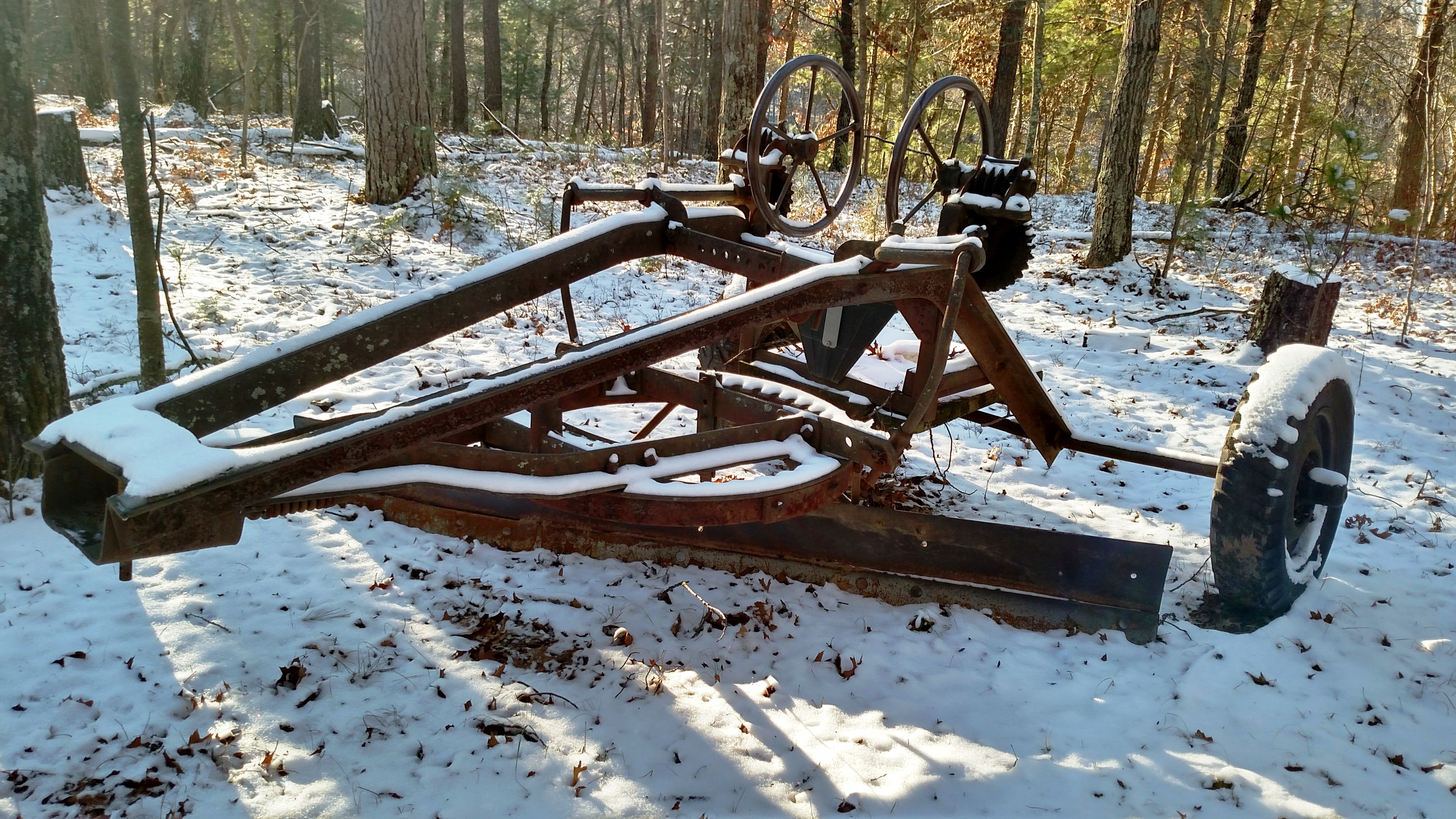

On my 1/2 mile road, every spring, I use the scarifiers on my box blade to chew up the gravel around the potholes that developed during the spring thaw.
Then I use my horse grader to restore the crown and do any contouring/ditching. The long wheelbase gets rid of any hoops and hollows. This is my most useful driveway tool.
Nice grader!
I think my next tractor purchase will be a grader, but the kind the highway departments use. I can see a lot of use with one. Kind of out of the scope of this conversation, but I also like yours as well.
