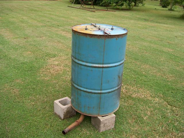

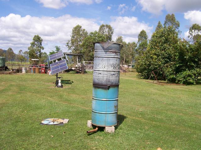

My retort is not original but I think I have simplified it a little and it works great.
Its a Tlud. ( top lit up draft )
Uses 3 concrete blocks 8" sq.
2 oil drums 44 gallon aust 55 gal usa.
1 gal reducing bush 2" to 1.1/4"
1 gal. cap 1.1/4"
2 pieces of 1" x 1/8" galv. flat mild steel.
and a bucket of clay to seal the drum from air in the extinguished stage.

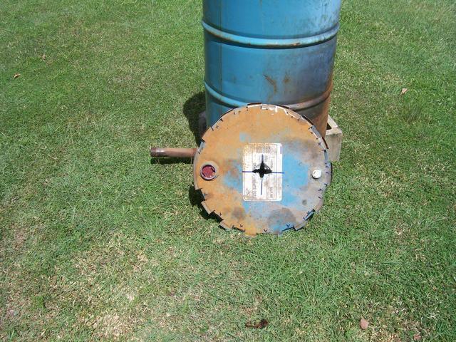

Take one end out of the drum to be used as a retort leaving the bung end intact.
Take both ends out of the other drum to be used as an afterburner.
One plain end will be used as a lid in the extinguished stage.
the other plain end has tabs cut to form legs and is used as a baffle so as
charcoal (or ash) doesn't block the bottom air vent.
To use. load the retort with wood ( small bung in , reducing bush and bend installed, no cap yet.)
Once the fire is going lay the strips of flat mild steel across the top of retort and place the second endless dum on top ( afterburner )
The air is sucked in through the gap and helps burn the gasses from the smoke.
My burn time is 3 hours then I fit the cap, push the afterburner off and seal retort with lid. I leacve it overnight and unload next day.
Regards Vince.

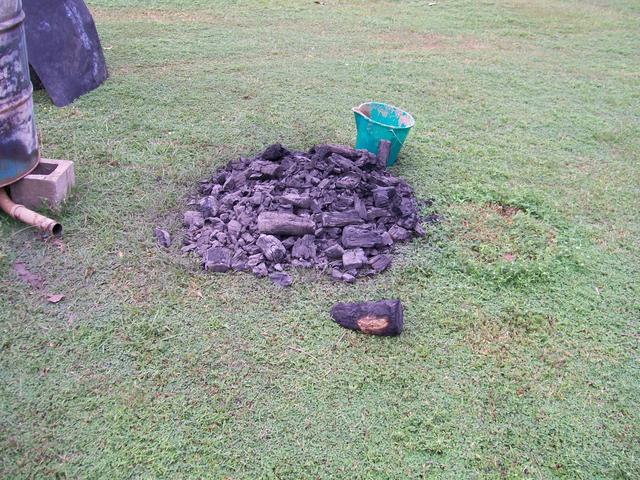

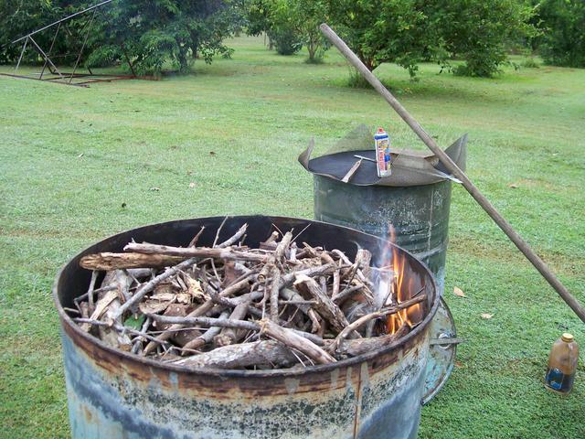

Hello Snaker and CBW1999.
Yes I'm making charcoal, Its wonderfull stuff with many many uses.
I make it for my garden but hope to sell some soon.
It is great for carbon capture used this way.
I tend to waffle a bit so best look up Terra Preta for a history and uses.
I forgot to list the 1.1/4" bend on my parts list.
A retort burns timber ( or whatever ) in an oxygen deprived state.
I will attach a few pics, of the baffle, starting the burn and my first batch.
Regards Vince.

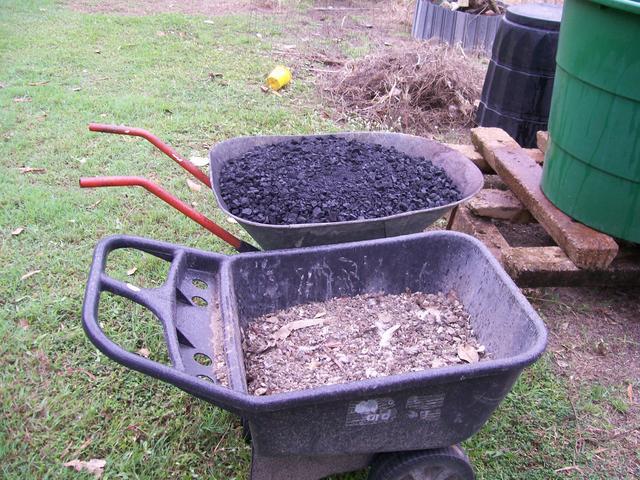

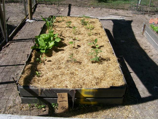

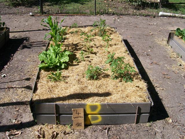

Hello all, Thanks for some interesting posts.
My post no 13 might not seem to make a lot of sense as the post I responded to dissapeared,and it sender it seems.
# tcreeley, yes as kids in the 50's Mum served up a lot of that sort of toast.
thank god we don't have to watch the toasters anymore.
# pickstock, I think the arguments to use it in gardens etc are compelling enough even for those that are not convinced about global warming.
(me included) I did some trials with home made bio char and chook poo and was happy with the results.
Regards Vince Smith.
P.S. bed B has bio char, bed e is the control.
