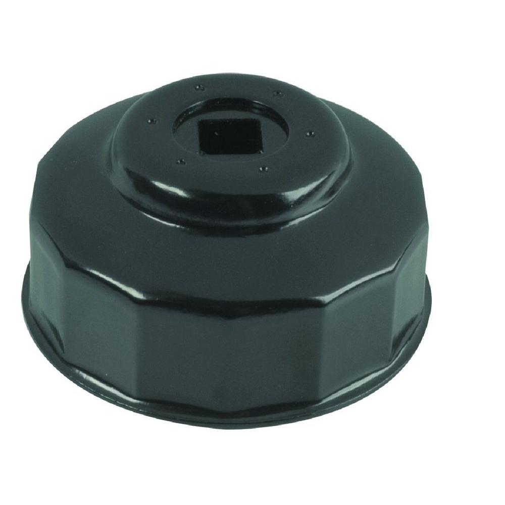

I've had good luck with something like this for my BX24, GR2120, and generator oil filters. Not sure what it's called. Cap wrench, maybe?
Z.

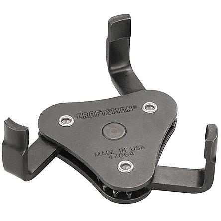

   / Changing the oil filter on my BX2360 #6
I now use this on all our vehicles. Works great in tight quarters.
