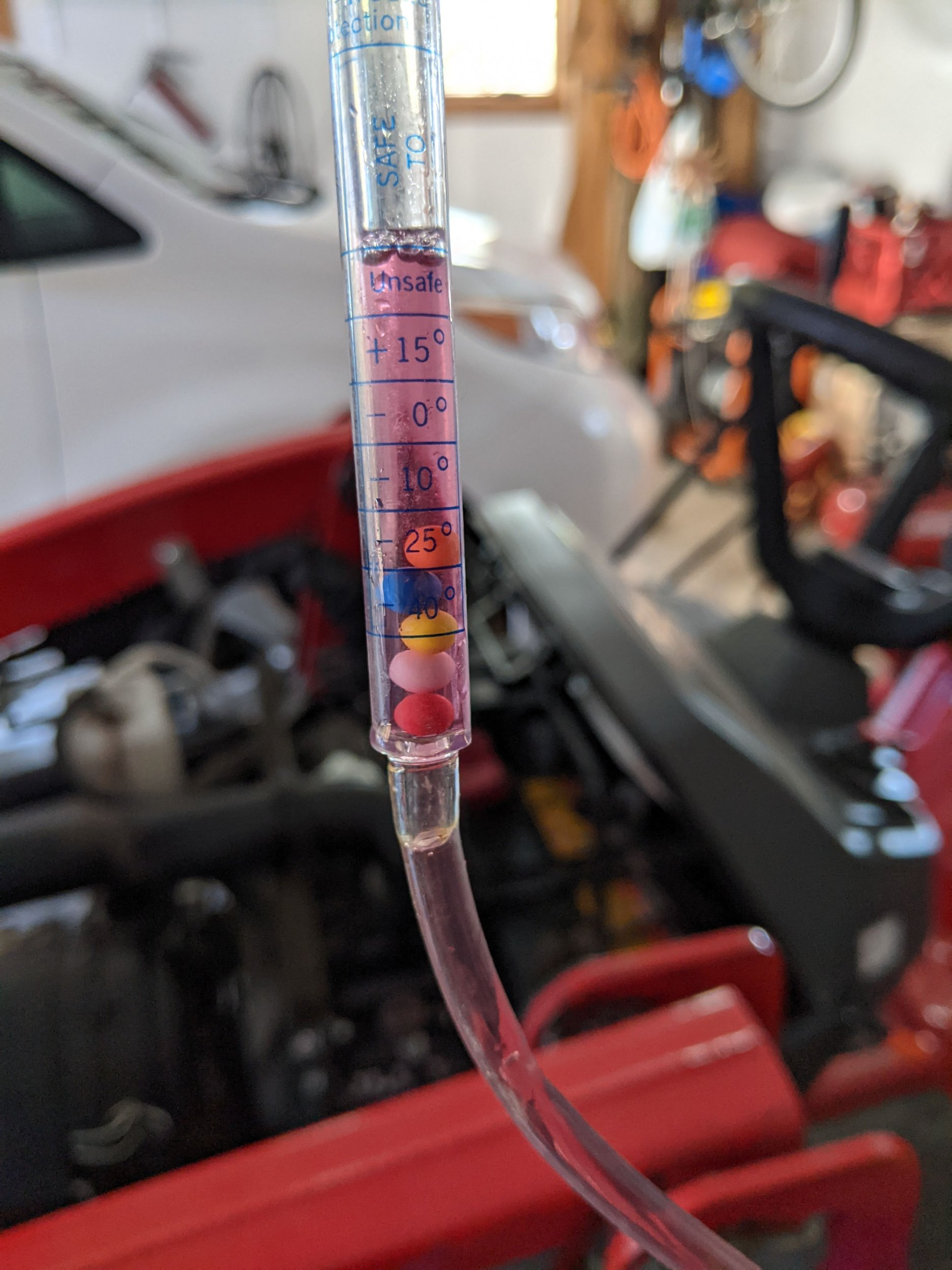

So, found something interesting today. I changed coolant last year on my GC1710, used this stuff:
I had no intention of changing coolant this year, not as though the tractor is a daily driver or anything. Anyways, today I stumbled on my el cheapo coolant tester, so since it's in my hand, why not. Tested the coolant and found this:
I thought maybe there's a problem with the tester, so tested some of this same coolant leftover in the container, and got 3 balls floating from that (safe to -10 deg). So yeh, this is surprising, and looks like I'm changing coolant this year after all.

Those are some interesting instructions, not much better than the floating pointer ones.
Were 2 balls floating or 4? would be my question based on those instructions.
If it were me, I'd either just replace the fluid with new or buy a magnetic heater pad if a block heater cant be added. Not sure the second one is any more trust worthy than the first, but you have a refractometer coming that measures the sugars, and as long as it is stored the right direction or you remember about the bubble, it will work well; and you can calibrate it!
