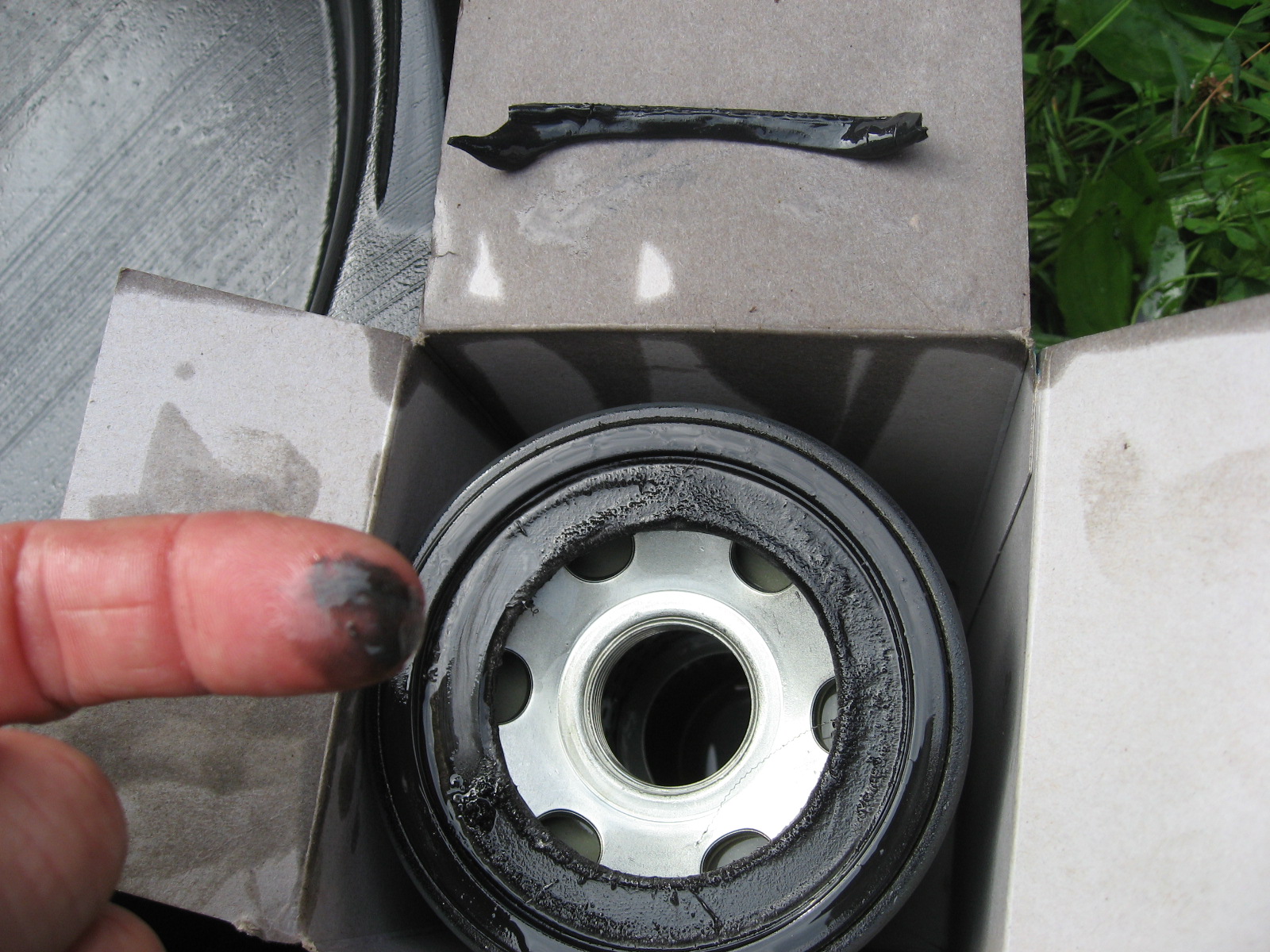

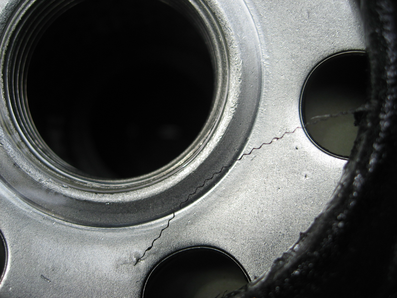

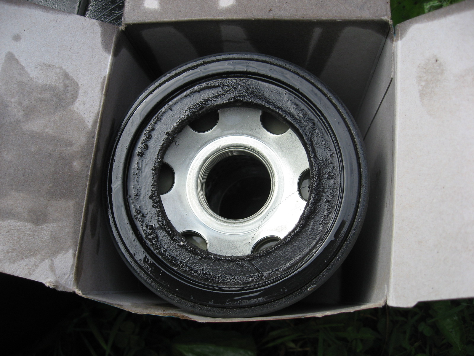

Oil and filter change at 50 hrs, then every 500 hrs. There is no time interval specified. I think I've given up listening to everyone else and their conventional wisdom and just due what the book says. As far as the tranny filters at 50 hrs, I have first hand knowledge of the interesting debris you find in there.
Hydraulic oil filter change at 50 hours on my old MX5100 DT. Yes, that piece of gasket rubber was in there too.
