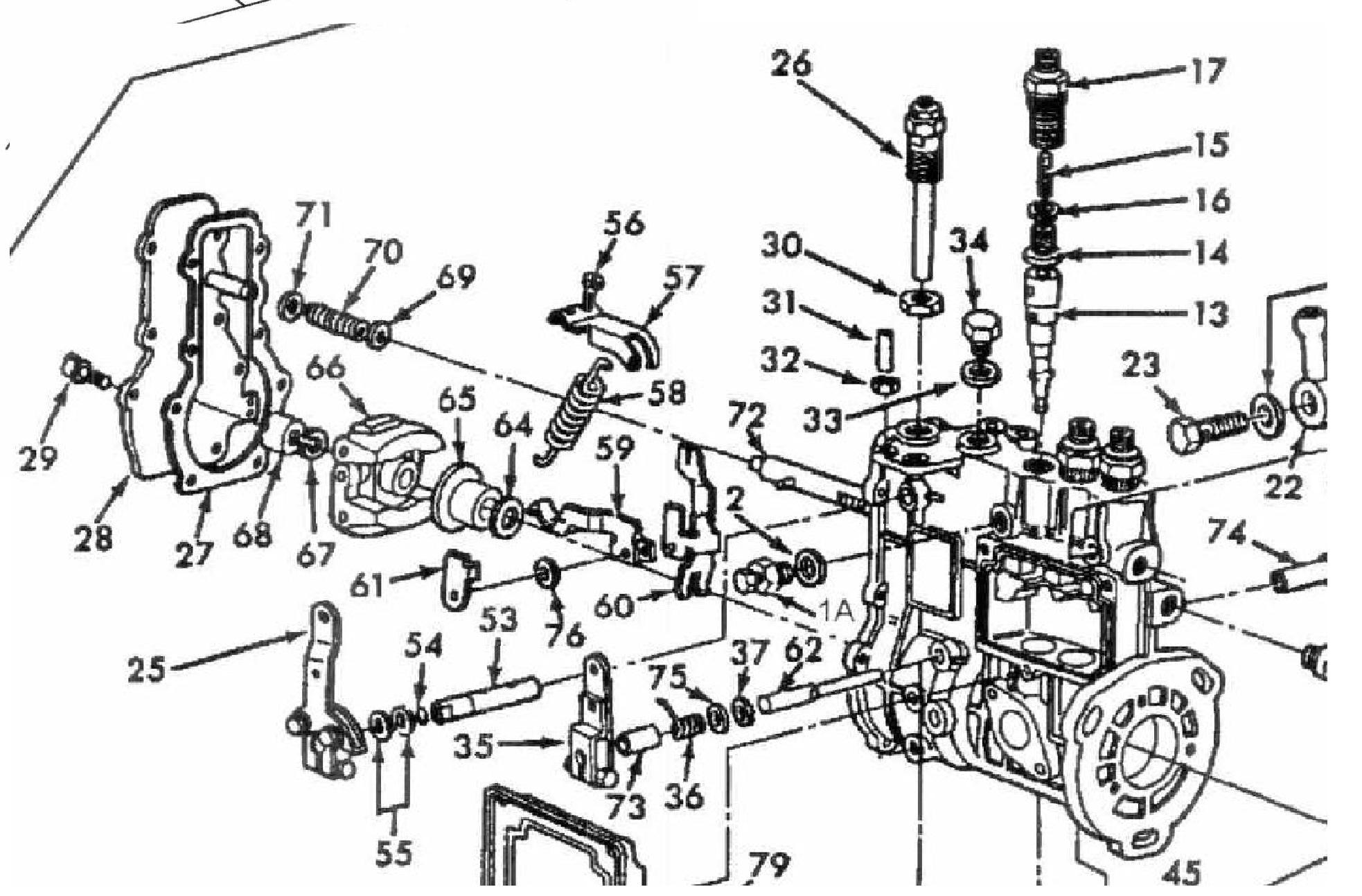

The same thing happened to me after I drained the oil from the injector pump. I figured that I had air in the line so I tried bleeding by the book for a few days but no dice.
Solution for me: Removed engine oil filter. Removed cover / plate on injector pump. Made sure that the "spring" (sits on a guide rod) was lined up with the (rack) aka item #72 in parts diagram. Replaced oil filter and added oil back to injector pump.
She scared me when she fired up because I had it set on "rabbit" mode for bleeding purposes.
It doesn't even look like there is much to hold that spring in position except for the guide rod so it would be very easy to put it back wrong.
It is a very weak and flimsy spring. Hard to believe that it makes that much difference but it did.
P.S.: I don't remember if your 1700 oil filter is in the same place as my 1710 but if it is then it is a whole lot easier to remove the cover plate if you take off the oil filter. I did not drain the engine oil first. The only oil that came out was from inside the filter.

JC, I am brand new to this forum. I just bought a ford 1700 (really like it). I have read many of your helpful post. I am having the same problem as Pclausen was having with the injector pump oil change and now it only will idle. I followed the train of "how to fix". Unfortunately this did not fix mine. I was looking to see if you had any other suggestions. I know this is an old posting and don't even know if you are still an active member, I thought I would give it a shot. The only thing I have not done is take one of the lines off that runs from the injector pump to the actual engine head (the metal tubings - 2 of them). I got one off but not the other one yet, could there be an "air bubble" in there that is causing the problem. Thank you in advance for any advice.

AJ you don't need to remove the lines, just loosen the nut at the injector to bleed air. Do you have a drain or did you remove the back cover? Did you check the spring on the pump cover for correct install? Did you have gravity fuel flow?
   / Changed fuel injection pump oil and now Ford 1700 will only idle #32
No drain on mine, I had to remove the back cover. I made sure the spring is seated properly. I do have good fuel flow. I loosened the two nuts on the injectors on top of the fuel pump and have fuel flow through them. I have not taken one of the two off that are on top of the cylinder head to bleed it (don't know if it is needed). I thought I would take these two lines off (the metal, smaller lines) and blow them out--------I'm hoping there is trash in one and that's my problem. thank you for the quick response. I am trying to get smarter:). any other suggestions are welcome. I'm just frustrated because it was running fine before I changes the oil and fuel pump oil (could the oil change make a difference-----I would not think, but ?

In think by draining the oil from back cover you might have moved the spring or caused something for the governor assembly not to work properly. I'd make sure governor is not binding in any form. That's what regulate flow of fuel and Engine speed at any given throttle position.

I'll look at the governor tonight/thur. and see if that's the problem. I am pretty sure I aligned the spring correctly on the pin that moves inside the pump when the throttle is activated. I think I have tried just about everything else. thank you!

Don't despair, It is eiither governor or you still have some air bubble in the injection line. Injection pump is a reciprocating positive displacement pump. the pump try to compress small amount of Liq (not compressible) thru the discharge line. if there is air bubble there it'll keep pulsating git back and forth without or very little fuel delivery. By the way did you adjust the throttle any? does it move freely all the way back and forth? what happens when you push the throttle high while the tractor is idling?

I personally want to thank you both for helping me and giving suggestion. I took the "injectors" out (not pistons - you all are smart, I am not Ha/ha). I cleaned out all the gummed up diesel on the female threads on the head, got my injectors back in. I drained the fuel pump, again. I made sure the weights were working properly (they may have been hung up not sure, moved pretty good from what I could tell). Replaced my plate and this time I only added 1oz. of oil (I know this is not the recommended 2oz, but I wanted the see if I maybe was adding too much).
Last night I went back in the archives and read about 5 pages of conflicting theories of too much too little oil in the pump and too much making the engine not get up in the rpms. I fired her up and she like she was when I got her. I will probably go back and add a little more to the pump as I don't want to buy a new one (I have seen the prices quoted, ouch).
