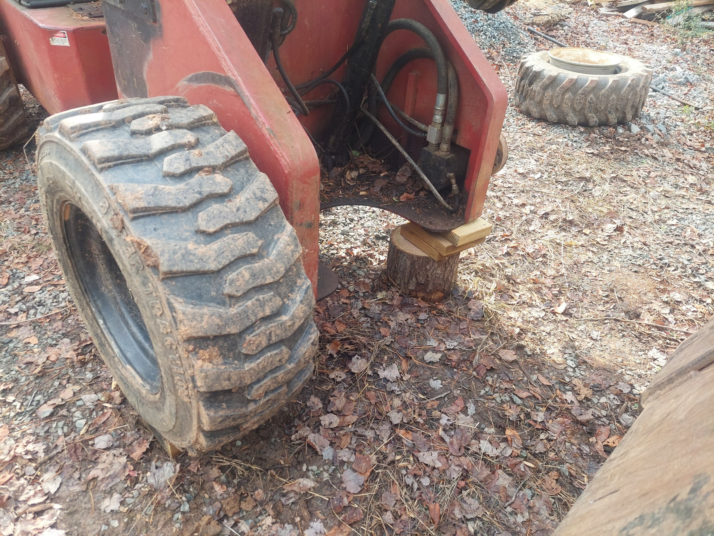

Well I did it to myself.
Forgot to air up this tire (which has a slow leak) and went out to clear some brush for the burn pile. Tire popped off the rim bead due to no pressure.
I am wondering if I can get the rim/tire off the tractor by just removing the 6 outer bolts or if I need to get that large center bolt with cotter pin off also?
Tractor is far away from any tools now and I dont have anything big enough to get that large center bolt off with?
Luckily the tractor has a built in lift (the loader itself) and I can get the tire off the ground where it is.
So, is this going to go the easy way or the hard way?

No, the lug bolts only should release the rim. I believe large nut in the center with the cotter pin is a castle nut that holds the hub with studs onto the wheel motor shaft, but I could be mistaken.
/ Change tire PT1460 #3
I think Mossroad is correct - just unscrew the lugnuts and the rim/tire should come right off.
/ Change tire PT1460 #4
Ditto on the castellated nut, don't mess with it.
Some tire guys would rather leave the rim bolted to the machine and just use your tire spoons to slip it back on, that way it doesn't slide away when you are prying. But to each is own. Good luck, sometimes small tires are more difficult then large ones.

Appreciate the assist everyone.
Going out today to deal with it.
Thank goodness I don't need to deal with the center nut.

All is well.
Thnks for the support as fit of the rim over the center hub is actually very tight and I couldn't tell if the rim was behind the center hub or just very close to it.
PB blaster, a mallet and a pry bar and was able to get the rim off. Local tire guy seated the bead and aired it up for 10 bucks.
Back in action within an hour.
