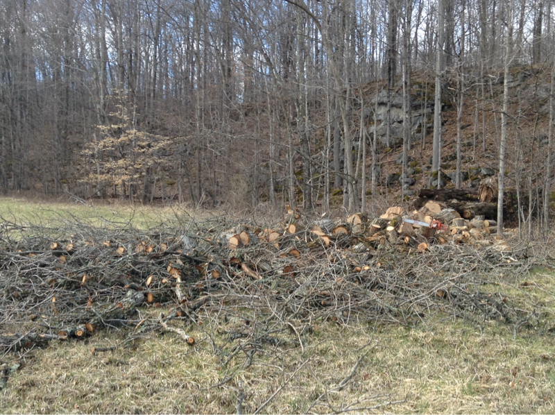

What's the biggest bar that I can (should) put on a 57cc saw (for just a few cuts on one big tree)?
I've ran a firewood saws for about 20+ years and have had no problem running a Husky 55 (53cc) with a 16" bar. My other "big" (not really, but bigger) saw is a Husky 257 (57 cc, 3.6hp (2.7kW)) with a 16" (but maybe a 18") bar.
97% of my use is limbing/firewood, so I don't mind those rare occasions when I have a few cuts on the rare big trunk where you might have to hit it from two sides to get through it with a 16" bar. For me I'd rather run a lighter saw all day when you don't really need that big saw horsepower for 95% of the cuts.
I say this because despite all the suggestions I'll get to go spend $800+ on a professional grade saw that weighs 1/2 ton, I don't want one!
A pretty big tree (elm?) fell over in the field, and from the way it sets, I'm thinking I want a (temporary) bigger/biggest bar on the 57cc to make those ~1/2 dozen cuts on the trunk.
Husky says the biggest you should put on the 57cc (and 53cc no matter what size chain pitch?) is 20". In reality, could I go bigger (24") and just baby it? I really want "reach", not horsepower and speed.
Anybody have any insight, experience or suggestions?
(Other than buy a bigger saw :rolleyes:)

Since the tree is chopped but the discussion continues:
One of the reasons for a limited bar length on that size saw is the oiling capability. Often times the oil pump is a limiting factor, not just the power of the saw. Some of the bigger saws, like my 395, have an adjustable oil flow that allow for the use of a variety of bar lengths while getting proper lubrication. That being said, I've used a 42" bar on my 372, and it turned it and cut ok. The 395 is better for both power and lubrication, but for one time use- I think you'd be just fine running a 24" bar on your saw. Skip chain might be nice but I doubt it's required, and it can be tougher to obtain.

:thumbsup: I put a 28" (gulp) and a standard spaced toothed chain (skip tooth wasn't immediately available, (I'm not the most patient guy when I want to get things done). Even with that setup, the 57cc saw worked fine. ( Yes I know, a new $800-$900 saw for these dozen cuts would of worked better!)
Good point about the oiler, which I should of investigated more beforehand. I could tell the chain was running too dry for my taste. So on that first day, I just stopped very often to feel the bar and make sure it wasn't overheating, and (lightly) rev it a few times under no load to get some oil on it and repeat. If I'd had the manual on me or more experience I would of seen how easy it is to adjust the oil flow with the only tool I had on me (The chainsaw "skrench" tool?)
I started on the top end of the tree and spent one afternoon just cutting the tops with my 18" saw. Some of those branches were under a lot of pressure, but thinking ahead and using wedges did the job. Only got the saw pinched once (stupid mistake, aren't they all), but the wedges easily got her out, and I used them religiously afterwards. I only had one "Oh-sh*t! Run!!" moment, which wasn't really that bad when she popped and snapped and the trunk dropped about 2 feet.
The reason I started on the top end of the tree was because I figured that the root ball would keep it from rolling (on me!) when I was cutting off the limbs keeping it suspended in the air. That seemed to work well.
Glad to read you "got er' done" and kept your chain wet. Now you can justify getting a good 90 or 120CC saw FOR NEXT TIME.

What we did was to cut off the root ball first. Then skid the tree at a pivot. This maneuver tended to lessen the availability of "sprung" branches and to have the tree supported by the ground for stability. In your case, I would have cut off the root ball about 6-10' up from it. For a 30 inched I would have used 3 wedges and have made a straight downward cut with the wedges jammed in the top cut and have made an undercut first. I've seen more times than I can remember when guys used the undercut to finish, the saw had a better chance of getting crushed. This now gives you the opportunity to section the stem and skid them out of the way with your JD. The key to tree tops is to lessen as much tension as possible by taking the weight of the stem away. I would then drag the crown to a landing and cut er up.
I also have a 257 and it can run ok with a 20" bar for limbing. It gets a bit anemic when sectioning stems with the bar buried. It can be done but I seem not to be able to lose the concept of "production mode" from when I was logging.
At least you have something (bar) to tackle bigger stuff on the rare occasion it presents itself without having to spend big money. If you needed to justify the expense: bigger saws running longer bars are great for stumping if you are so inclined.
