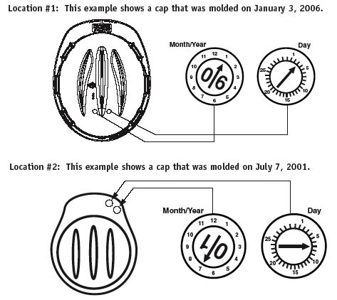

Are the newer plastic helmets brittle after a few years? I have a Stihl forestry helmet that is probably 5 or 6 years old and still feels strong. My son grabbed an old plastic hard hat out of the barn and it literally fell apart in his hand. I know all my motorcycle helmets came with a note in the box stating they should be replaced every 5 yrs or so. I know the sun degrades most plastics, but the sun doesn't shine here on the Oregon coast:confused3:....Dan.
Construction plastic hard hats have a manufacture date molded in them and I would hope forestry helmets would as well. General rule of thumb on Constrution hard hats is 2 to 5 years. Why they cannot just stamp the date in simple MM/DD/YEAR I do not know. Here is the key.
