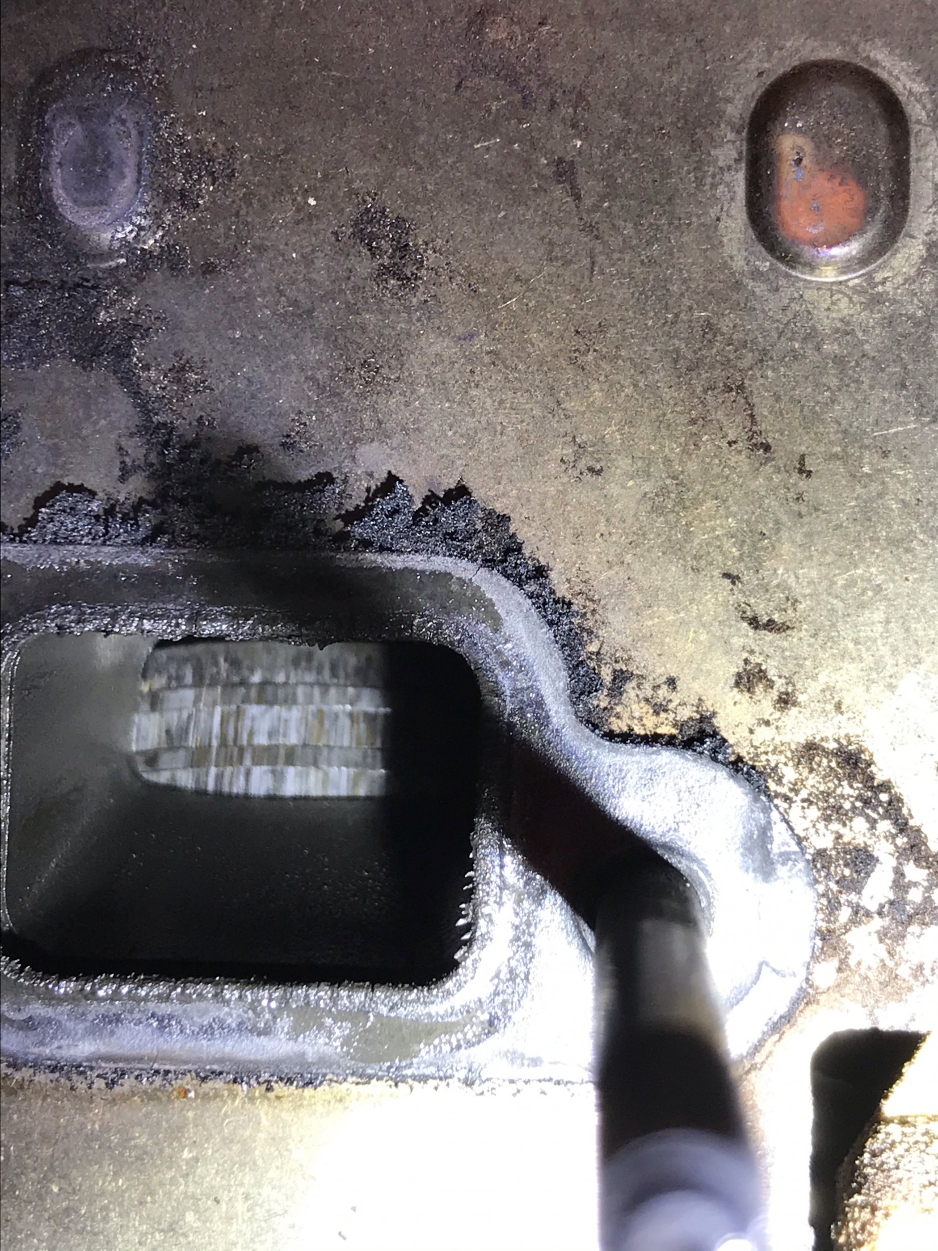

Check the spark plug first, make sure it hasn't started to come out. I’ve attached a pic of a MS250 that had piston damage. As bad as it was, it still had decent compression and ran but idled badly. This looking in the exhaust port.
I have had the problem dodge man has taken a picture of. I used fuel that had ethanol and used old fuel mix. I too was cutting a stump that caused the saw to get hot. It sputtered a bit before it died. When I looked in the valve I could see and feel bits of metal. Now I used only !00% gas and synthetic mix.
