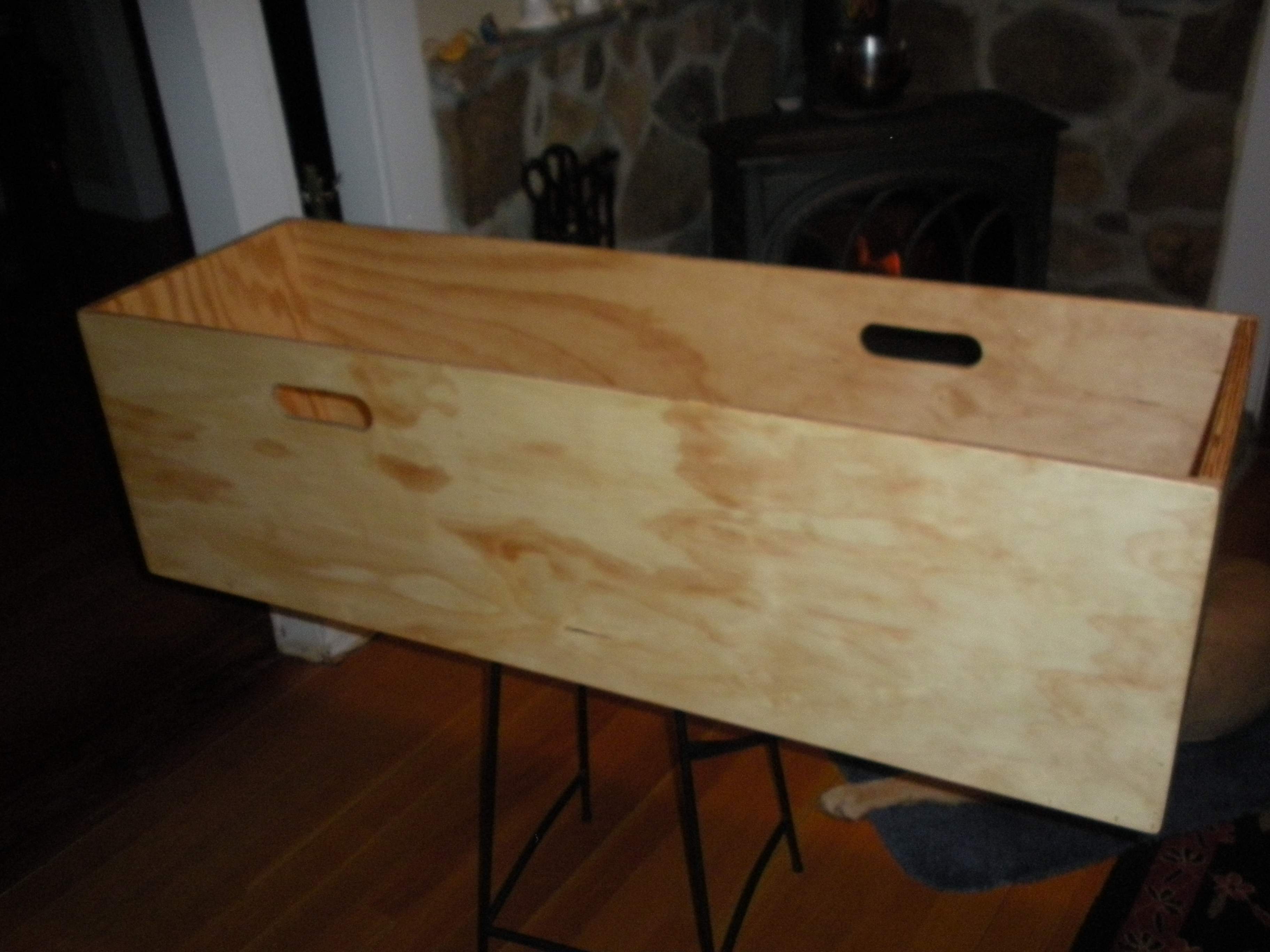

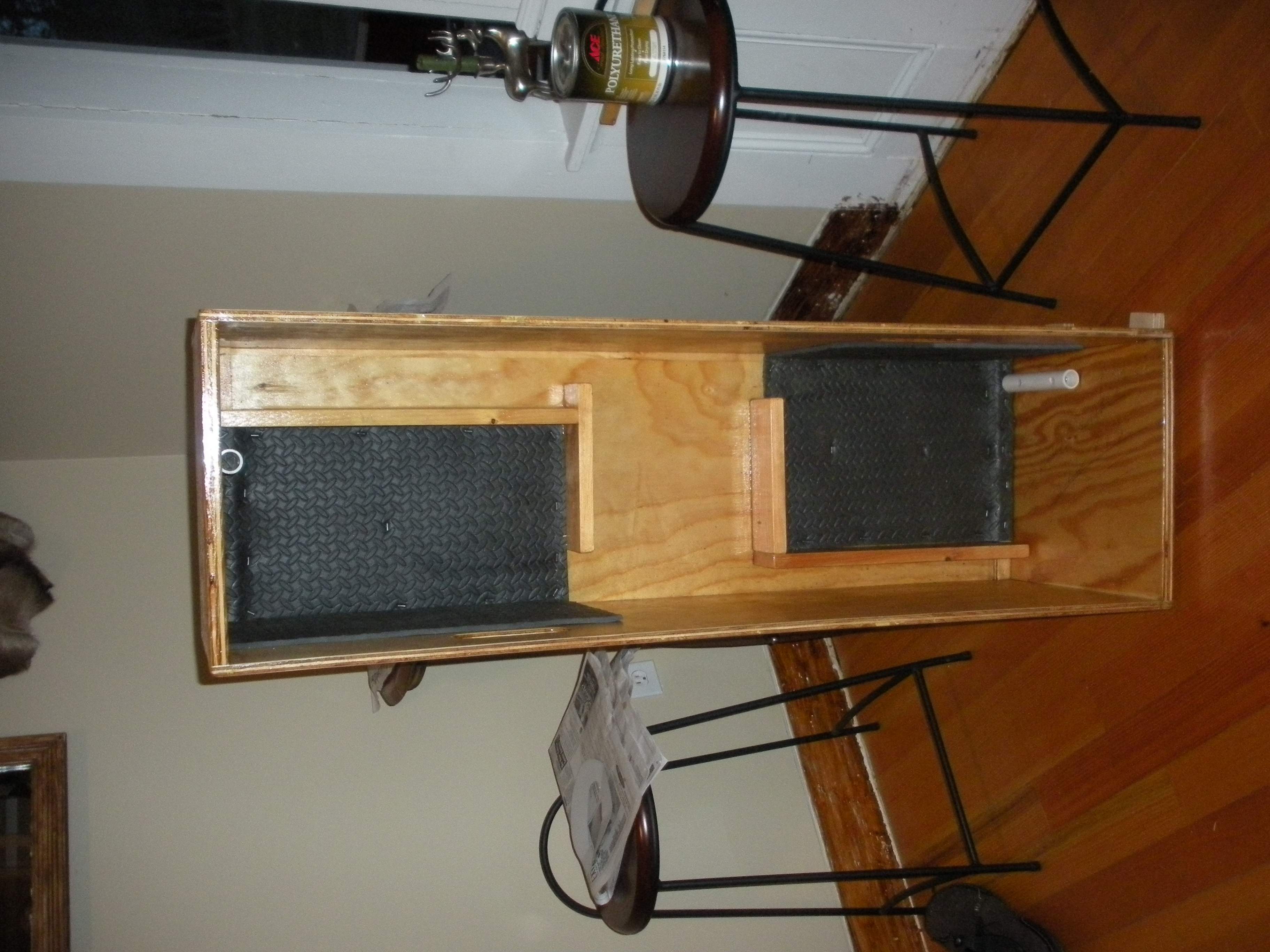

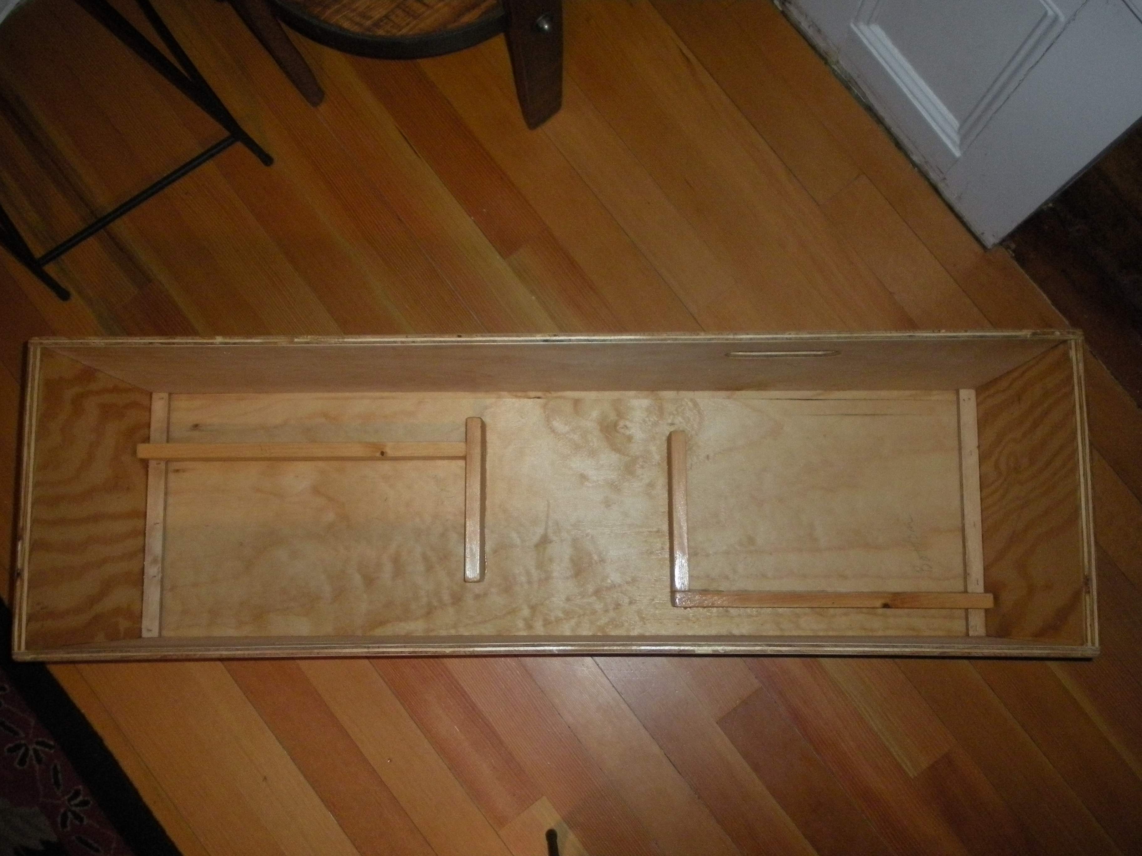

................ Pictures will coming soon! It ended up being 44" long, 13" high, and 13" wide, with 1/2 plywood on the bottom and sides and 3/4 plywood on the ends. It holds a Husky Rancher, 18" bar, and a Stihl with a 14" bar, a one gallon gas can, one gallon of oil, two screnches, a file, and spare chains. Finally, everything for cutting wood all together, in one place, all the time.

I am almost ready to add three coats of exterior glossy poly. That should take care of the oil leak issue, as my Husky Ranch definately leaks oil. Plus, I am putting in some thin closed cell foam padding under the saws to protect them a little if the box get bounced around in in the bucket on my tractor.

I actually do have two handles, one on each long side. It carries just fine. I only have to load it into the bed of my pickup, into my tractor bucket/wood trailer, or into my workshop, so I'm not planning on ever having to carry it very far (at least I hope I don't ever have to).
Poly coat one is done! Two more to go, then the pics.

Pics of new case as promised. I used it today, works great, keep everything organized.
