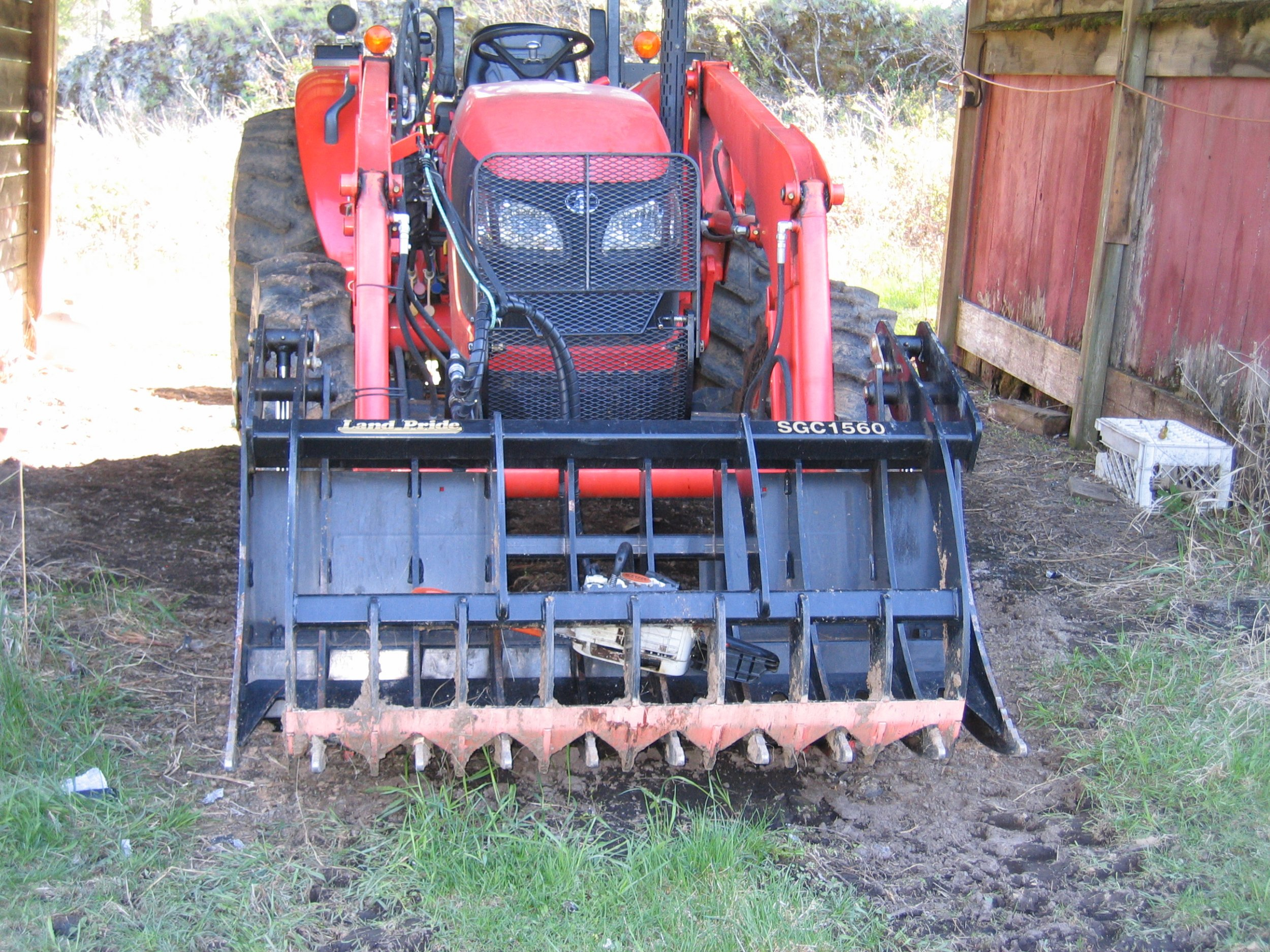

I live on five acres of Sierra Nevada foothills, with a couple hundred oak trees and a few pines. My grapple is fantastic for handling downed trees. I used to carry a saw on the tractor, but found it less handy than I expected. I always end up with either a pickup with a trailer or a Rhino on site when felling trees, and the less I hang on the tractor, the better. I never, ever (yet) work alone when felling trees, so my partner drives the second vehicle. Fell, limb, cut, and stack in the trailer.
